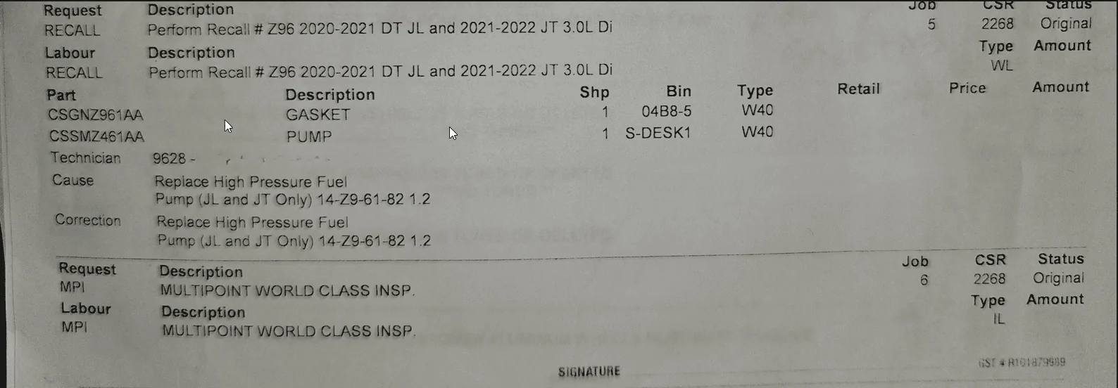

@redgladiator86 What were all the part numbers were on your work order?
I only had the following for my NON-contaminated replacement done up in Canada,
  1. CSGNZ961AA-HP Fuel pump
  2. CSSMZ461AA-HP Fuel pump campaign kit
    • 1 EGR tube (gasket)
    • Rubber Gasket - Upper EGR Tube
Jeep Gladiator CP4 Fuel Pump EcoDiesel Recall 2024-111
From what I can see I am missing the following compared to the US safety Reference: 01A / NHTSA 23V-263 recall document:
  1. CSGNZ965AA - HPFP Campaign Kit
    • 1 Tube - Fuel Feed to Pump (pump to right rail)
    • 1 Tube - Fuel feed to pump (Pump to Left Rail)
    • 1 Tube - Fuel Injector Supply
  2. CSFP01A1AA - Owners Manual Addendum, tip card, fuel door decal
  3. 4275086AE -Authorized Modification Label
I'm wondering if there are differences for Canadian vs US recall repairs since I am in Canada. Anyone else out there with a Canadian gladiator had the recall done that can confirm what the parts were on their work order?
