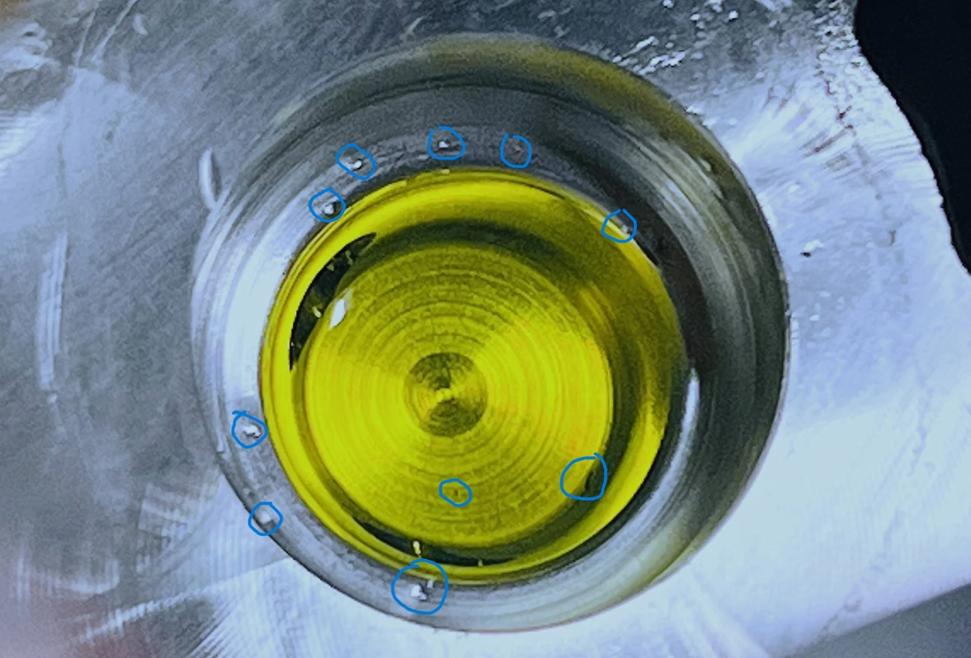

Well Friday did not turn out how I expected. I had previously spoken with the service manager at my local dealership. I sent him pics of the metal in the CP4 when I removed the metering valve on top. He said they had a new HPFP in stock and they will replace it under warranty. Finding metal in the filter and now in the CP4 was not good.

3:30pm. The service manager called me and said that the technician did not find enough metal to warrant replacing the pump. The engine runs fine and is not showing any fault codes. I asked if he personally looked, he said no that he was busy in meetings all day. He said there was nothing the dealership could do until the Jeep throws codes or stops running. I told him I was coming to pick up my truck. I printed off a photo of the metal I found when removing the metering valve and to give it to the tech that did not find enough metal! And explained that I used a magnet to collect all the metal I could from inside the pump. The trip to the dealership was 11 miles so I guess it did not grind enough for them.
3:40pm. The person that took my jeep in said it was ready and the technician said there was nothing wrong with my CP4. But since I already purchased, from Mopar Parts, and had the new HPFP on the back seat of my Gladiator, they could install it for me for $480.
I asked if it could still be done today? He said "Sorry, but we don't have time and we can schedule you in for an appointment after the beginning of the year".
So I have decided to just drive the Jeep until it fails and they have to replace the entire HPF system. I cannot believe that Chrysler has this mindset. Any metal in the fuel system is BAD.

I personally would want to it fail. You already had metal in your system causing accelerated wear/damage to injectors. Having them replace the pump before catastrophic failure isn't going to fix that. Best case is your injectors go out and they pick up the tab, worst case they make it just past warranty and you are on the hook. I would now be worried about the latter.

Yes on the pump, not your injectors. If he replaces the pump and then later has a recall done without ever having an actual pump failure it doesn't negate the fact his injectors already ate some metal. If he has injector problems after 100K miles he's going to have a tough time getting them to cover that under warranty. They only replace the injectors and fuel lines once the pump goes kaboom.
