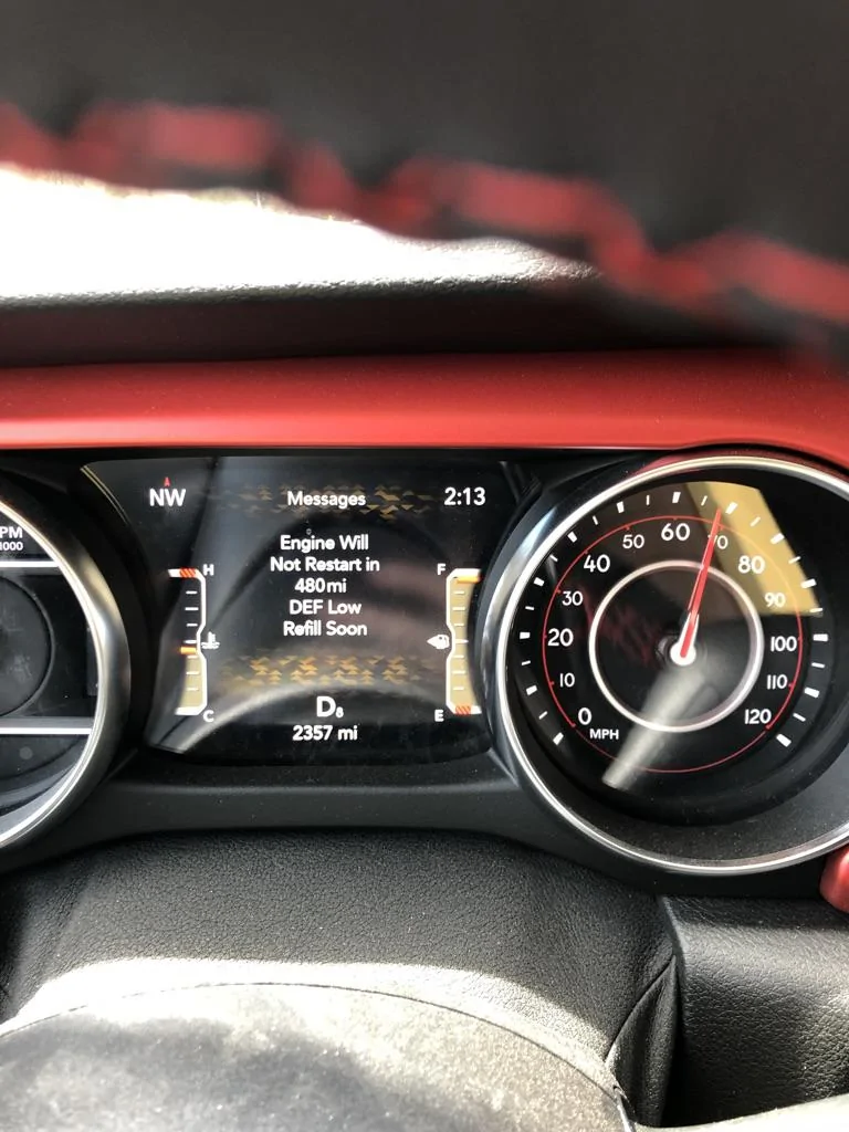

Hello my Rubicon Diesel has 2,800 miles on it and at 2,357 on the odometer i get the message that in 500 miles the engine will not start. I clicked ok while driving and 10 seconds later while I scrolled to the saved message screen, not even a mile down the road, it was already at 480 left.

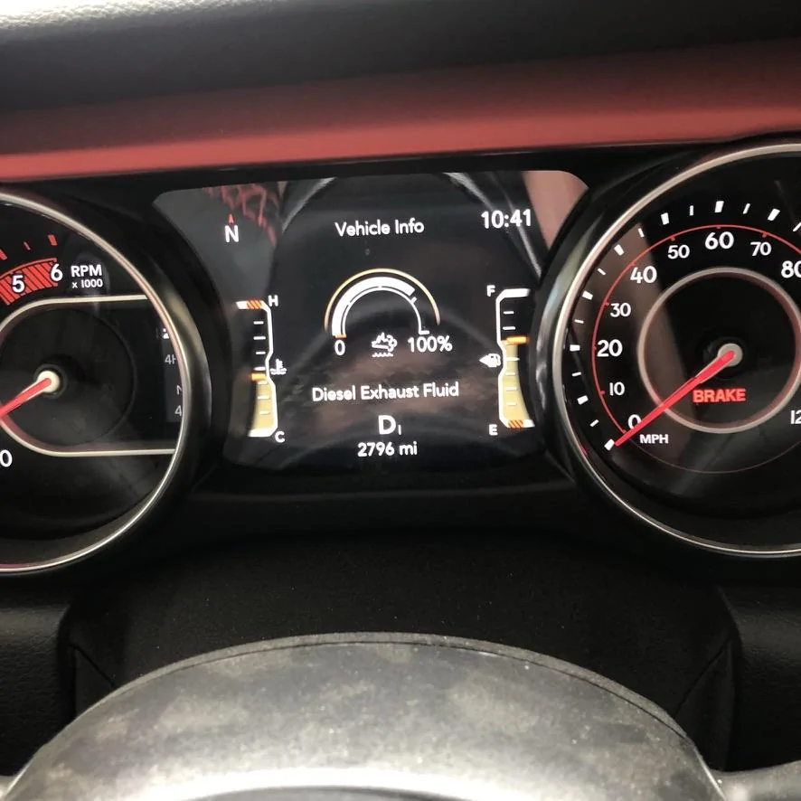

Added 2.5 gal of DEF the following, ODM was at 2,796 nd was telling me i could drive 100 miles (which in my case really would not be 100 miles).
I added 2.5 gal, DEF tank capacity is 5.1 gal, so this means there was still around 1/4 tank left/1.25 gal... Which should be a lot more than 100 miles! Maybe there is something wrong with the level sensor??

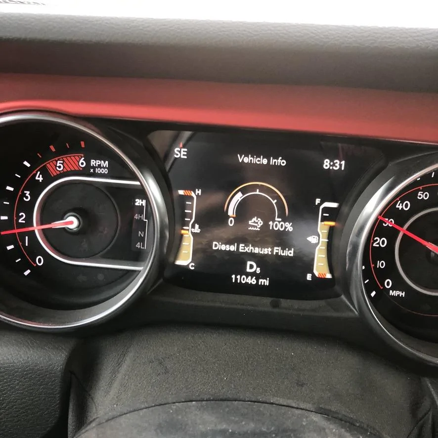

11,046 miles in the OD now, filed the DEF tank ALL the way at 8,018 miles, so at best this tank would lasted me 3,500 miles based on the warning... We will see.

My light came on on certain inclines, the would go away.
Now its on was saying 380 miles left, drover over the weekend like 120 miles and it was saying i could still drive 310 miles... All while the gauge shows over 1/4 of a tank left (1/4th of a tank should last 2,500 miles)
Did your gauge reset on its own? Mine DEF tank is Full Full, a little spilled out after putting in 2 bottles. The gauge still says 1/4 full. I thought maybe after a few start cycles the computer would recognize the tank was full and reset to 100%

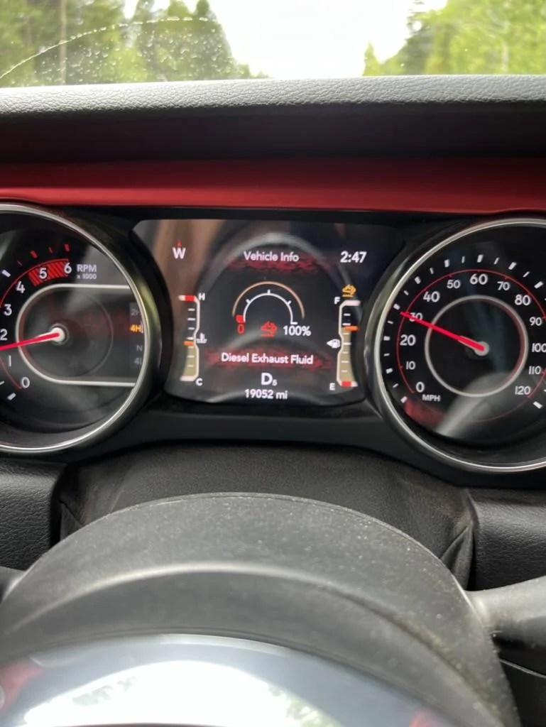

May 02 2022 i had the Y81/DEF recall done.... also timed it so my DEF tank was basically empty at the service. Filled it up and now 3,500 miles later, Def tank is empty again... so Y81 did nothing for DEF consumption....
For every 1,000 miles. I'm using about 1.25 gallons.
