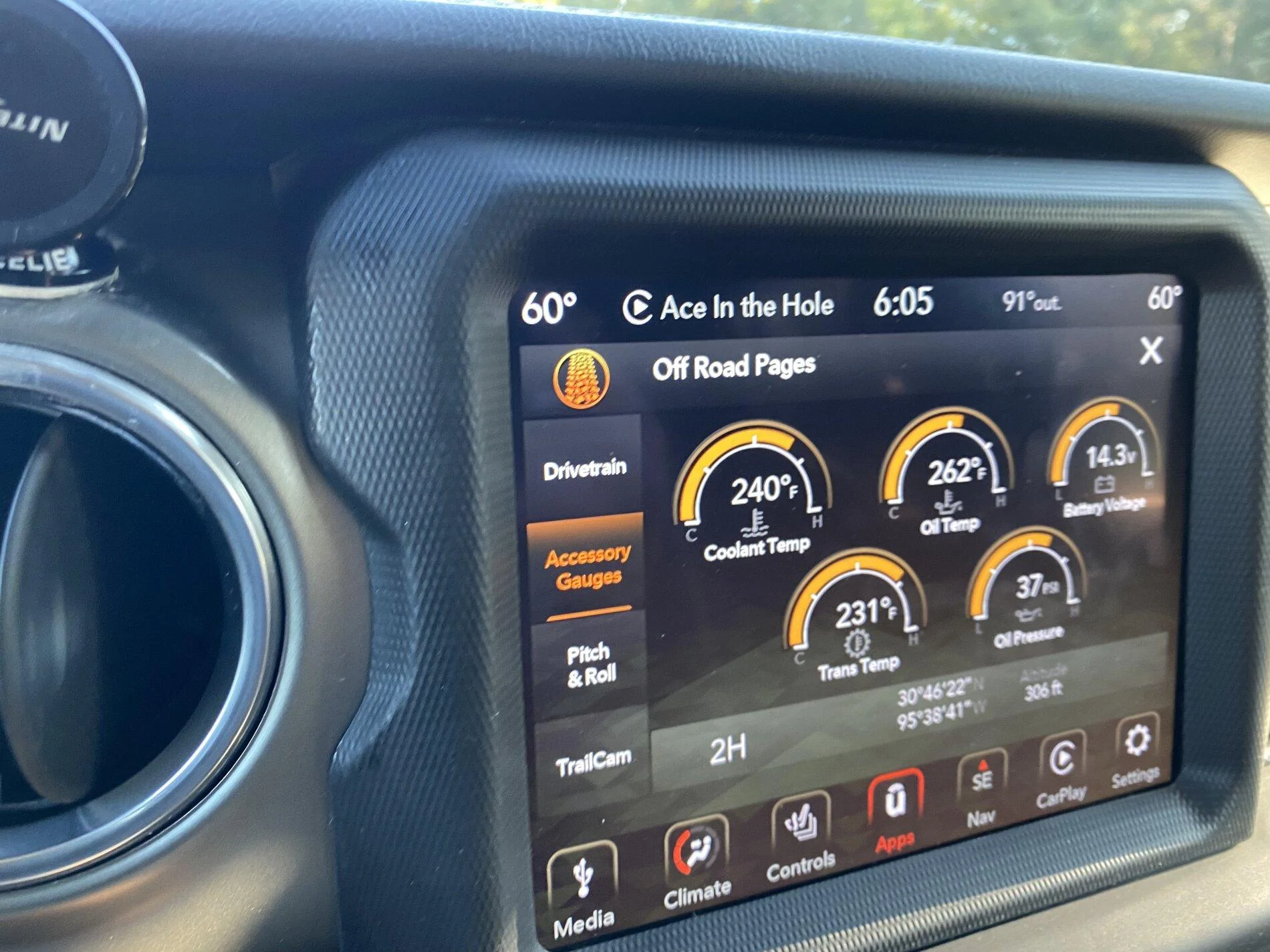

Did I miss the post on insane diesel??? What are they doing? Here’s mine on a test run pulling travel trailer. Have tazer and the fan was on. Didn’t help much if any. I have a local shop working on some type of fix.

Turning the fan on early (before you get hot) does help, but the engine heat will still eventually overpower the cooling system. It just gives you a little more time until you derate.
I started the fan at 230 oil temp. Didn’t really help on mine. I’d say it prolongs it by a few miles.
