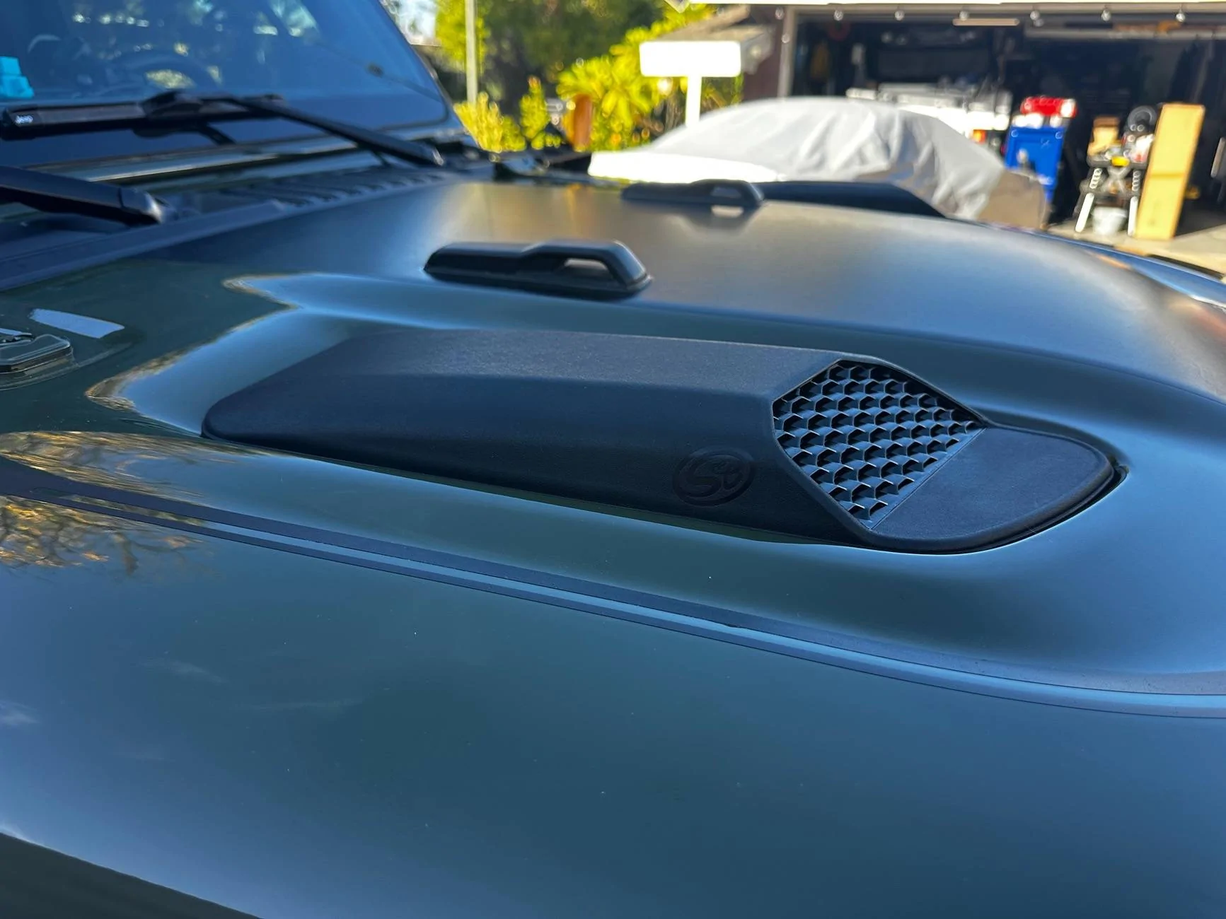

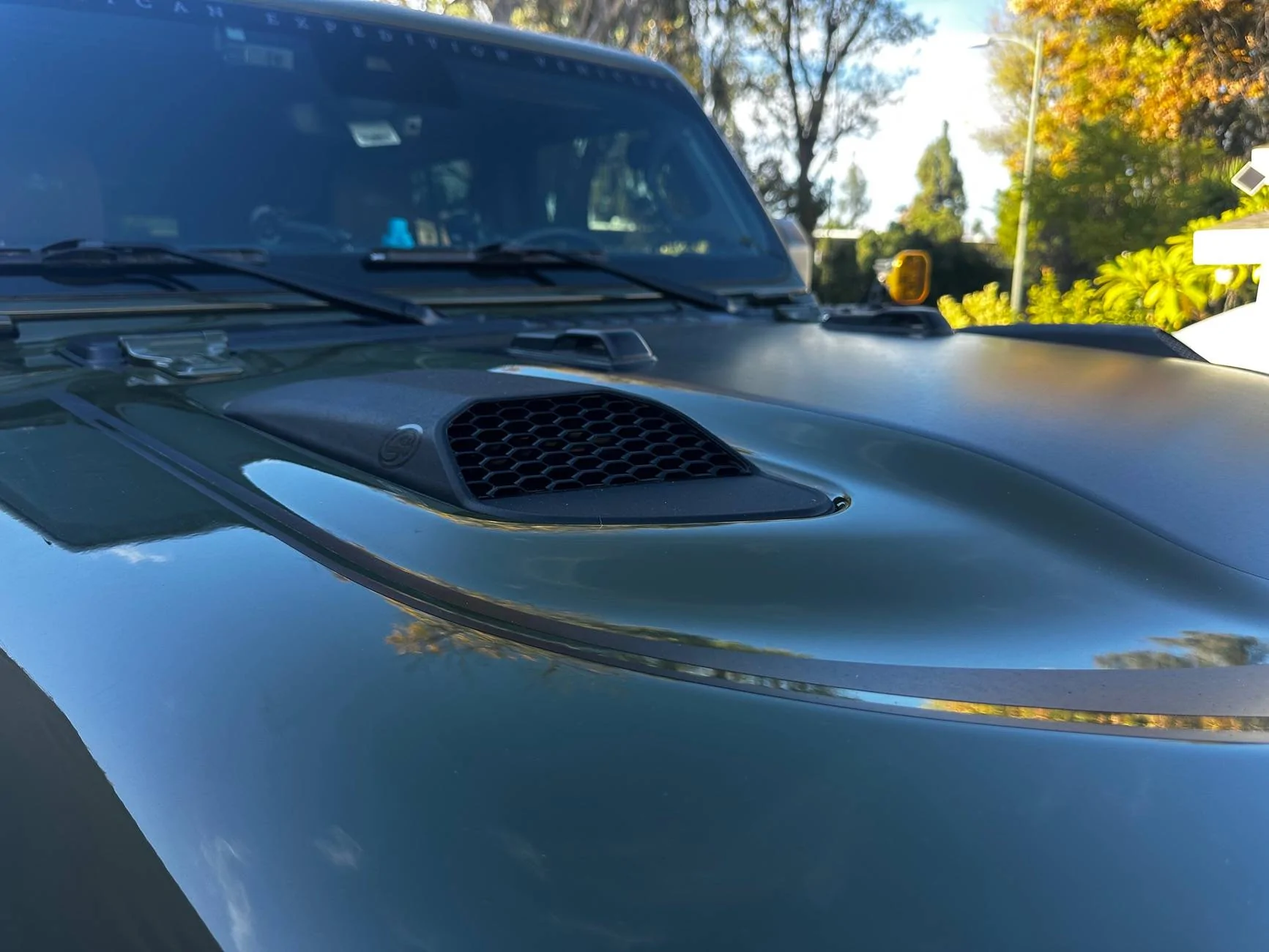

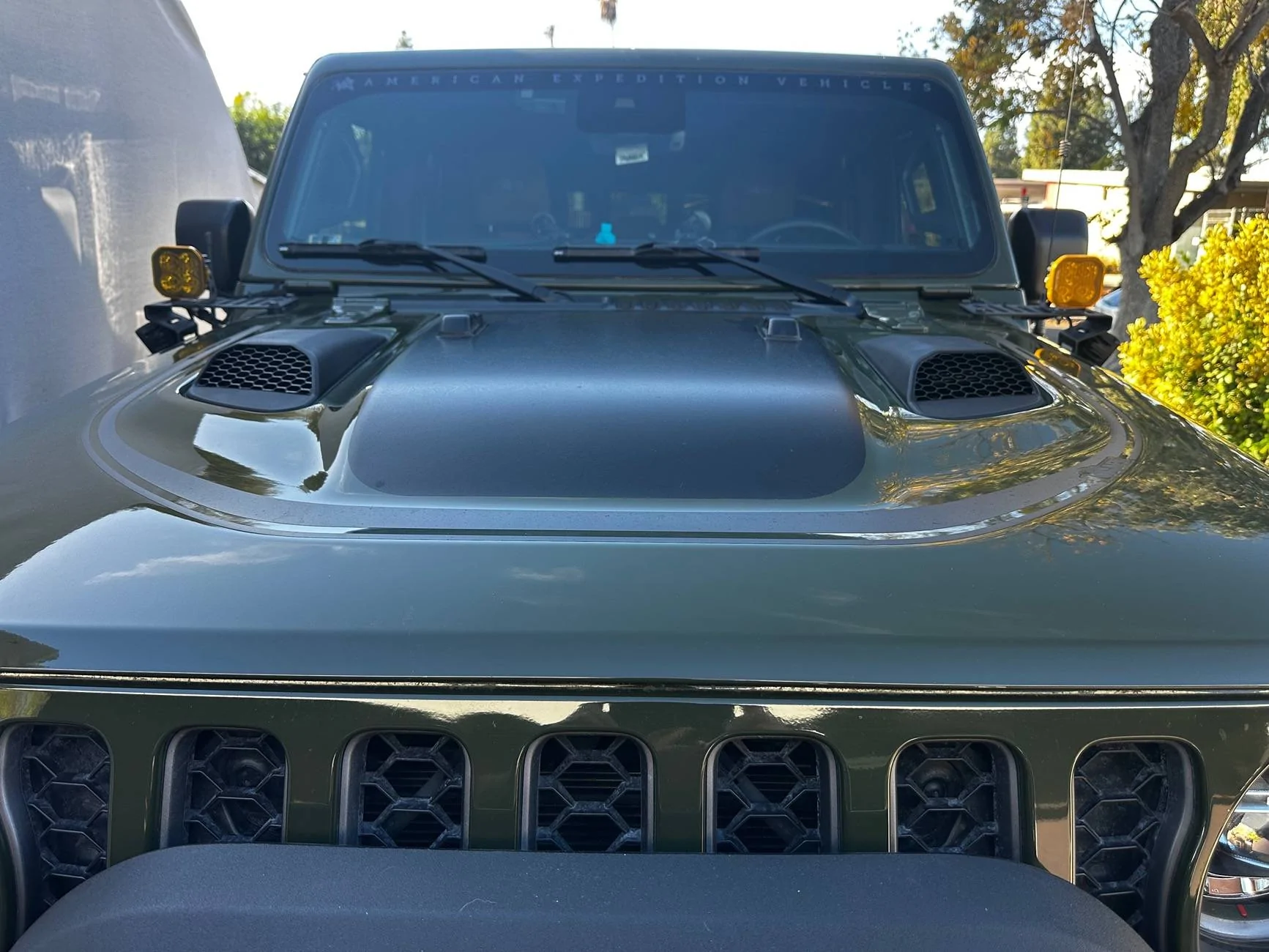

I know they don't do anything, but they look good! I had already cut out the rubicon vents so these were about 20 minutes or so to install. It was on the xmas list from the Mrs
Jeep Gladiator Diesel cooling options and ideas IMG_1436
Jeep Gladiator Diesel cooling options and ideas IMG_1437
Jeep Gladiator Diesel cooling options and ideas IMG_1438
S&B?
GladiatorPilot23
Dec 15, 2023
404
236
So Cal
2023 Gladiator Rubicon Eco-Diesel
I was looking at the picture and it does have the S&B logo on it.
They do look pretty nice but I recall some say it didn't stop overheating under high loads up mountains. One other issue is that I would block these from the inside until full summer temps. You lose warm up times and efficiency which will use up fuel in the cold. It would be so nice if it had a temp sensor and a grill shutter. That would be next level!

Yes S&B. For my area warm up isn’t a big issue but will put the plugs in when we are up in Mammoth over the weekend just to keep it warm - good tip. Shutters would be next level!
Somewhere in this 90+ pages it was discussed and they don’t do anything other than let heat out of the hood when low speed.

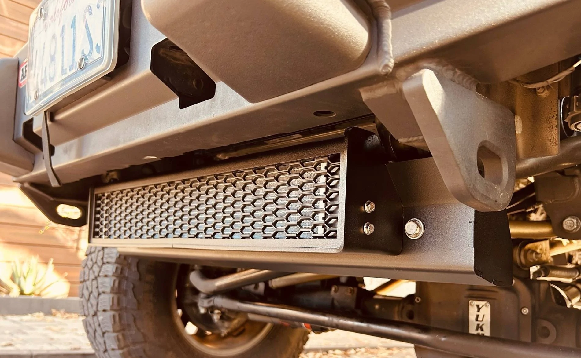

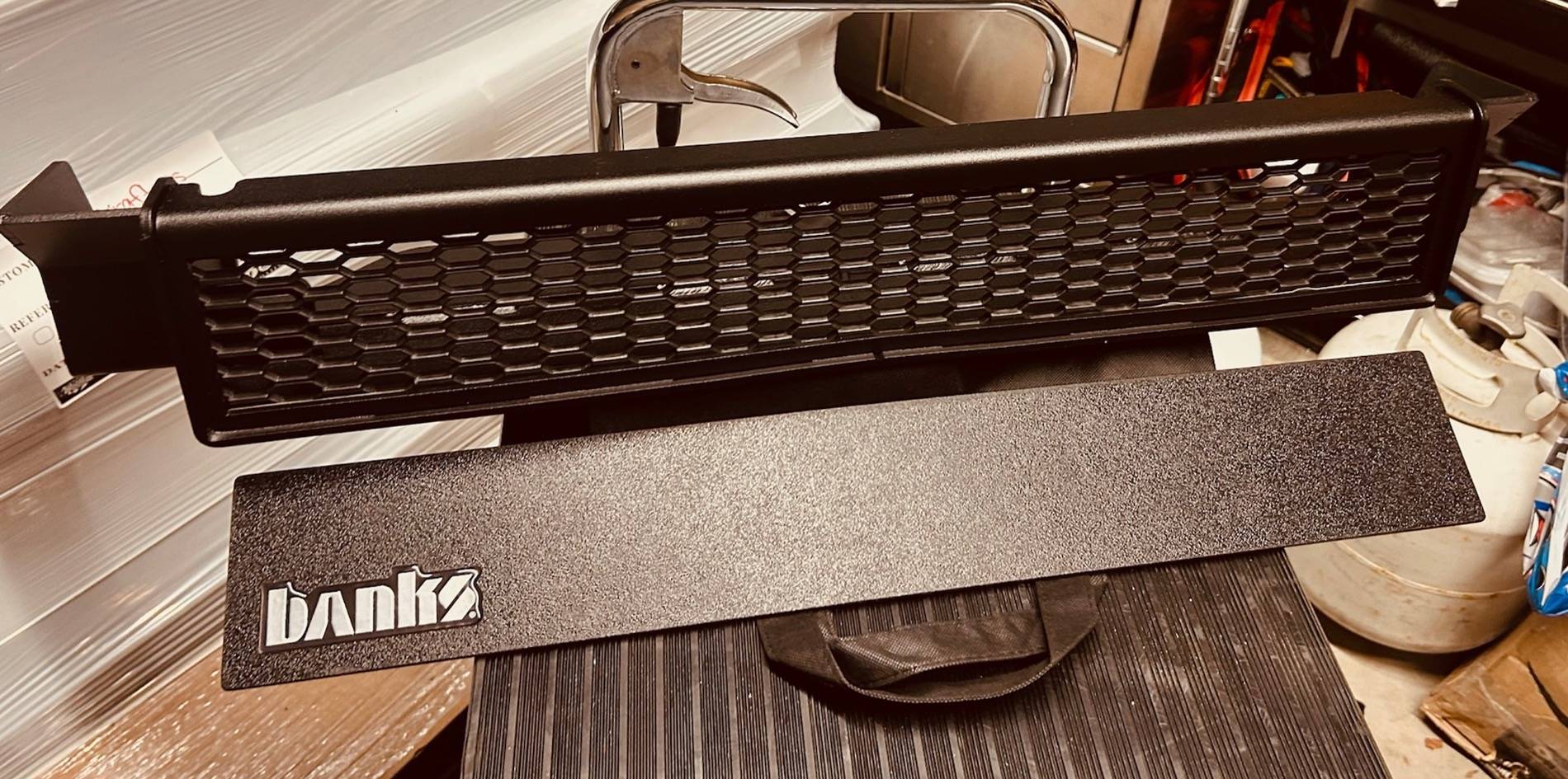

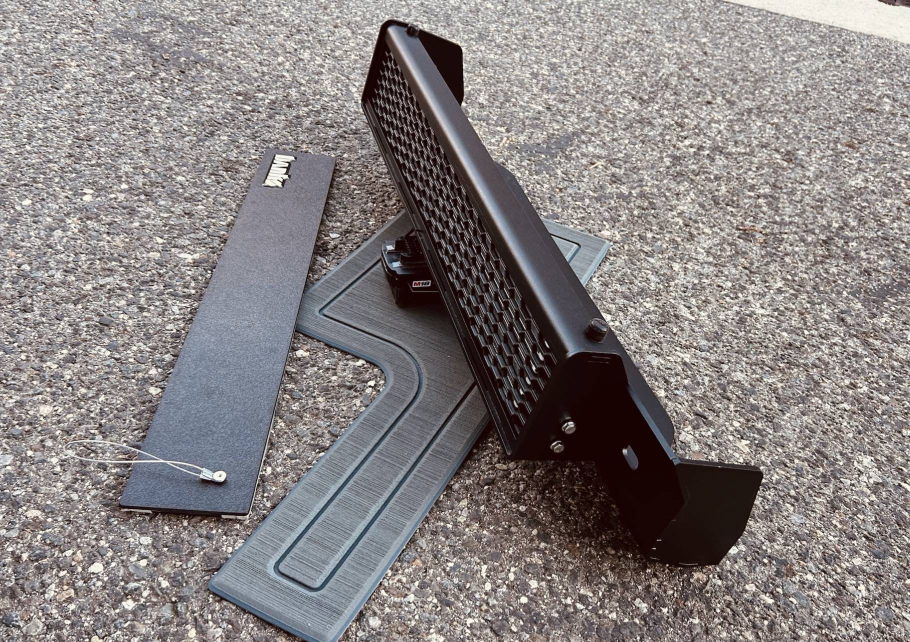

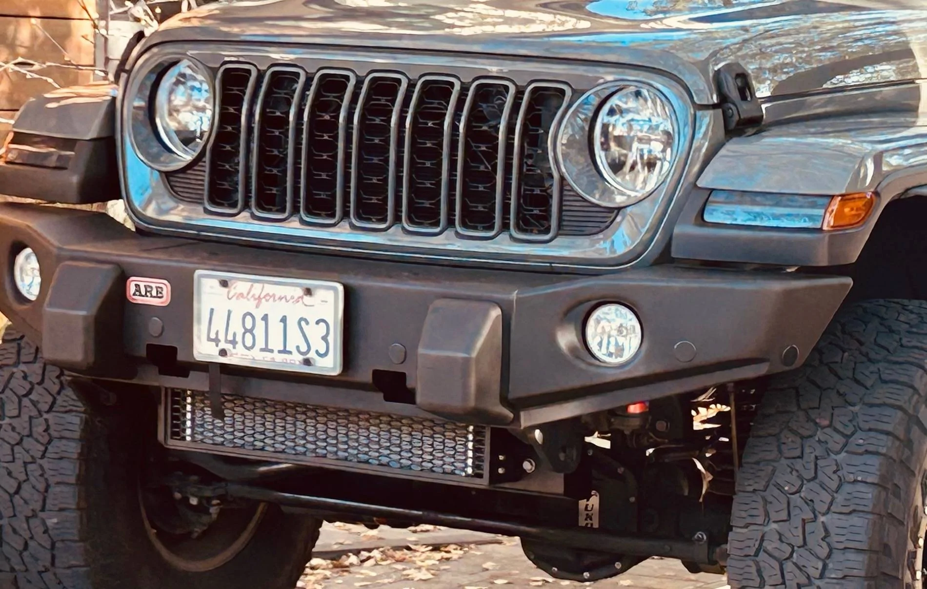

So I couldn’t help myself… had to keep playing with this..
Decided to build a larger assembly around a core that is about twice the size of the BPD unit.
All my issues are completely resolved now.
Only downside is that a magnetic block-off plate must be snapped onto the front of the unit when it is super cold out/if the vehicle is not towing/hauling a bunch of weight.
Jeep Gladiator Diesel cooling options and ideas IMG_4013
Jeep Gladiator Diesel cooling options and ideas IMG_4010
Jeep Gladiator Diesel cooling options and ideas IMG_4011
Jeep Gladiator Diesel cooling options and ideas IMG_4007
Jeep Gladiator Diesel cooling options and ideas IMG_4008
Jeep Gladiator Diesel cooling options and ideas IMG_4006
Jeep Gladiator Diesel cooling options and ideas IMG_4014
What core did you use?

It would end up costing too much for such a tine tiny run.. Limited bandwidth here…
Do you have files or prints for the shroud you made? Guys could send em off to their local fab shops and the cost would be on them.
