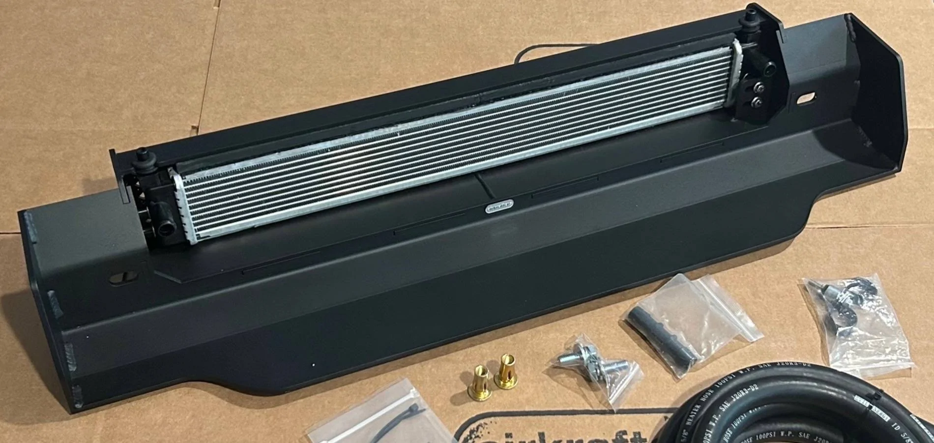

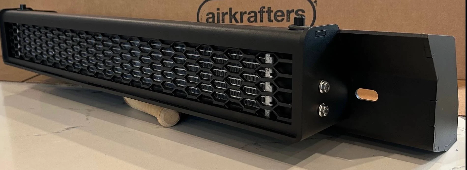

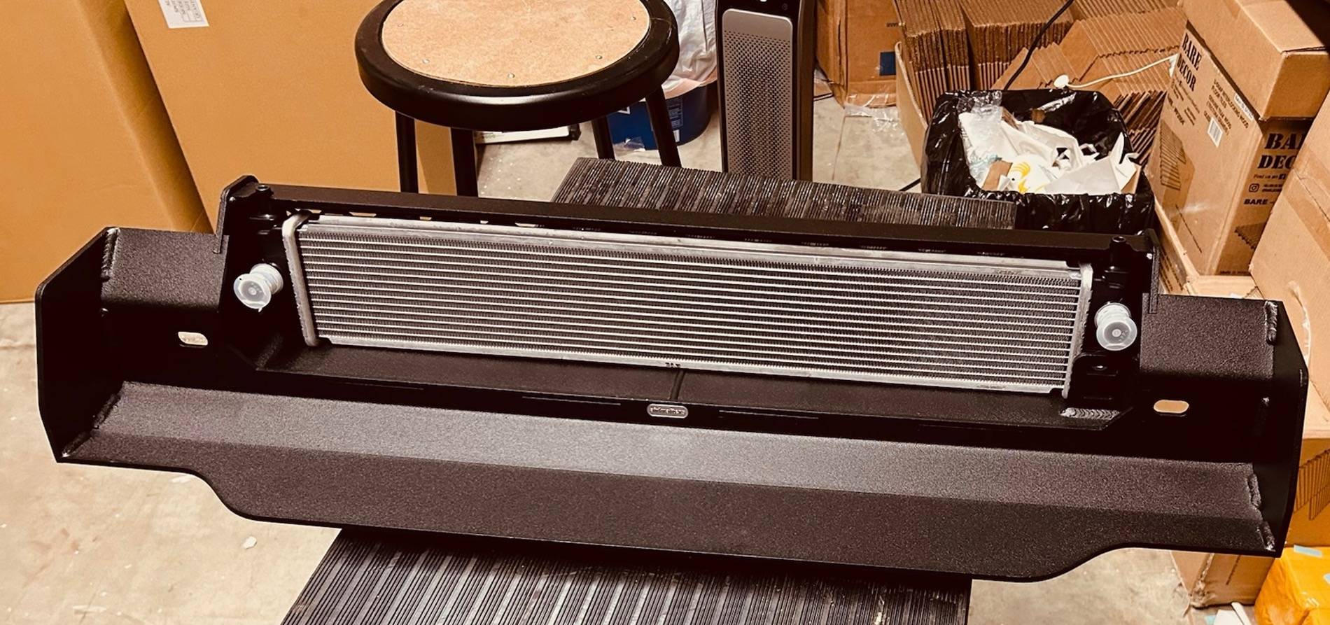

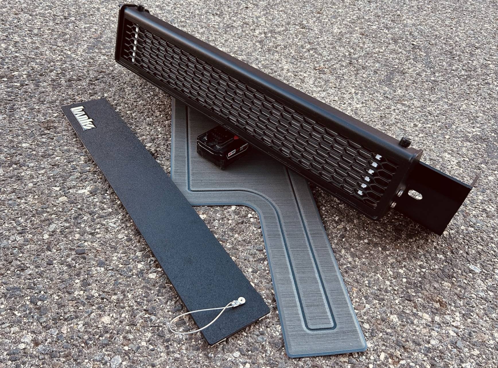

I didn’t print the mesh, it’s just an off the shelf cut to size abs screen from amazon:
https://www.amazon.com/gp/aw/d/B0B27T6LTP?psc=1&ref=ppx_pop_mob_b_asin_title
The larger cooler core is exactly the same width, depth, and has identical mounting features/location — it is just a number of rows taller.
I can email the cad file directly if anyone wants it, just message me..
I currently have 2 extra cooling assemblies on hand:
1. The original design with the BPD core (used)
2. The revised design with the larger core and magnetic block-off plate (new).
— see photos.
A few people have expressed interest each of these but no solid commitments from them yet..

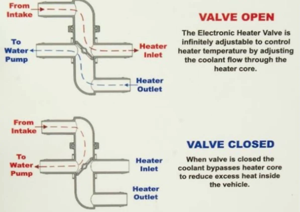

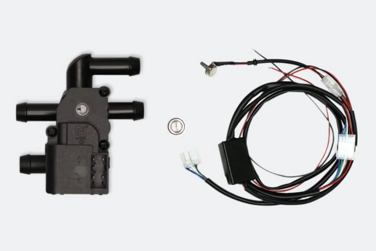

An alternative to using the block-off plate would be an electronic bypass manifold operated by one of the AUX buttons..
Almost went this route, and still may add it into the loop.. super simple to integrate and pretty affordable too..

That part of the cooling circuit from the oil cooler isn’t tied into the main radiator thermostat — so its always circulating..
This isn’t a problem with the BPD sized core, but anything larger will throw a ‘engine not getting to temperature’ code if it’s super cold out and the engine isn’t working hard.
Just keeping the block-off plate in place during normal driving completely resolves this..
