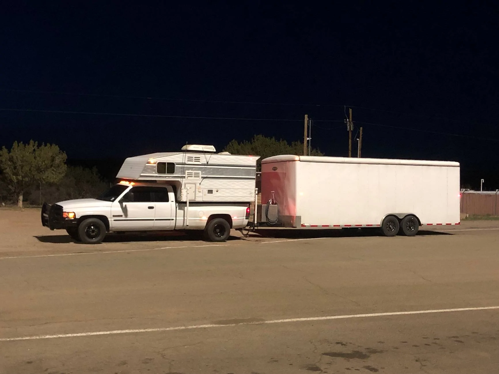

Even though I don’t tow with my Jt I feel everyone’s pain. Our yearly trip to Moab takes us through Amarillo to Albuquerque and the wind is brutal. I sometimes have to run 60 on the super slab even though I have compound turbos, injectors and plenty of power. EGT’s climb and we have to slow way down. Frustrating.
