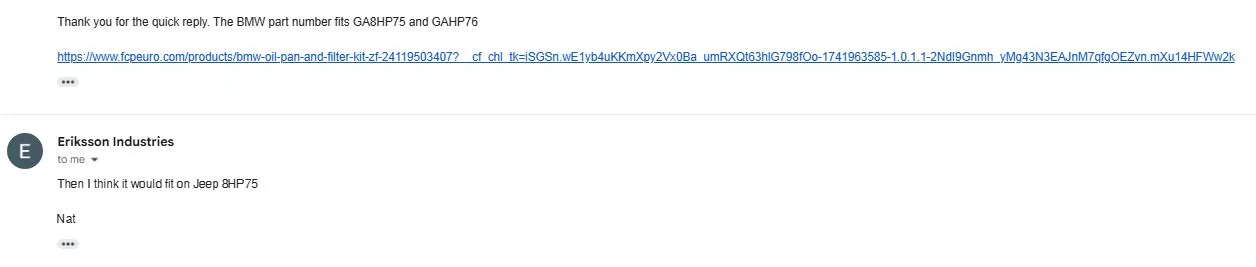

Has anyone confirmed the compatibility of the ZF 24119503407 transmission oil pan?
I contacted ZF directly, but they stated that they cannot compete with MOPAR and therefore were unable to provide any answers. They referred me to Eriksson Industries, and I’ve reached out to them—still waiting for a response.
Additionally, I have a friend who works in marketing for ZF in Europe. I’ve also reached out to them to see if they can ask around to provide more information. I'll update as soon as I hear back.

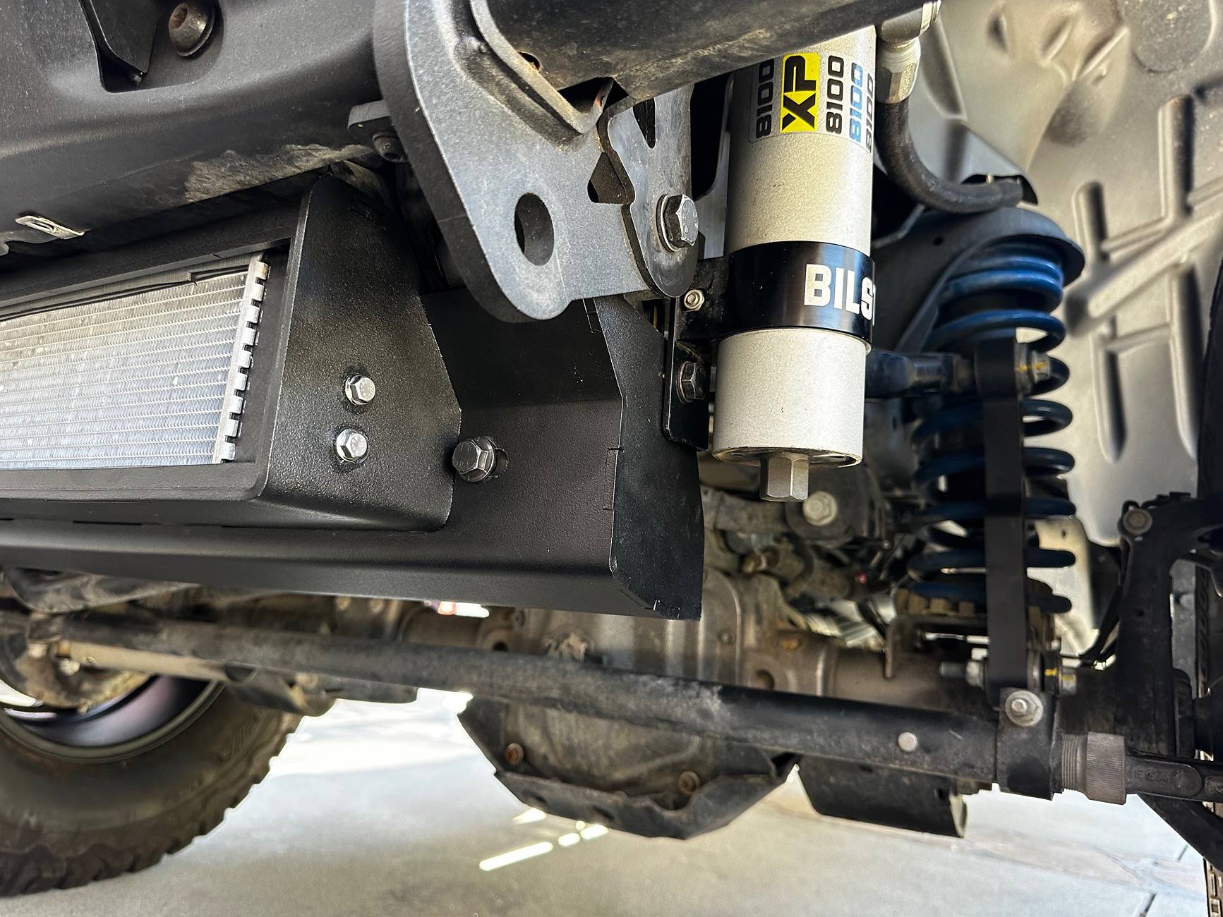

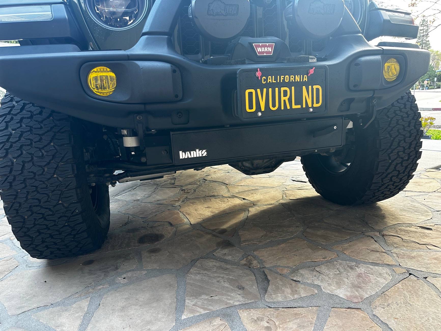

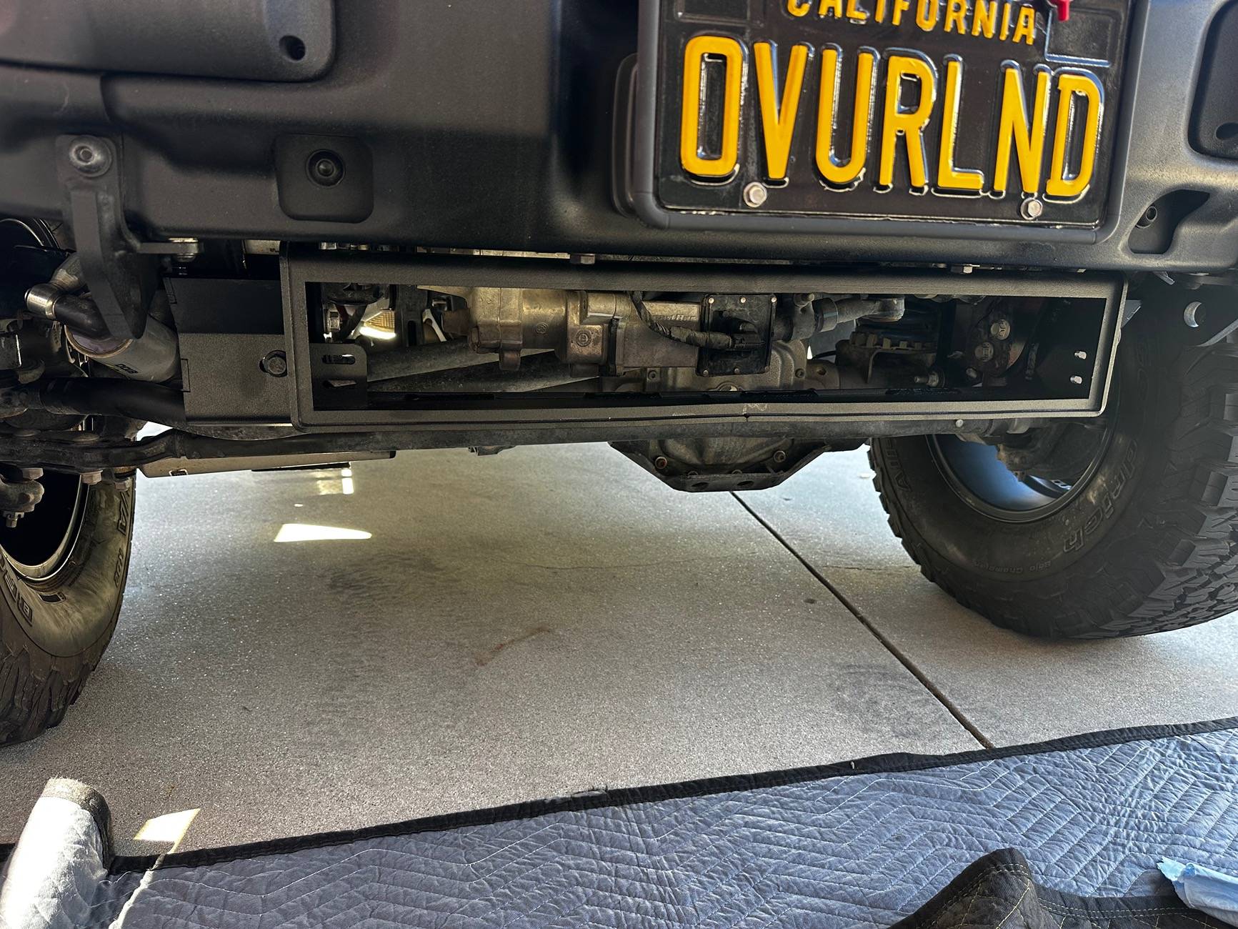

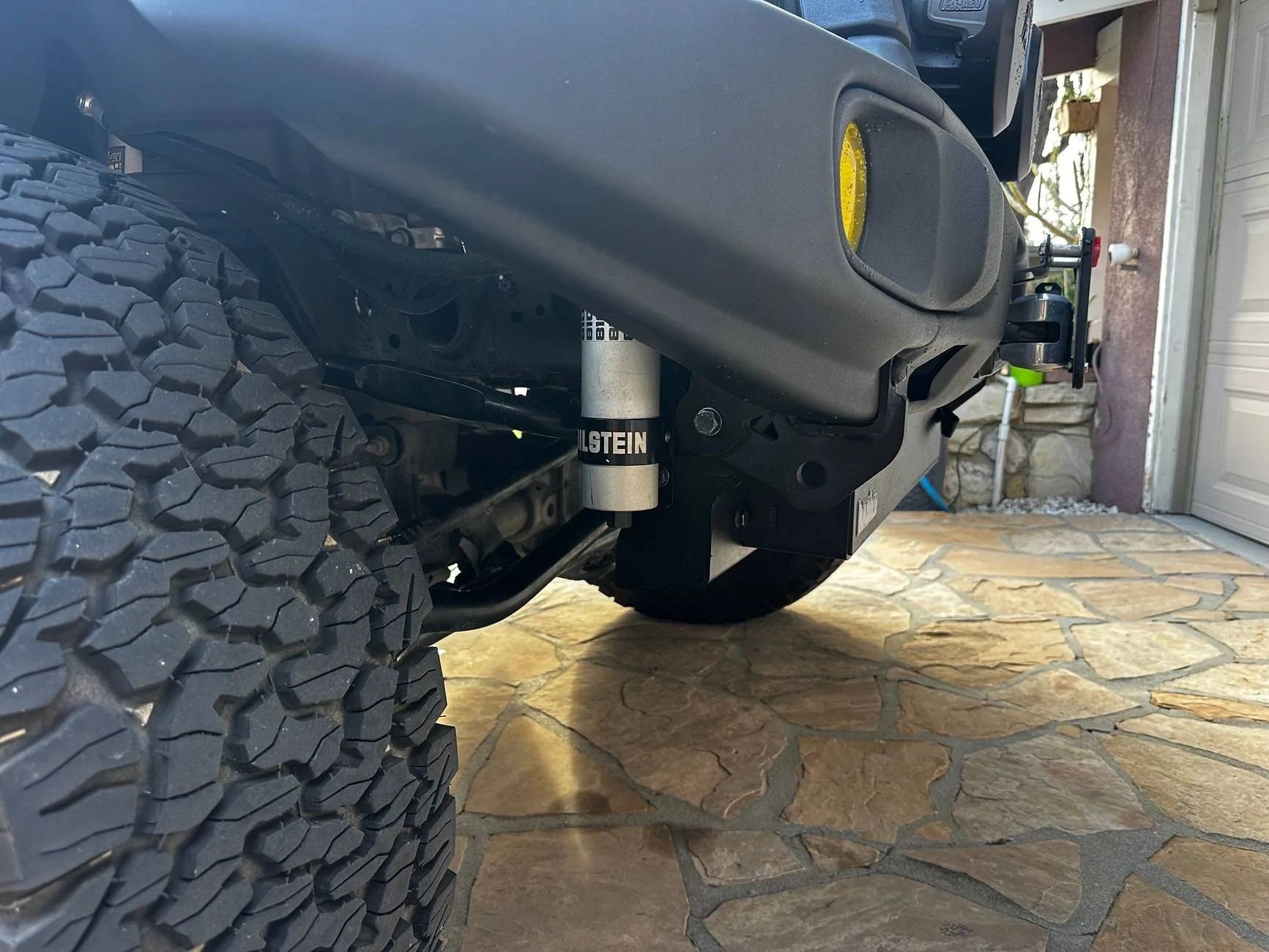

Took me a little while to find time, but finished up the install of the larger cooler that @Primer Gray built. As noted the quality is excellent. I had to do some trimming and massaging of the AEV winch plate brackets that come down along the frame horns. Once that was done everything fit perfectly. Added a couple holes on the sides to mount up the remote shock resovoirs.
Been driniving the JT to work all week. Coolant temps are much lower. in the morning it is hovering around 200*. Today it was mid to high 80's and I didnt see oil temps over 225 even when pushing up over 80mph and 1100* exhaust temps for shorter bursts. Prior to the cooler add the high exhaust temps would mirror quickly climbing oil temps. Going to tow next weekend on a route we have taken before. In the past we had to throttle down a lot on the hills to keep temps reasonable. Will be able to do a decent stress test to see how it performs.
So far, this is a very solid cooling upgrade.
Big thank you to @Primer Gray! Great guy who also provide real time tech support when I was working on this.
