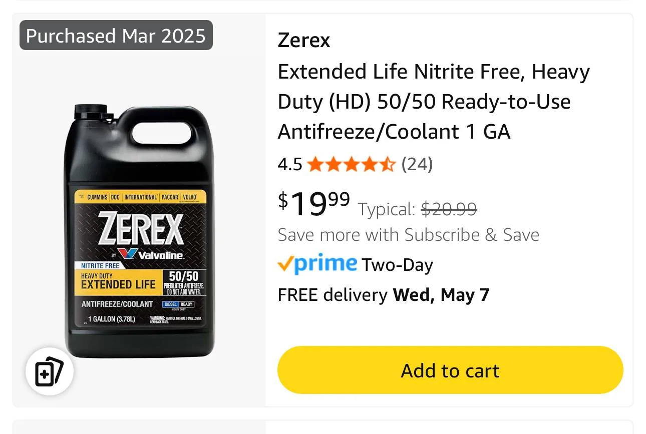

Where have you managed to find this coolant in stock? I've called a few places but it seems to be a unicorn so far....
I got it off the shelf at walmart
Actually this last time I got it from amazon but ive bought it previously at walmart as well

William thinks the Zerex HD yellow is looking promising because it's holding pH at 15,000 miles, but it's still in the testing phase. Amsoil makes three different coolants. He was interested in the Amsoil HD coolant (product code: ANTHD1G-EA). He thought it was an OAT coolant, but I just sent him a message letting him know that it's an HOAT coolant.

Max Wearhouse had a good deal on a case if you want more to flush.
