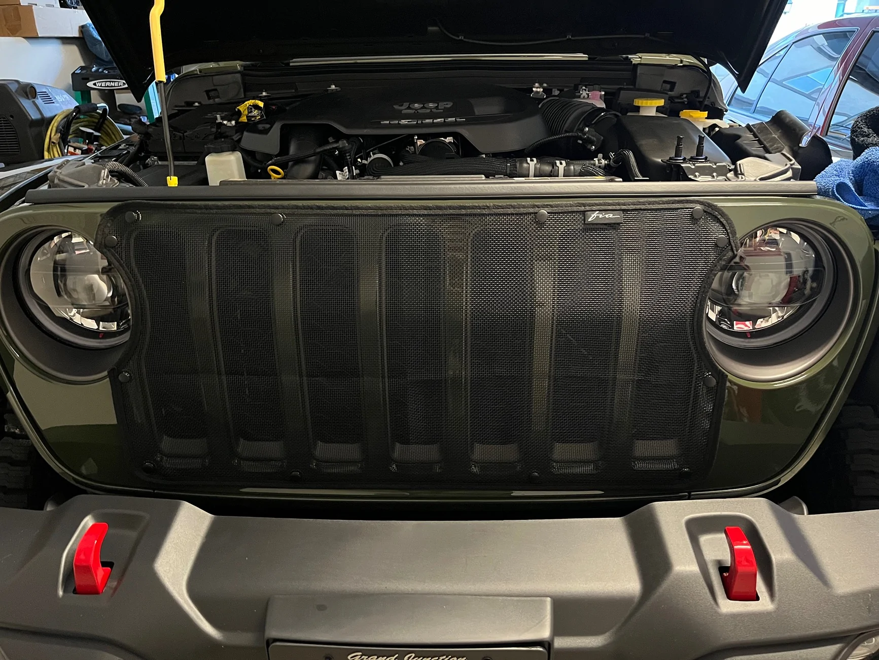

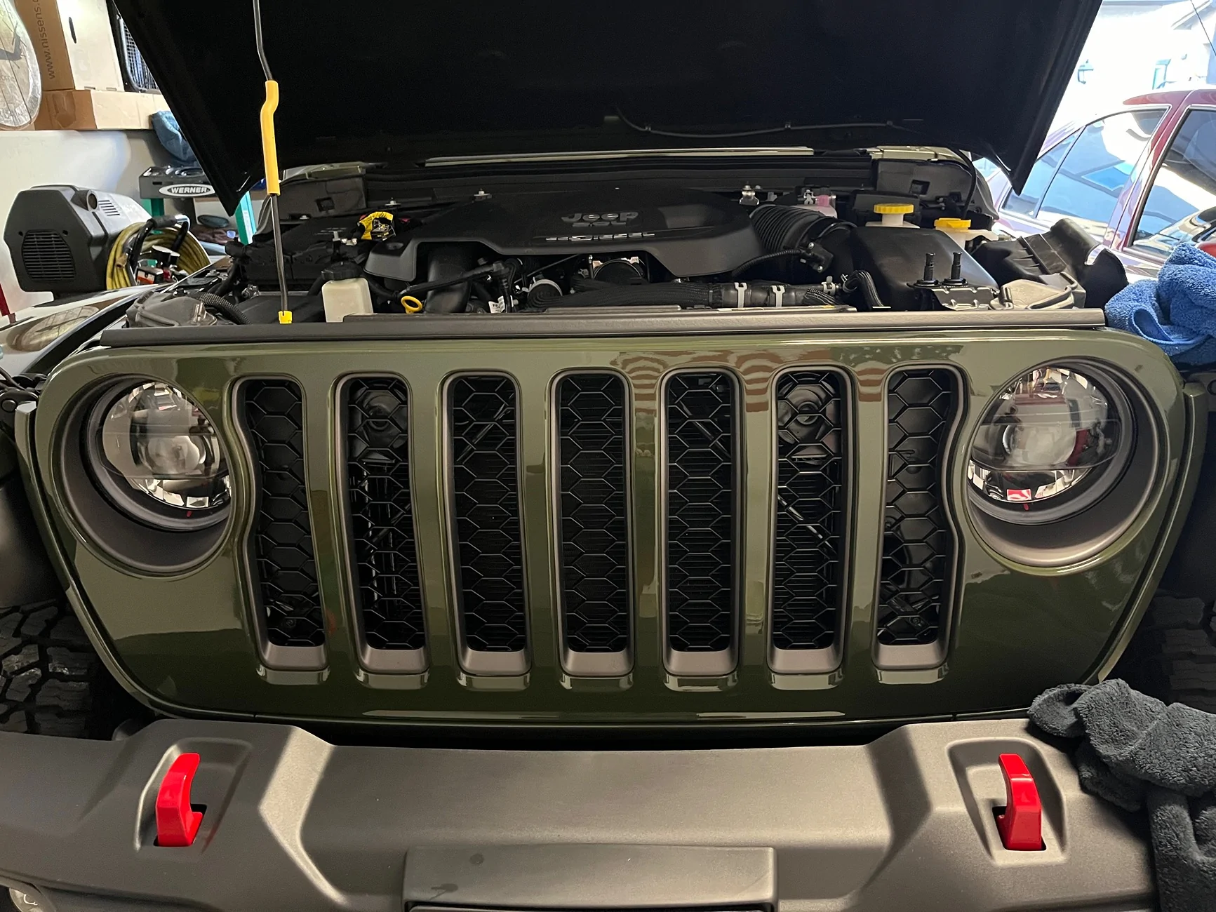

Hey Tony, might consider one of these screens for your grill? Put it on mine when I bought the truck and has kept the radiator stack nice and clean. Btw still loving your shock tune. Best riding jeep I’ve been in! Going on another trip to Pagosa Springs next week with it loaded down.
I don't really have a bug problem where we go locally, just want to make sure any dirt or other residue that might reduce heat transfer is not present in the coolers? That screen might even block some airflow? Maybe swap one on for the Alaska trip next year as an extra layer of protection from rocks and "bird sized" bugs they have up there?
Loving that feedback on the shocks! Glad you are enjoying.....Wish you could have tried them before I did my work as it would really add a whole new level appreciation. Stay cool down there!
yeah I’d definitely recommend one of these if your heading to an area with a lot of bugs. Keeps everything pretty clean.
I watched the temps before and after and didn’t see any increase with it on, that included loaded towing a camper as well.
I’ve settled with about 4 clicks on the high speed and 2 to 3 with the low. We always have a smile driving this thing on rough roads now 😂.

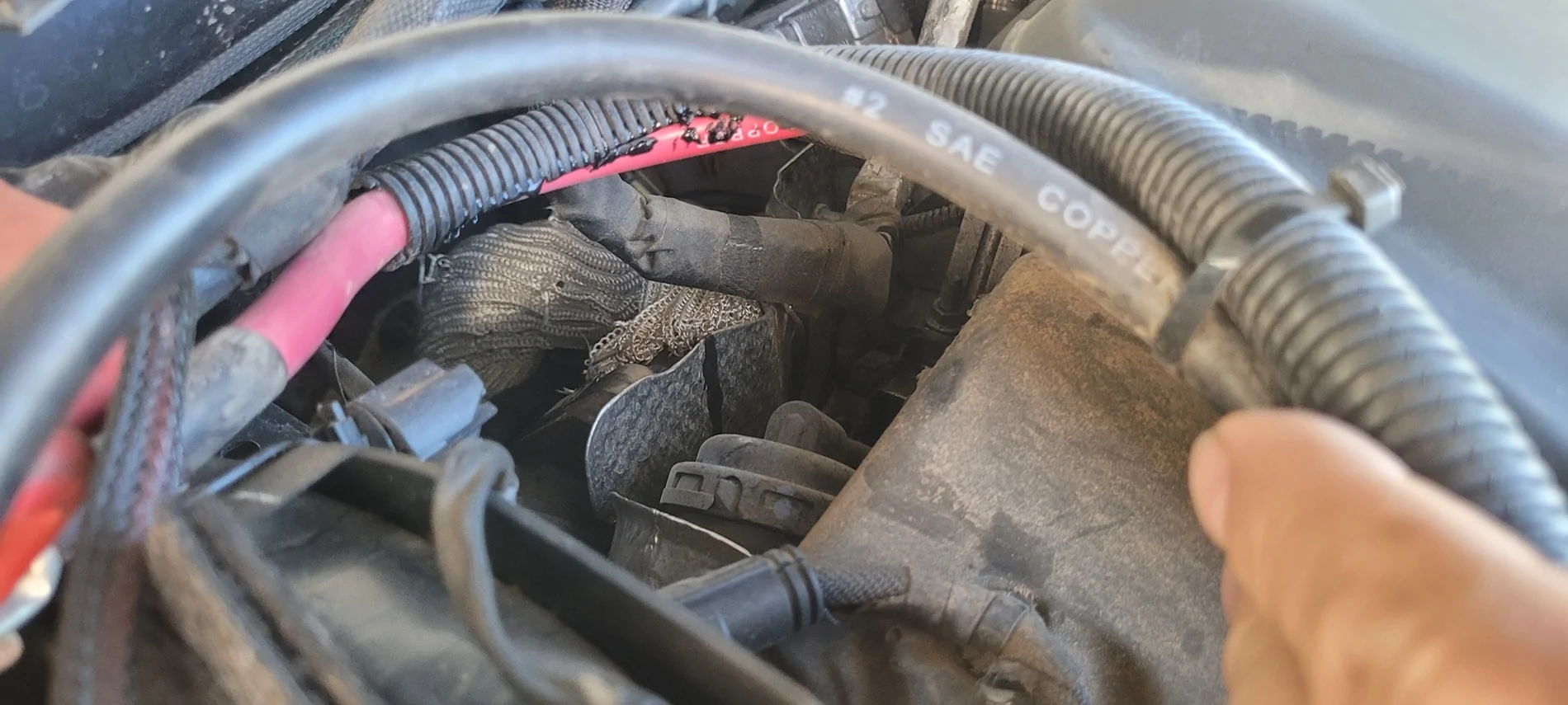

Mostly uneventful trip over the mountains with the cooler temps.
Got stopped on a steep uphill grade for controlled traffic and a few mins later I could see smoke coming out of the right side fake hood vent? Right then tragic started rolling so I went to the next wide spot.
Opened the hood having a look around and found the wire split loom from the positive cable for the winch was melting. It's been there since 2021 and nothing has changed on my end other than a dpf failure/replacement a few thousand miles ago. I've towed 10's of thousands of miles all over the country and never seen this.
Maybe the conditions were just perfect this time? Steep grade, possibly in the middle of a regen, followed by the stop?
I did smell something melting like wire about 22 months back while towing but didn't find anything at that time. No sure how many miles that as before the dpf failure, but I'll have to look at my records and see. I've only put 4k miles on it in the past 14 months?
maybe that cable rubbed through somewhere and creating a short?
That would be a sketchy situation? Thats why I why I double wrapped in the areas with any possible abrasion with heater hose.
It's definitely heat from the exhaust below melting it, just interesting that it's been fine for over 4 years and suddenly an issue? I've towed under tougher terrain in much hotter climates than today.
