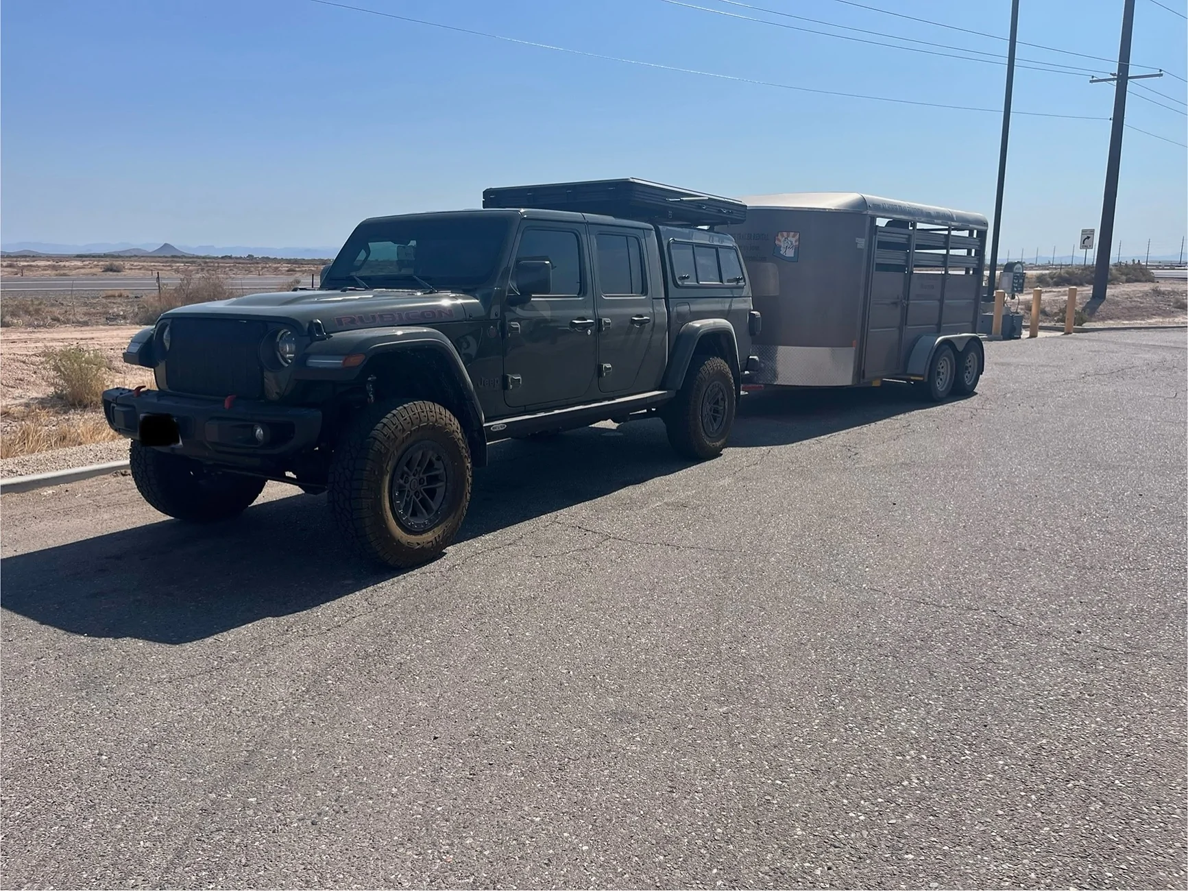

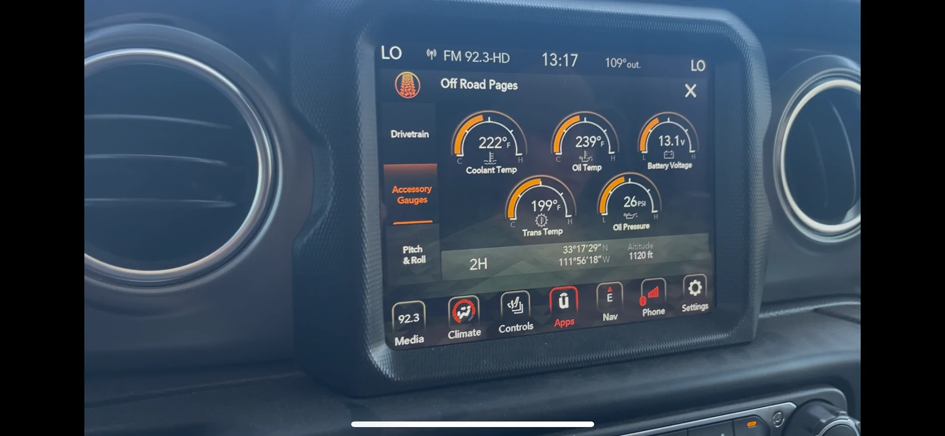

Picked up a horse with the jeep today. Was warm out, about 114 this afternoon 🥵. Temps all stayed manageable going up a few grades at 65 mph. Trailer and horse weighed around 3800lbs.
I have the HD airbags and put 40 psi in them. Added 4 clicks to the shocks and couldn’t even tell I was towing! Love this lift!
I wonder how much heat the EGR cooler transfers into the cooling system in the OE configuration?

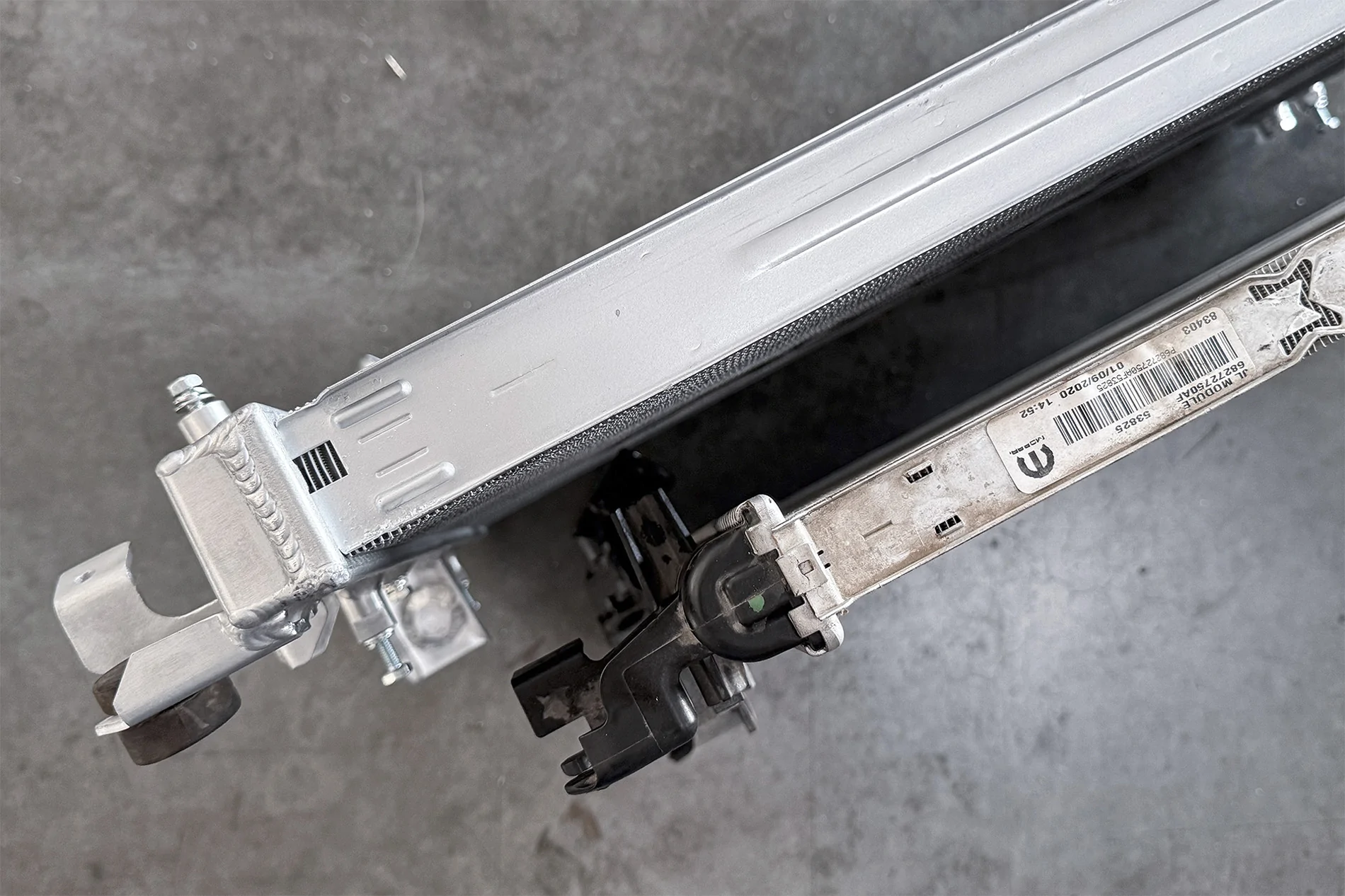

I did a big trip through Colorado last month, and ended up consistently getting derates while pulling the grades and trying to drive fast. Once I realized what was going on and started keeping my foot out of it, it was manageable, but I like going fast dammit!
Decided to do some shopping today and just noticed this. Funny timing, as apparently it was just announced yesterday:
https://news.csfrace.com/new-csf-jeep-wrangler-jl-gladiator-jt-heavy-duty-radiator/
The comparison of core thickness alone has me sold on this upgrade.

I sure wish you would buy one, do the install, test it and report back with results! 🙂
Good find

Their where to buy app doesn’t list Jeeps yet. I would definitely consider buying one.
Just added this to my wish list.
