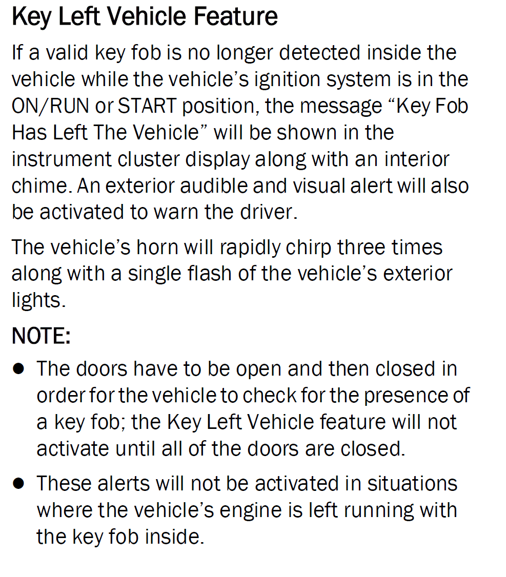

I've done some searching on forums, but I can't seem to find a definitive answer - is there a way to disable the honking when I step out of the vehicle with the keyfob in my pocket? It's really really really annoying.
I've searched for hours for an answer and only found more pissed Jeep & Ram owners with the same issue and the service dept. told them they couldn't disable that feature. I found on page 17 of my '22 owners manual under Key Left Vehicle Feature that the horn will chirp 3 times & the exterior lights will flash once when the engine is left running and the door is opened and all doors closed in order of the vehicle to check for the presence of a key fob; the key fob has left the vehicle will then be activated and then if no key fob is present the result is the annoying 3 loud horn blasts. I paid for the FOB to be a convenience so I wouldn't have to remove it from my pocket and the last time I left a door open the wind wrapped it around the fender and couldn't shut it. Hopefully an aftermarket flash will fix it or an animal sounding horn like a YETI scream, if I'm going to piss off the neighbors at 2am I might as well go all out.

Yup, I was about to post - I got a message from the dealer saying that's a new feature on '22s and cant' be disabled.
Here is the said quote - so to my mind, the solution is to leave the door open. This also explains why it didn't chirp at me sometimes - I definitely closed the door when I encountered it the first time and I am most likely didn't close the door when I was getting mail, so it didn't chirp which confused me.

So the solution is to not close the driver door fully if you intend to get back out?
Introduced with 2022 model year?
2020 doesn't have it. 2020 manual doesn't cover it. My truck doesn't do that.
I meant - not close the door when I step out of the vehicle (and don't want it to chirp).
Thankfully I live were few would hear it honk if mine even did. And in the garage which is away from the house, when it honks I can barely hear it in the house when I do a remote start. Not a problem for me in any way at all, but I can see it being an issue for others who may live in a neighborhood where homes are close, or parked along the street and you take off at 4am and wake people up. Not good.

They must have had enough complaints from people driving away without the FOB in the vehicle that they implemented a warning system to try and prevent it.
So, my 2021 does the flashes, and you get the notice on the dash. You even get a system beep (inside the vehicle, not the horn). But the horn doesn't honk. I guess that wasn't enough! My last car did the beep, and I hated it. I can get out of the gladiator and even lock the doors with the fob or the proximity.
