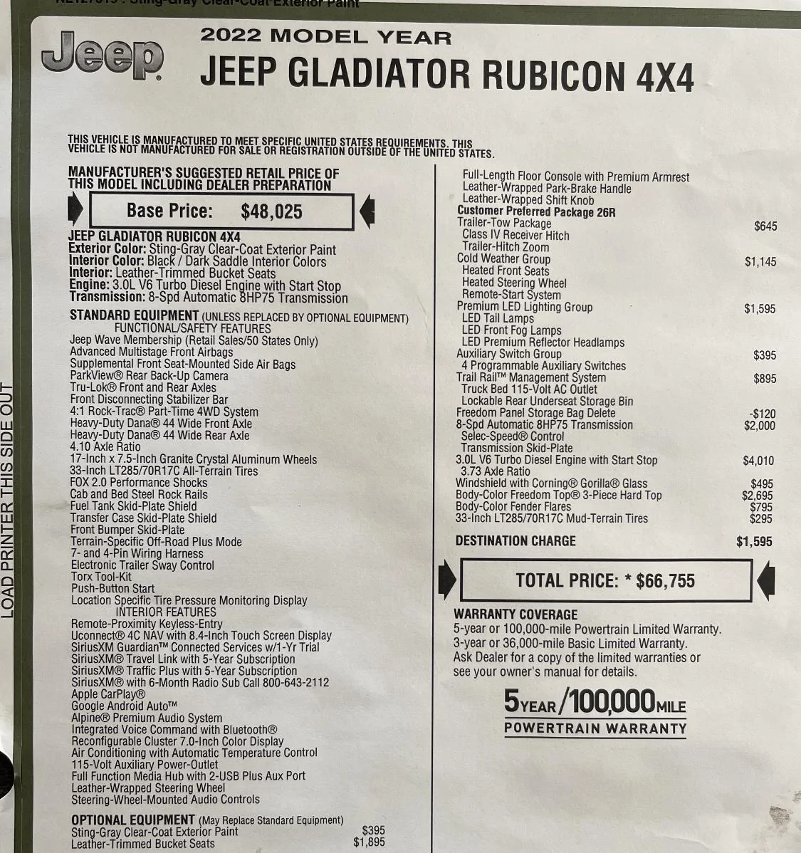

My 22 JTRD has the 4:1 Rock-Trac transfer case. The sport JTD that I just looked up shows the regular command trac transfer case on the window sticker.

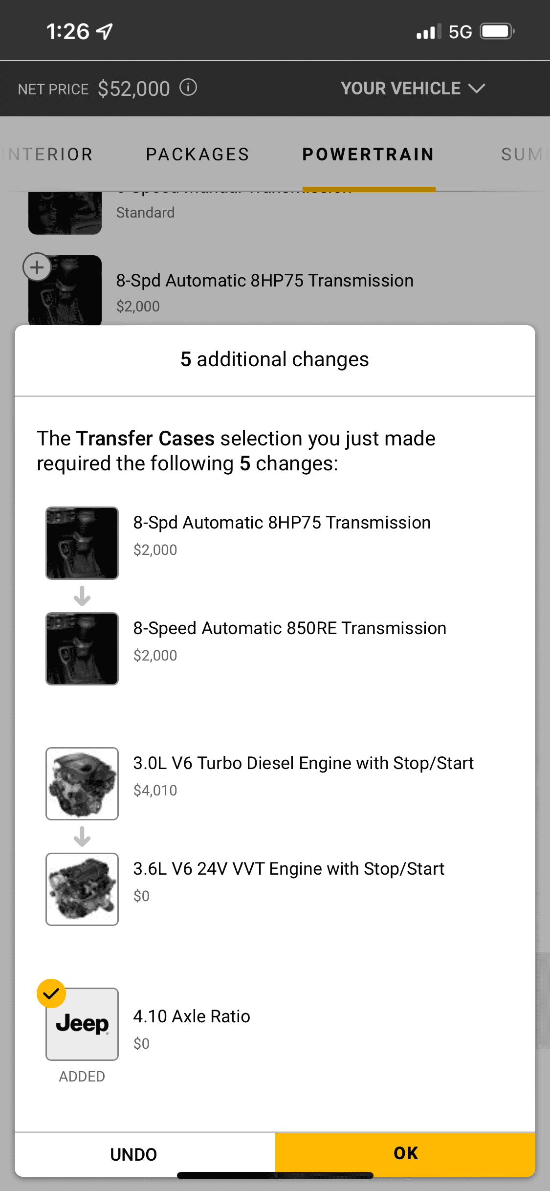

If you build a rubicon gladiator diesel it will come standard with a “4:1 Rock-Trac Part-Time 4WD system”
it has the option for
“4:1 Rock-Trac FULL TIME 4wd system”
it will not come- even though the sticker shows it… with 4.10 axle gears…. (Left column shows 4.10– right shows the 3.73’s.)
Don't think you can option the FULL TIME system with the diesel for whatever reason. Not with the 4:1 system on the Rubicon nor the 2.73:1 standard system.
