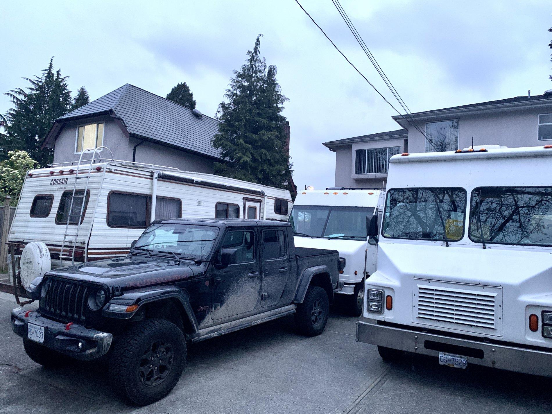

I know it’s not the topic here...but in 9 years of driving the flat windshield on the trucks in the photos, I’ve never had a stone chip or crack yet...

JKABBQ
Ron
Dec 10, 2019
116
228
Vancouver
1986 Corsair, 1991 P40
Ok so it drove great until you had the lift put on:idea:
Yes...that’s another reason why I didn’t bring it up because I also thought it may have been unrelated to the steering issues others have had because mine happened after the lift.
