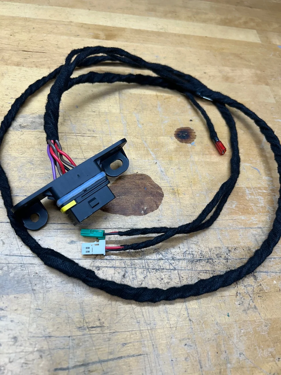

I made this double bypass harness today. I'll install it tomorrow and will try to see if the Scangauge 3 would pickup any additional PIDs. I doubt it but who knows without trying.
Impressive! We need to get you some UL listed, hi-heat, Data wire with some proper shielding. You could make a new Engine wire harness. Probably fix everything!
Well almost. I think we have a little programming issue too.
