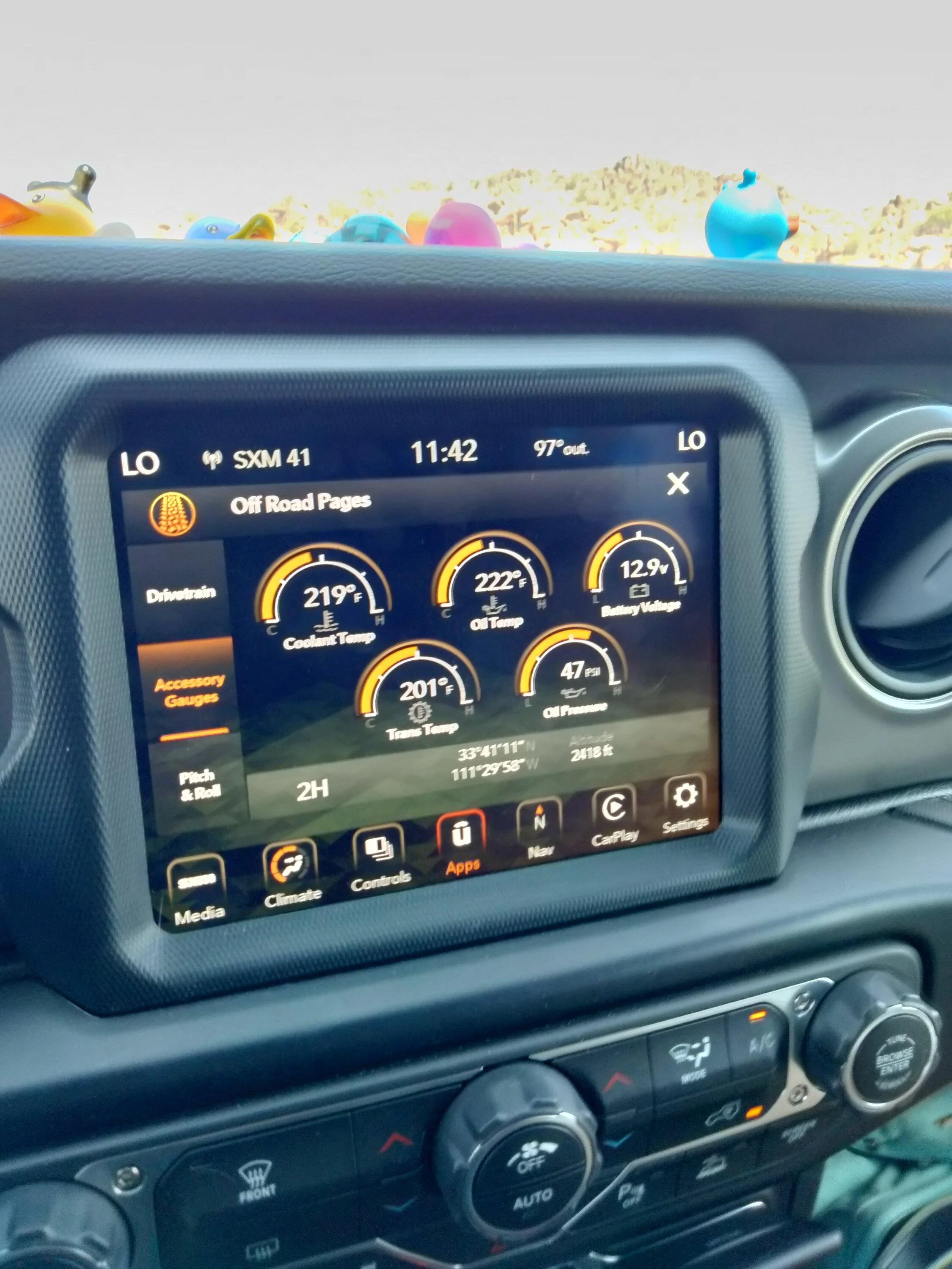

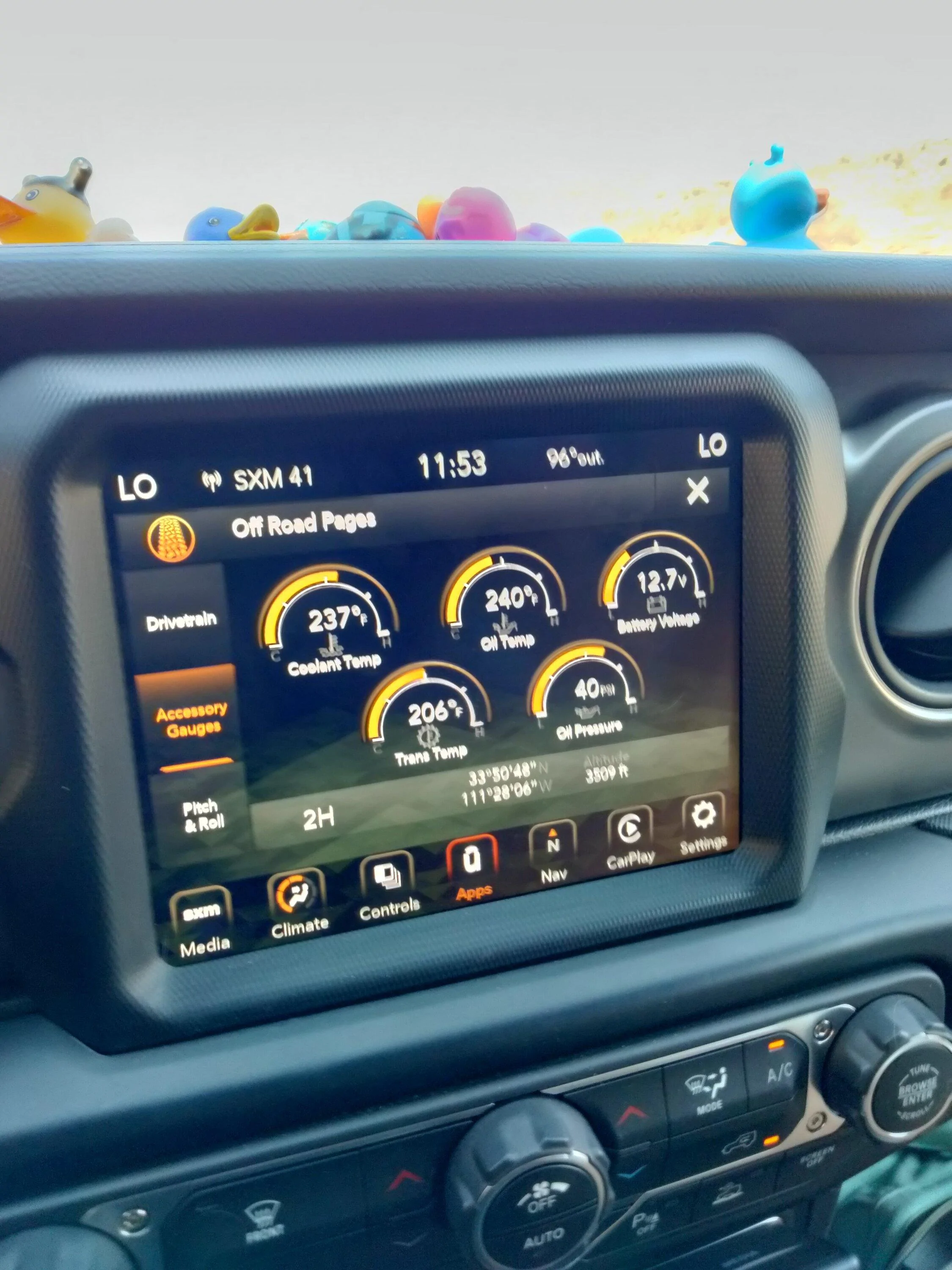

First picture at 11:42 is at the beginning of the long 6% and the second picture at 11:53 is at the top. Didn't get one when we crested but it dropped back down into the teens pretty quickly.
