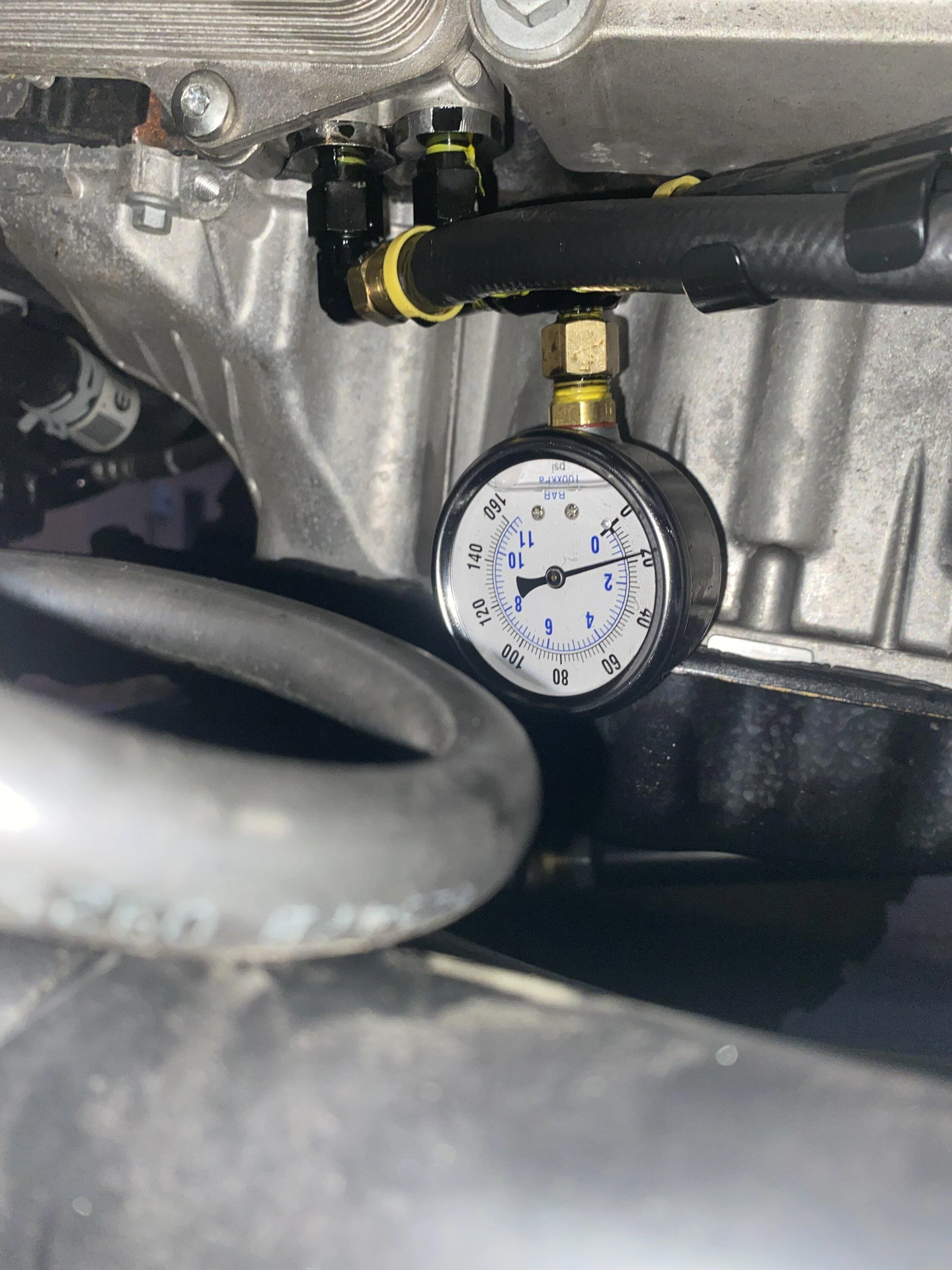

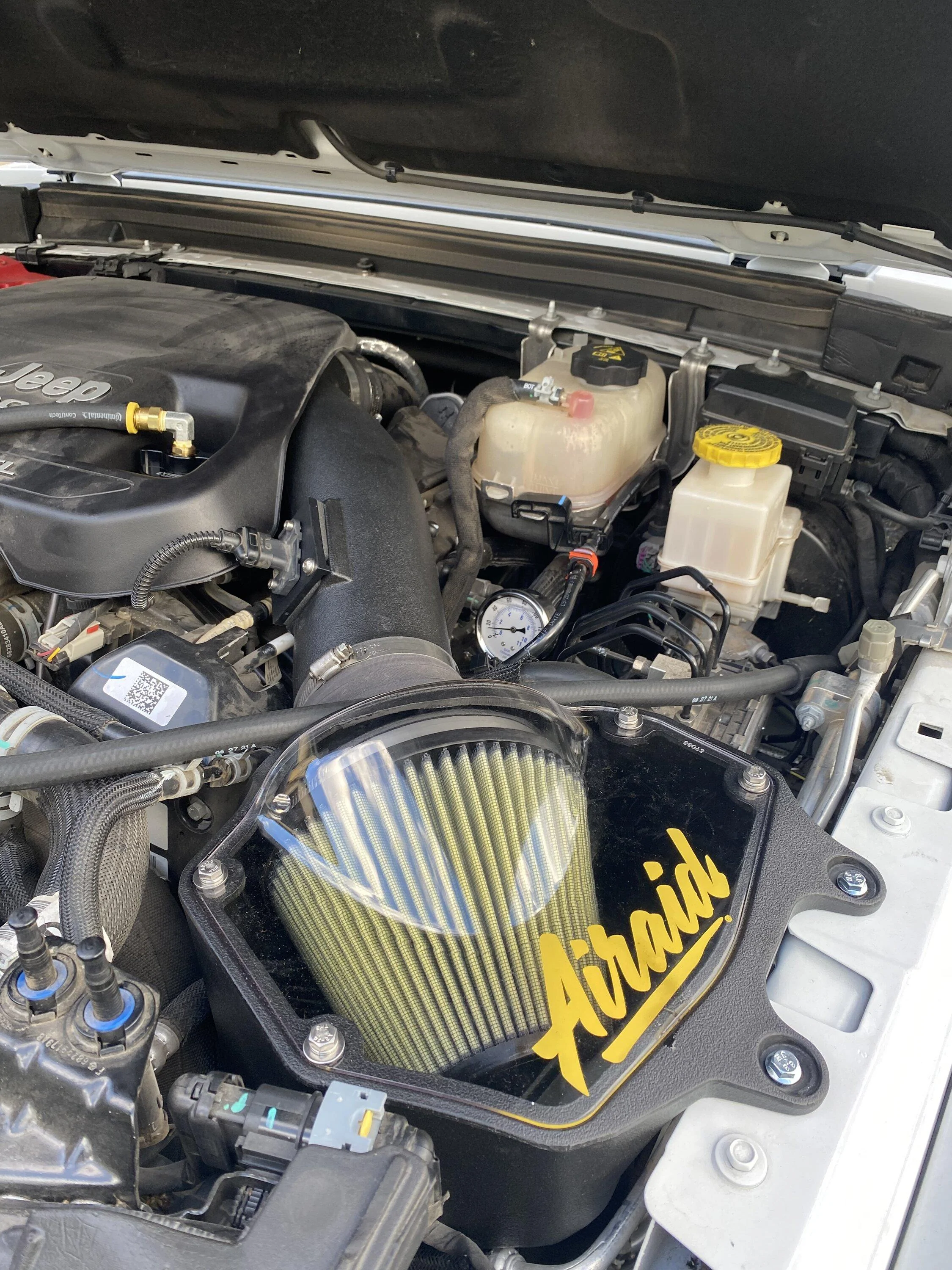

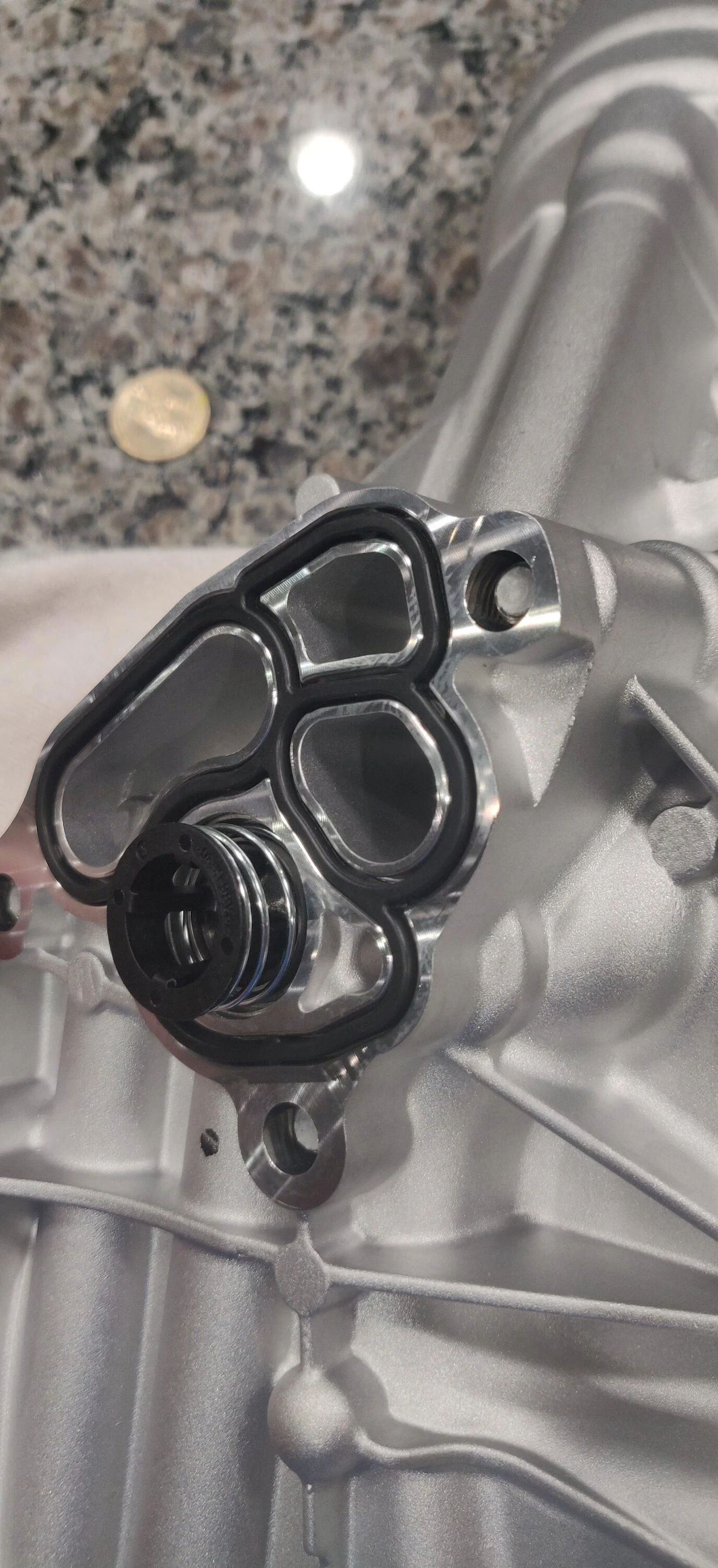

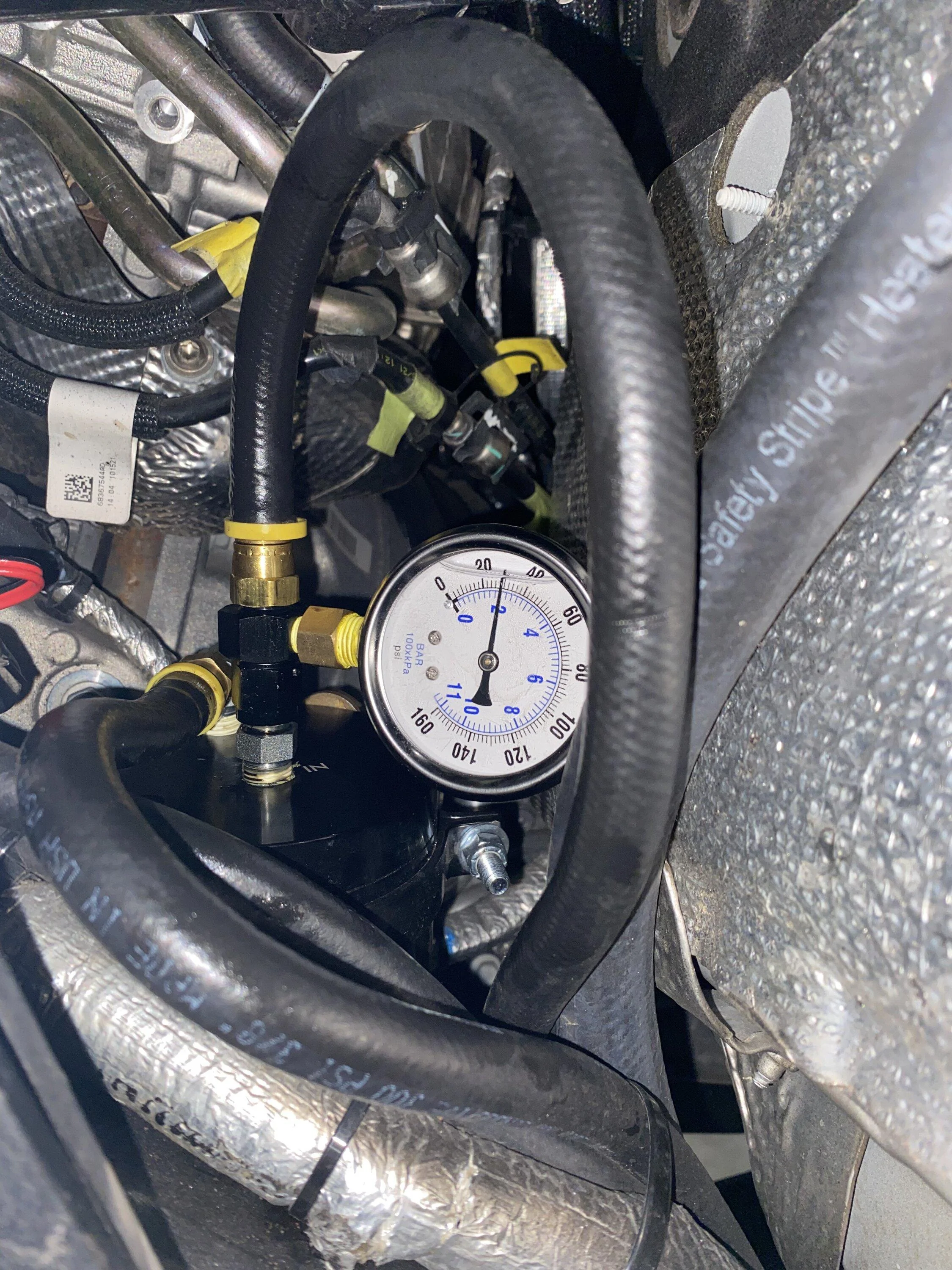

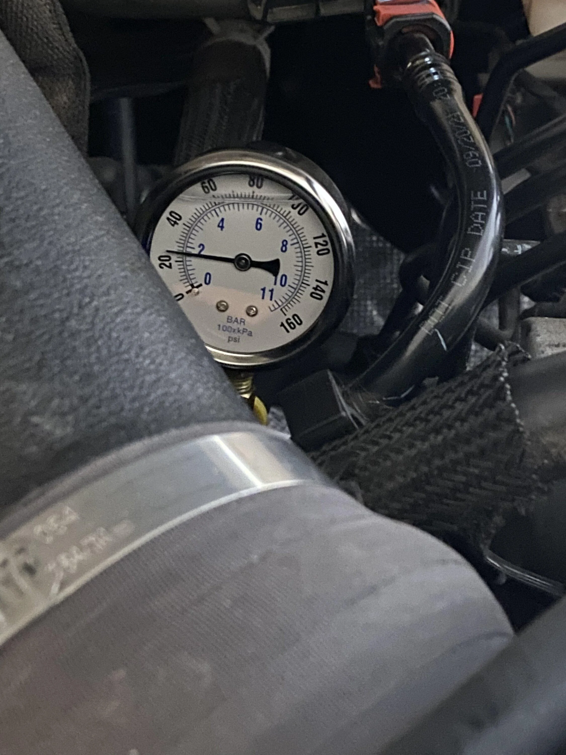

I did some pressure testing with the 2 plugs on the bottom of the oil filter housing. Also tested the port coming out the top of my oil filter housing. I did all testing twice. Once with the oil pressure gauge at the end of line, then in line with flow going to my oil bypass/cooler.
The findings are simple to report. All oil PSI is the same from all ports. Matches what the Off-road pages says once warmed up.
This tells me we have an oil T-State built into the oil filter housing. Probably the black piece shown in the picture. I ran the oil temp up to 230* with no change in pressure between the 2 oil filter housing ports.
