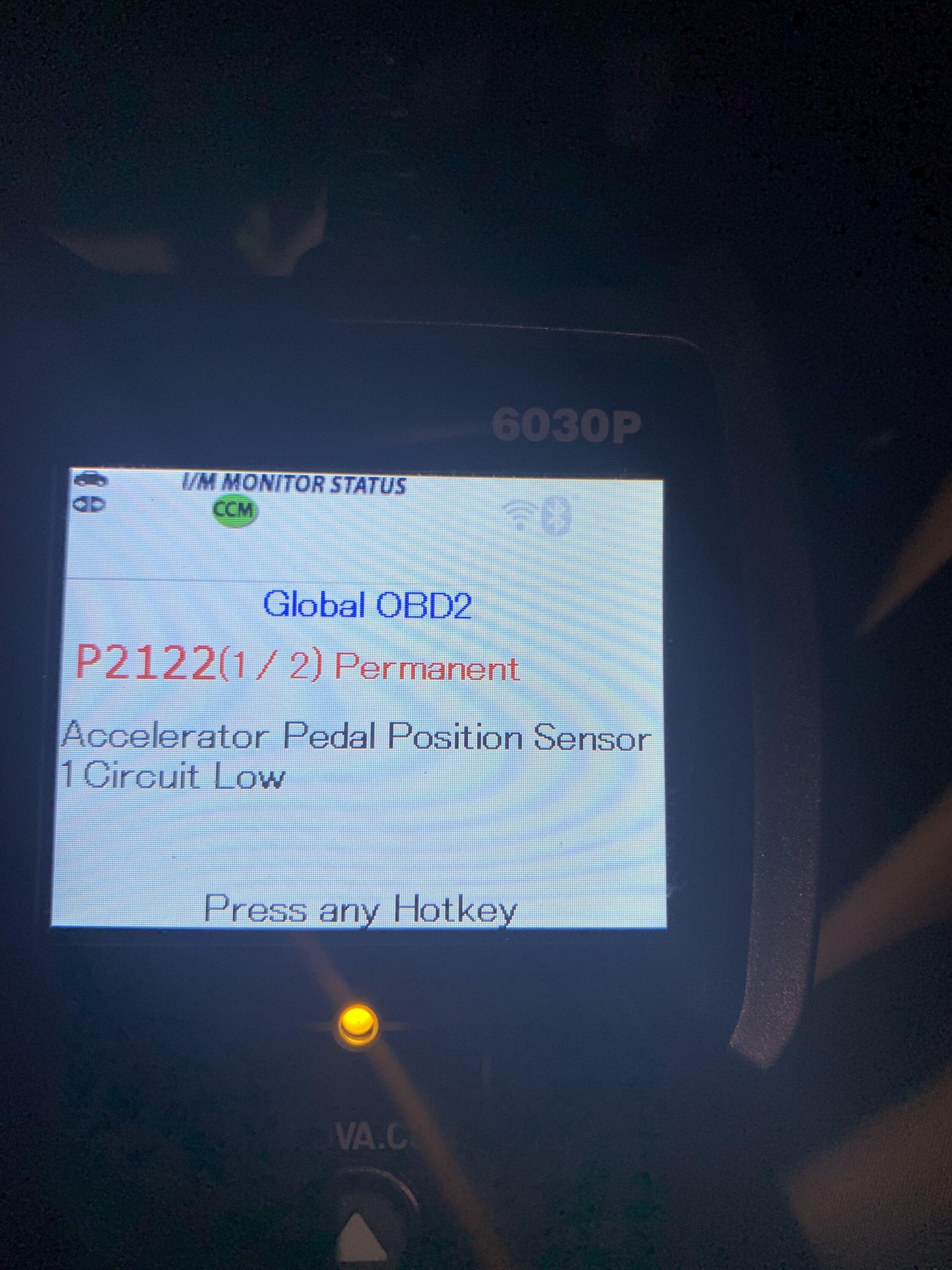

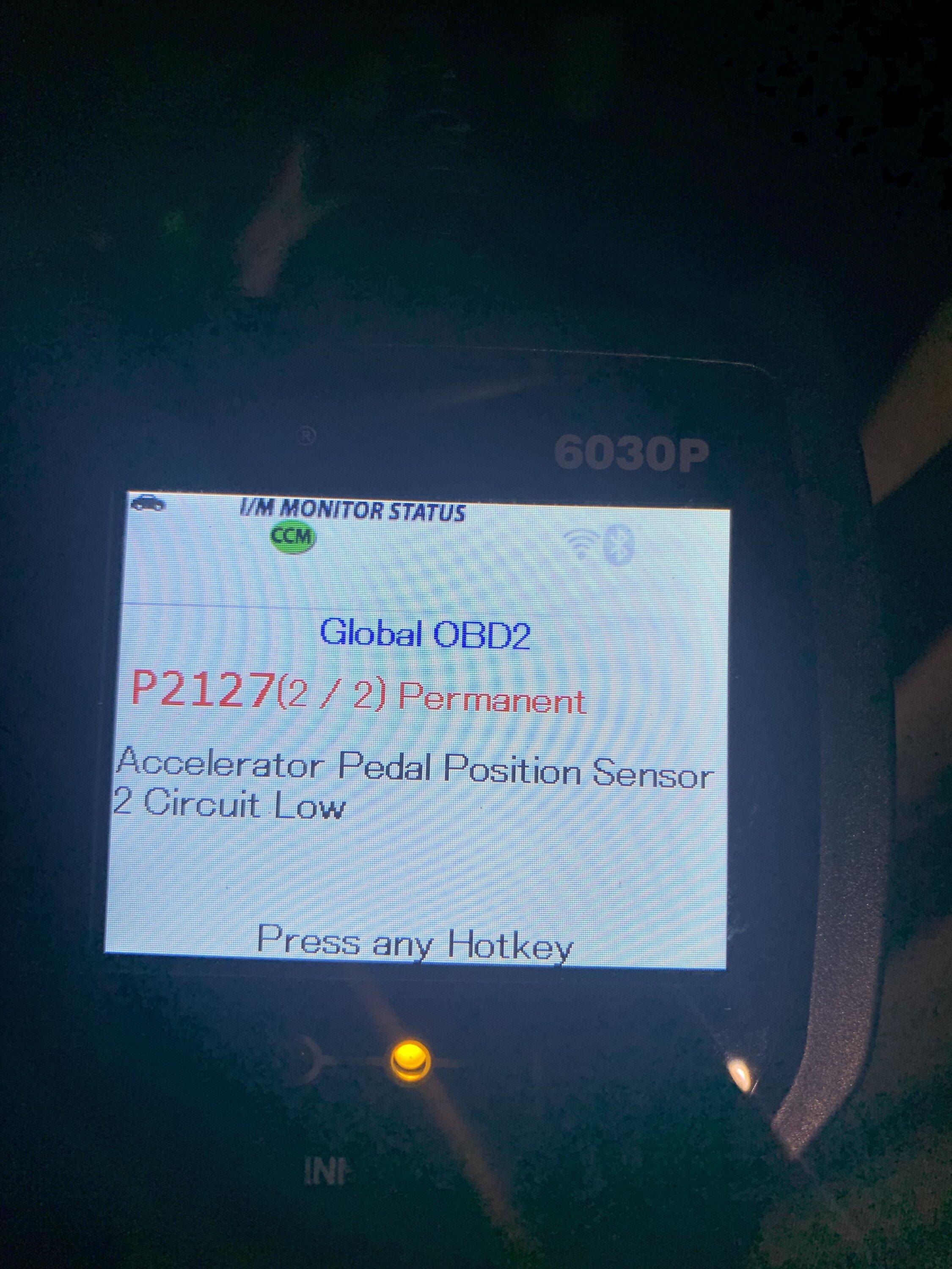

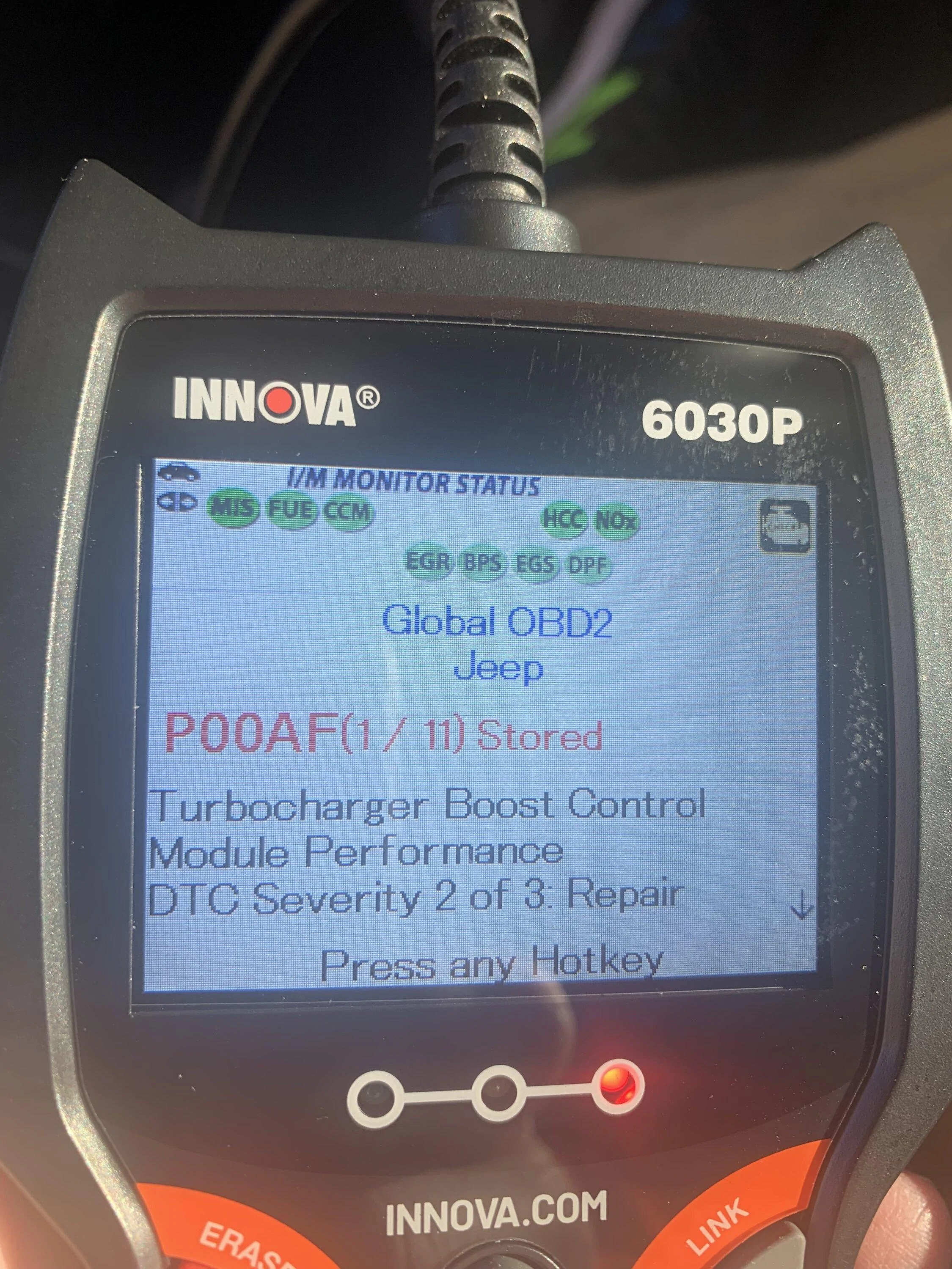

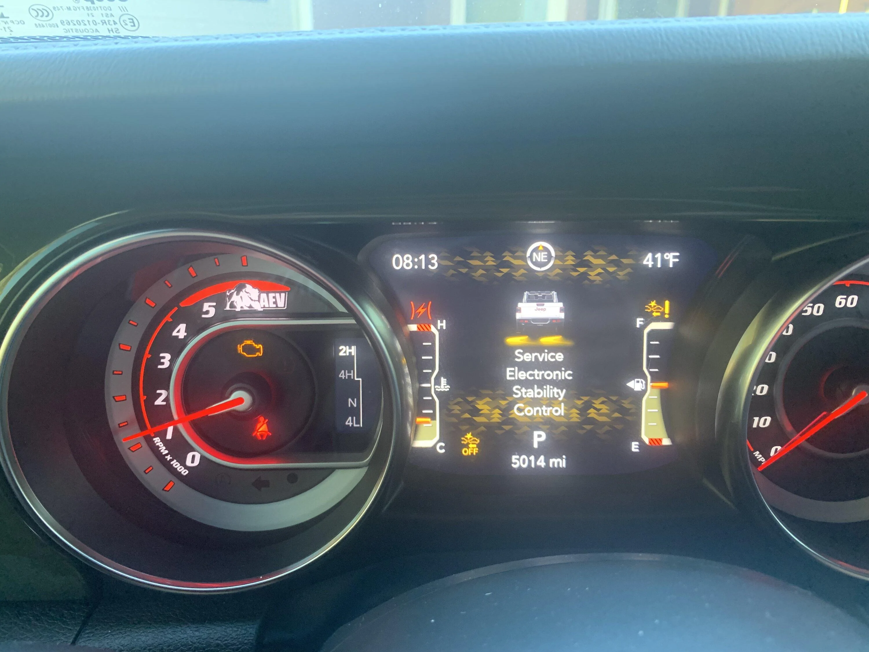

Over the weekend hooked up our TT (no water, very little gear, truck only me, GVW fully loaded up is 5,500) and took a quick test spin. Did maybe 15 miles, 64* out, some small grades but nothing of significance. Was just about home and oil temp went up to 249 on the dash - Service Electronic Throttle alert and maybe a slight derate, but didnt feel significant. No issues getting the last 2 miles or so back to the house.
Took a drive in the evening and all was fine. Next morning I used remote start and the truck shut off. Went out and started it and CEL was Service Electronic Stability Control. JT was in limp mode and would not go above 15mph and no real throttle input allowed.
Put the code reader on and Turbo Boost Control code displayed. Looked at some of the data log and it said oil hit 252* at 55mph. Tried to call a dealer that has been good to have it looked at - service dept doesn't answer, VM, no call back, state of the game nowadays.
Cleared the code. Checked again and it showed two permanent codes Accelerator Pedal Position.
Truck drives fine and CELs have not returned from normal driving (not towing). Those permanent codes are now gone after driving it around.
No tune or motor mods. I do have a pedal commander. Went ahead and removed that to eliminate any non stock confounders. Also may pull off the giant AEV lights before towing again. Going to give it another try soon and see how it goes.
Did a check of all fuses and checked the PCM connections - suggested in other threads for the codes displayed.
The truck felt great towing. Plenty of power. Braking was good with the Redarc controller. Handled the trailer well. Was very happy with perf on the short run. Never any previous codes or issues (no towing)
All the above gives me a lot of concern about towing. Not expecting to be pulling through the Sierras but should be able to tow local around SoCal. Hoping a clear oil cooler solution comes out of all the great posts in this thread.

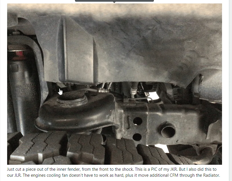

Anyone tried trimming the plastic inner fender liners. Saw this over on the JL forum...
Jeep Gladiator Ecodiesel power derating as temps rise? 2022-11-18 11_39_00-(1) Overheating... _ Page 4 _ Jeep Wrangler Forums (JL _ JLU) - Rubicon,
2022-11-18 11_39_00-(1) Overheating... _ Page 4 _ Jeep Wrangler Forums (JL _ JLU) - Rubicon, S...png
I trimmed some triangular holes in mine just to let some heat out. Doesnt do anything really.
