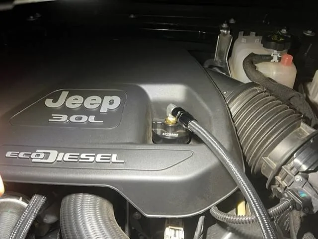

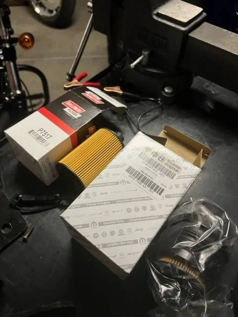

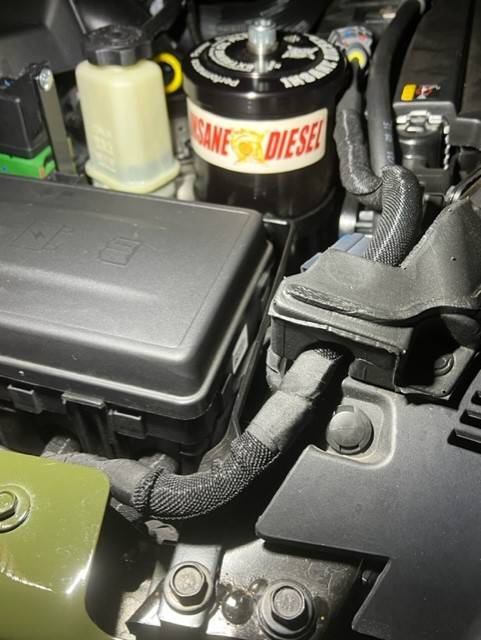

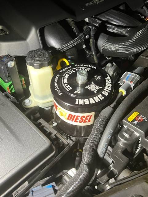

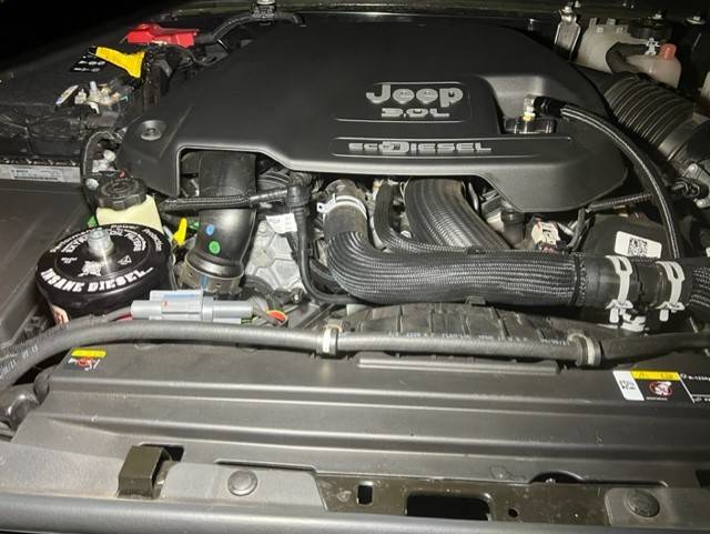

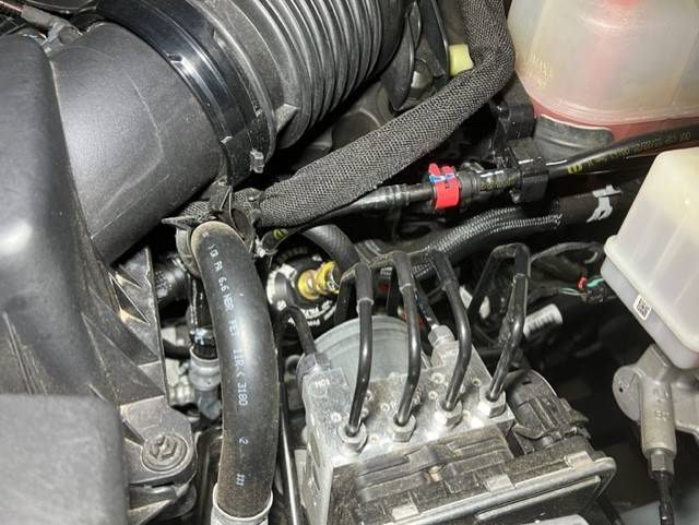

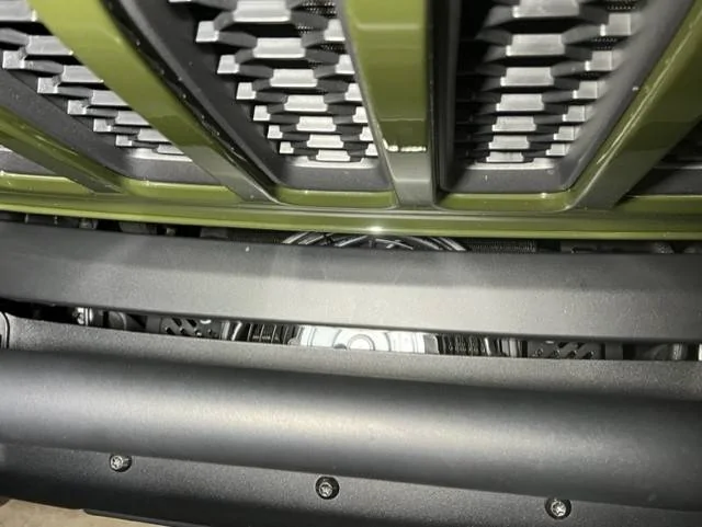

As for the truck cooler/filter configuration, see attachments. The kit was for the Ram, Summit Racing provided the fan/cooler, Bamazon for the hydraulic hose/AN 6 connection set. The fan is on switch group "4". Be advised, should you opt for the filter cap versus pressure sender tap, you must use the GEN 2 oil filter (Baldwin, as shown; both it and the current GEN 3 filter pictured.) Relocating the Glow Plug Control Module, power steering fluid tank, engine cooling fan high-current connector, and fabrication of a simple strut was required. Torque the secondary oil filter top TO SPEC, bring the engine up to operating temp, then allow to fully cool-down overnight, then check the secondary oil filter cap top again, tightening if needed. I keep a 3/8" hex in the truck just for that purpose.
The Insane filtration setup is in parallel with the lube oil circuit, in other words, it uses a portion of the total oil capacity per "circuit" run, not unlike an old "add-on" or OE oil filtration on engines from the 30's-50's, although the Insane setup is exposed to full lube oil system pressure. It is an excellent secondary oil filtration system, providing an effective means of oil cooling for my needs. I remove the decorative trim over the cooler when towing.

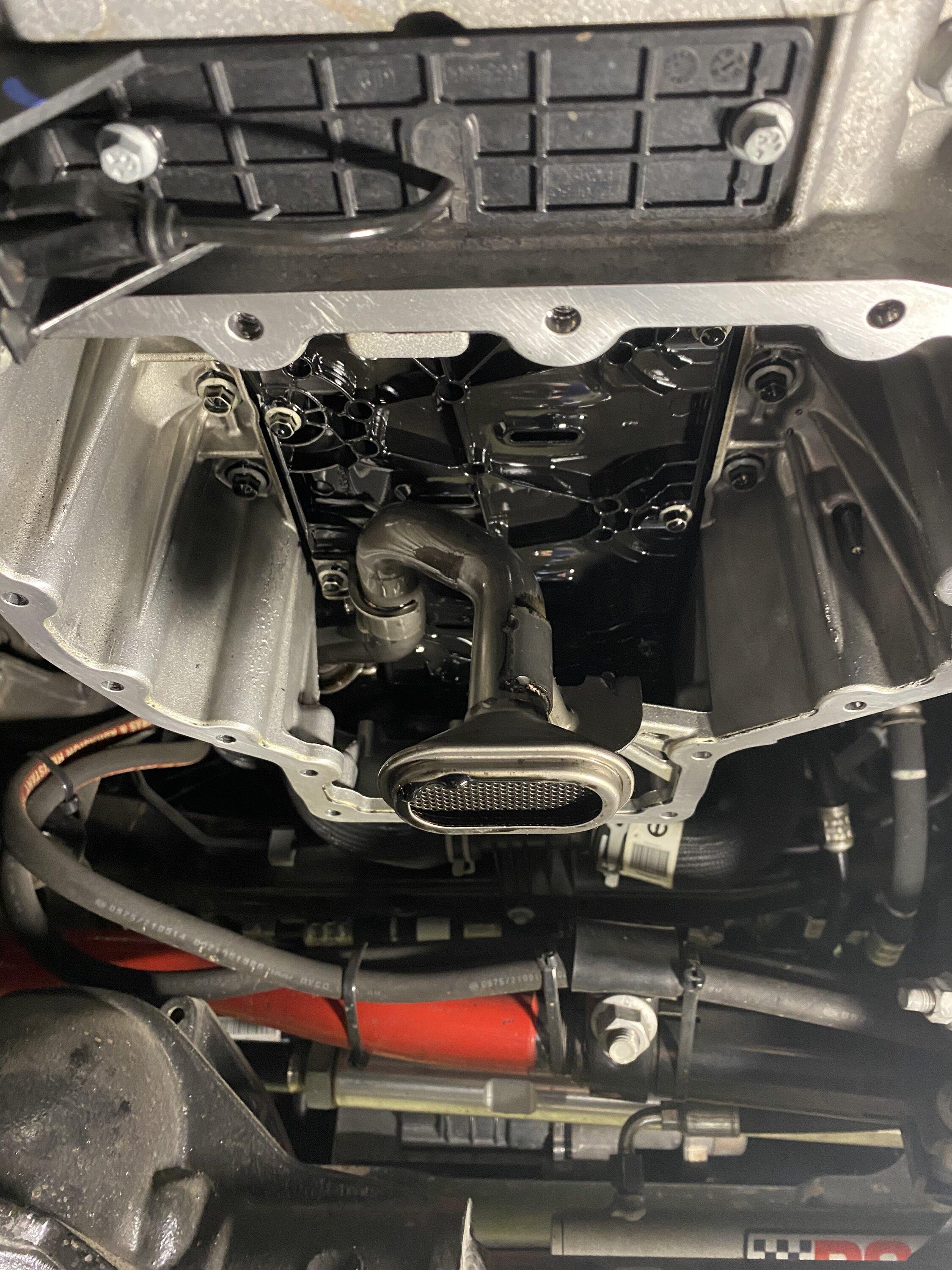

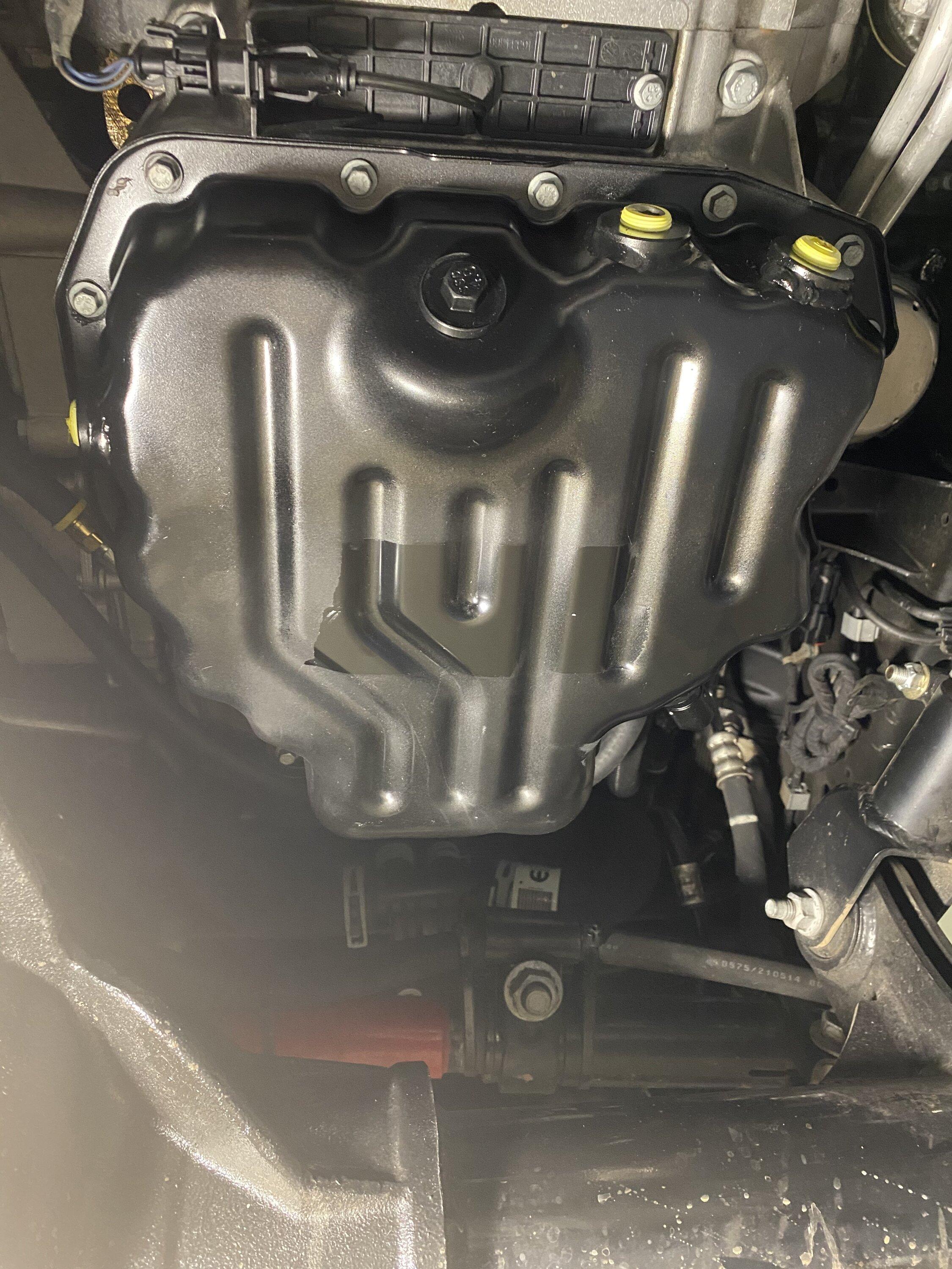

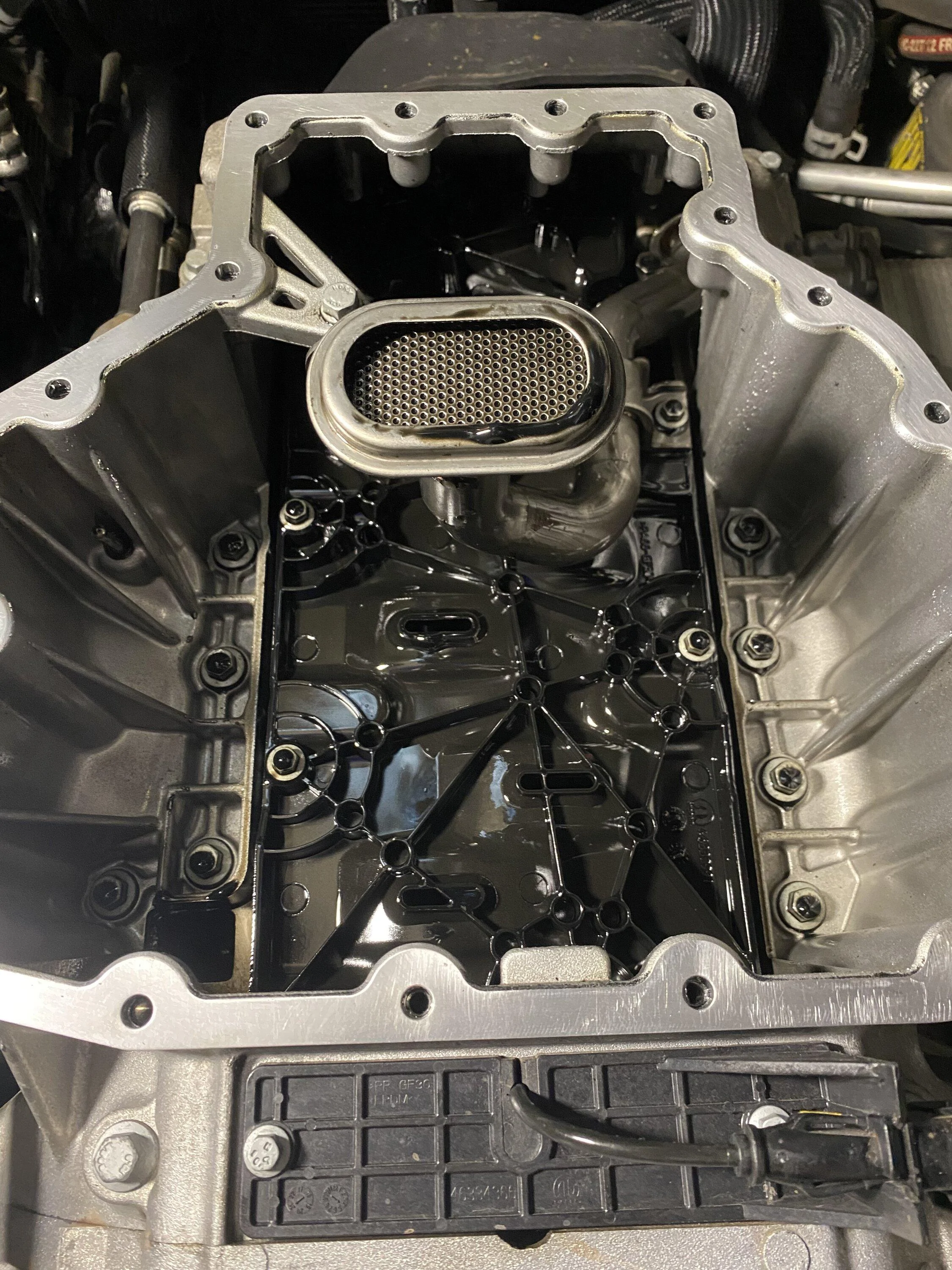

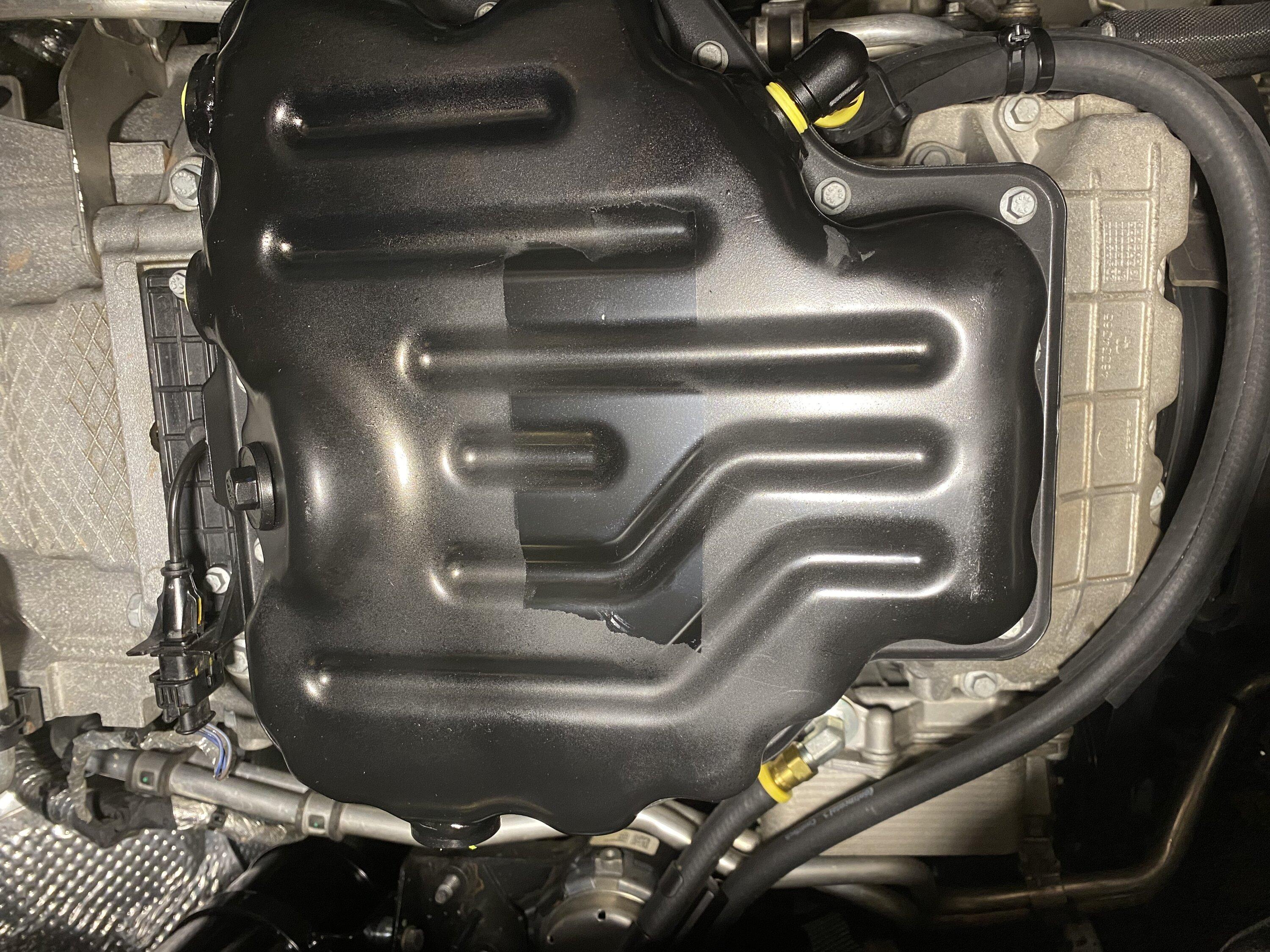

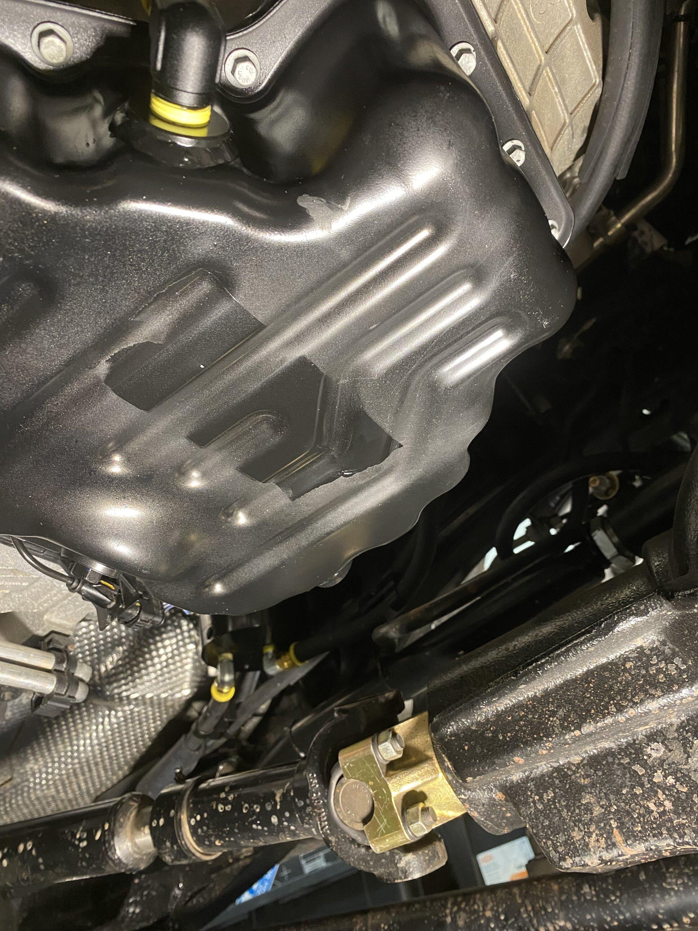

Bought a new oil pan. Added 4-3/8 bung for oil return from Insane/cooler line, future temp sensor and 12v oil pump with cooler if necessary.
I thought the return from oil bypass filter would be more efficient going straight into the pan.
So far seems very positive. Update with some real world info soon.
Update.
This is working very well. Haven’t seen an oil temp above 230* not towing. Before the mods 248* was normal peak. I have been driving it more aggressively with mods for testing.
I have also got to tow my trailer recently. Weighs about 4K. I did see oil temp peak for for less than a minute @242* doing 75mph up a mile long steep grade.
Temps above are with the oil cooler fan turned off. I haven’t needed it so I kinda forgot to turn it on when towing.
The fan on/off is worth about 7*.
I want to also say this EcoDiesel has lots power straight from the factory. Very impressed. Very happy.
