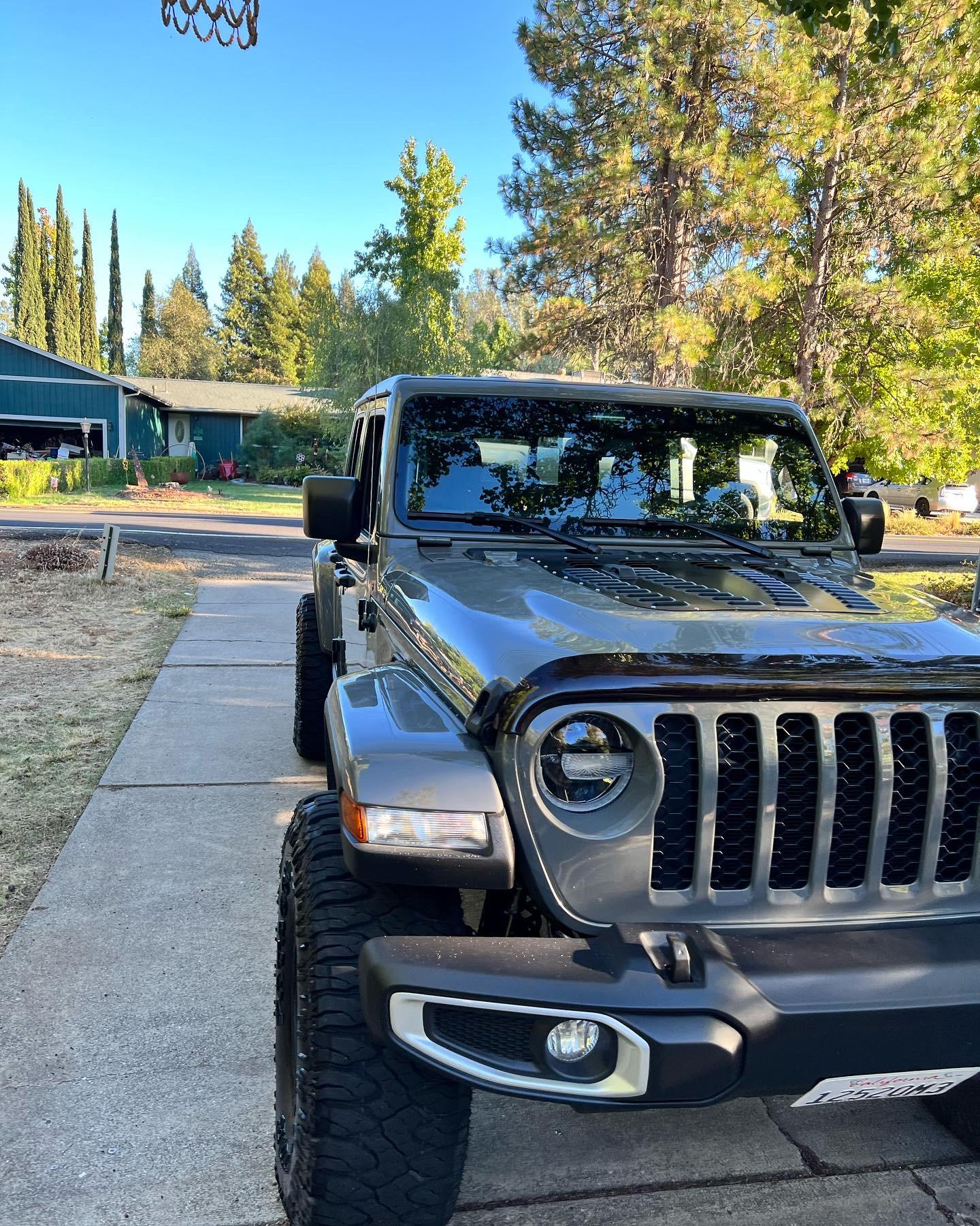

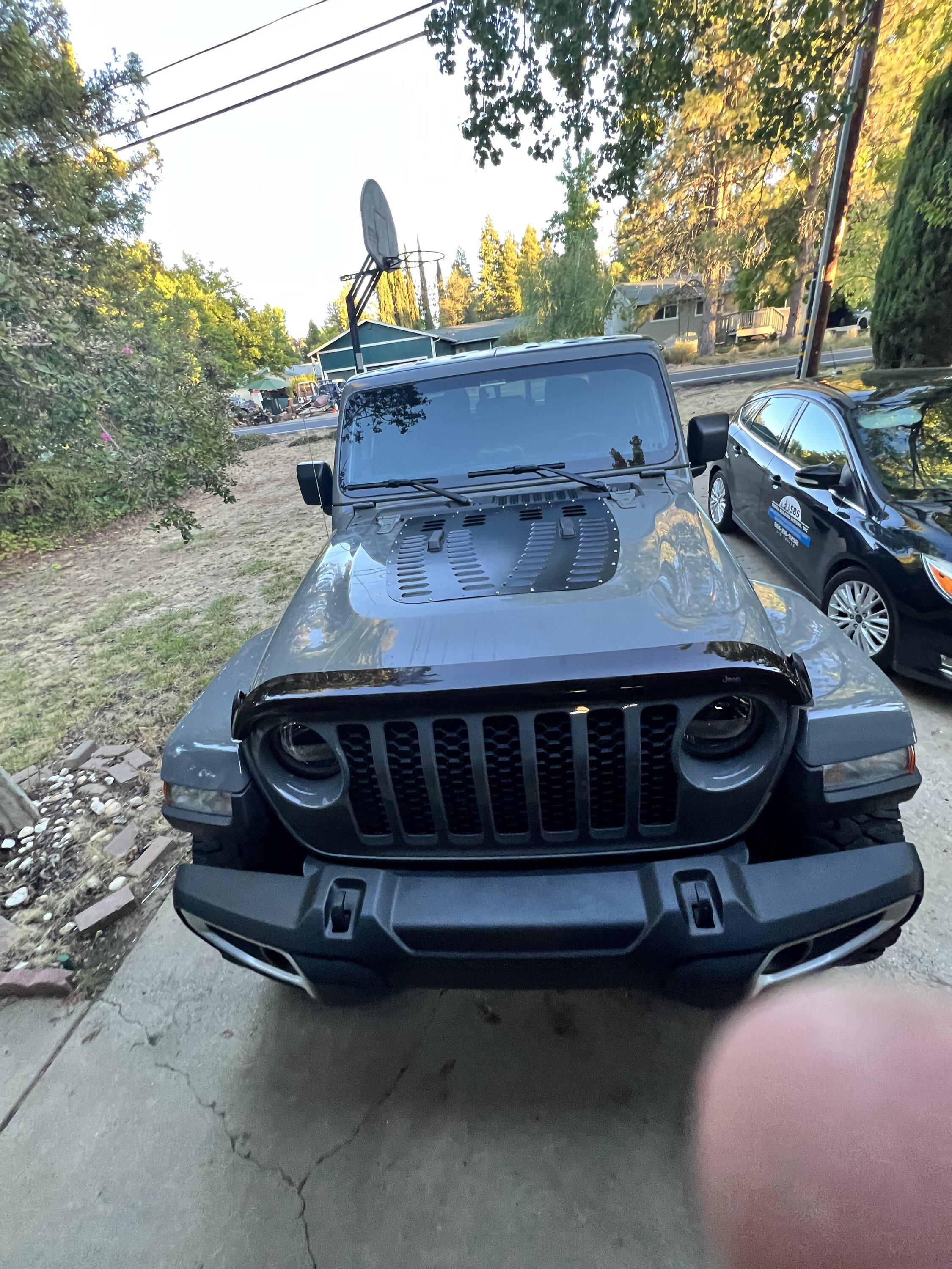

Added the poison spider vent. It was a pain in the ass and almost impossible to tighten the bolts without some warping
of the hood skin.

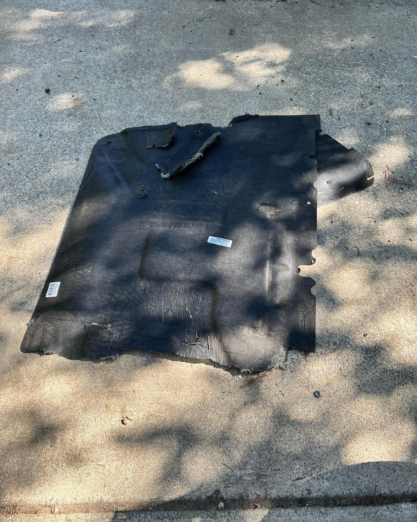

I also removed the seal at the rear of the hood on thecowl and two foam blocks at the cowl.
I have reduced the temp at the firewall by 30 degrees. Air comes out of the front louvers while the fan runs and also pushes a ton of hot air out of the gap of the rear of the hood.
I am not sure if it’s going to help anything as far as oil temps but hood venting and removing the seal and foam blocks definitely let’s air out.
I can touch the intercooler pipes and air intake and everything under the hood on a 90 degree day after a very hard drive.

So far the hood vent is AMAZING. I popped the hood it was 93 outside and I had just driven up the foothills and shut the jeep off. I can put my hand on anything under the hood.
When I went to install the hood vent i popped the hood two hours after driving and it was too hot to touch the prop rod or anything under the hood. Basically was insulating the engine bay.
Very happy with a $150 part.
