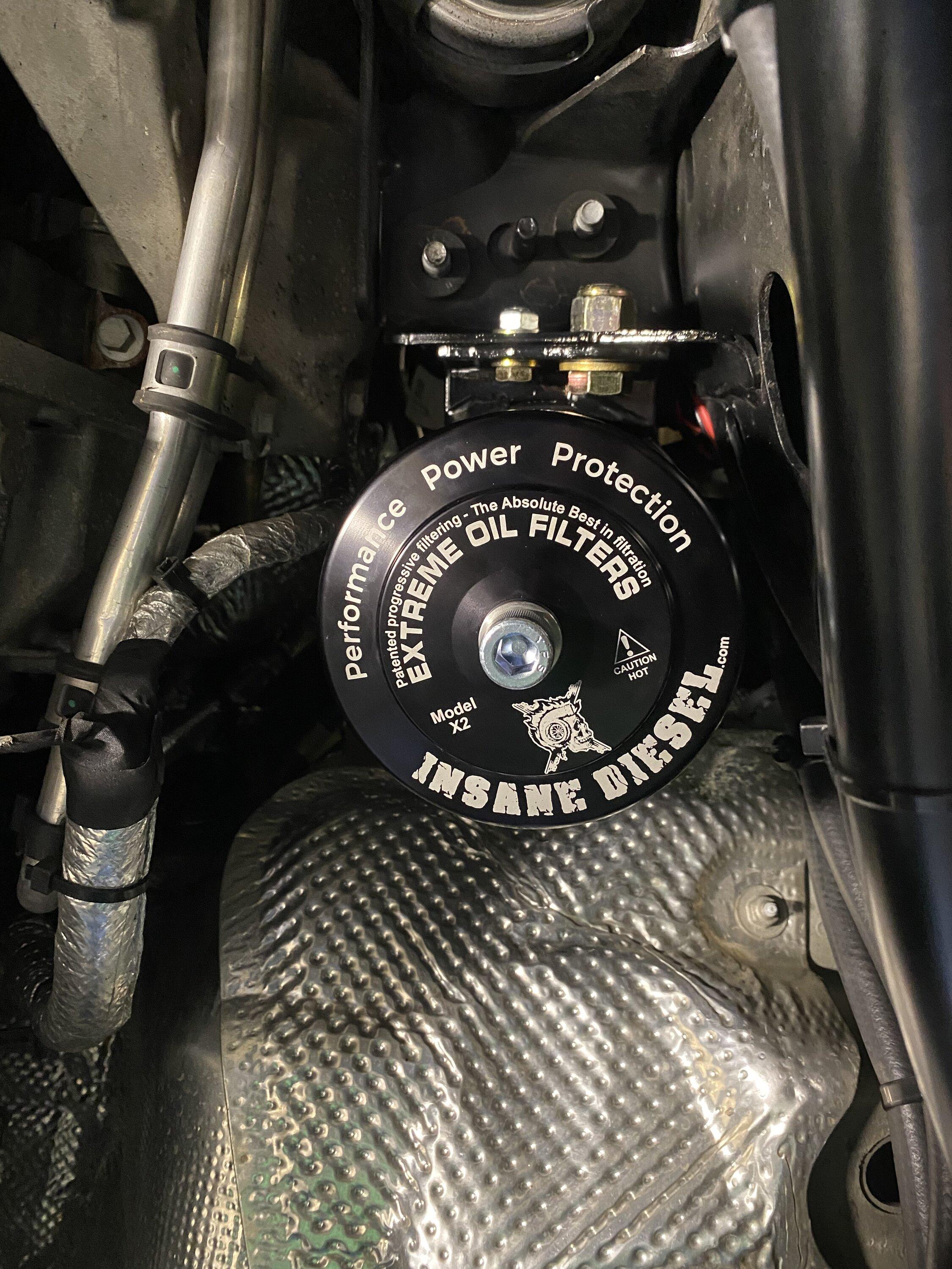

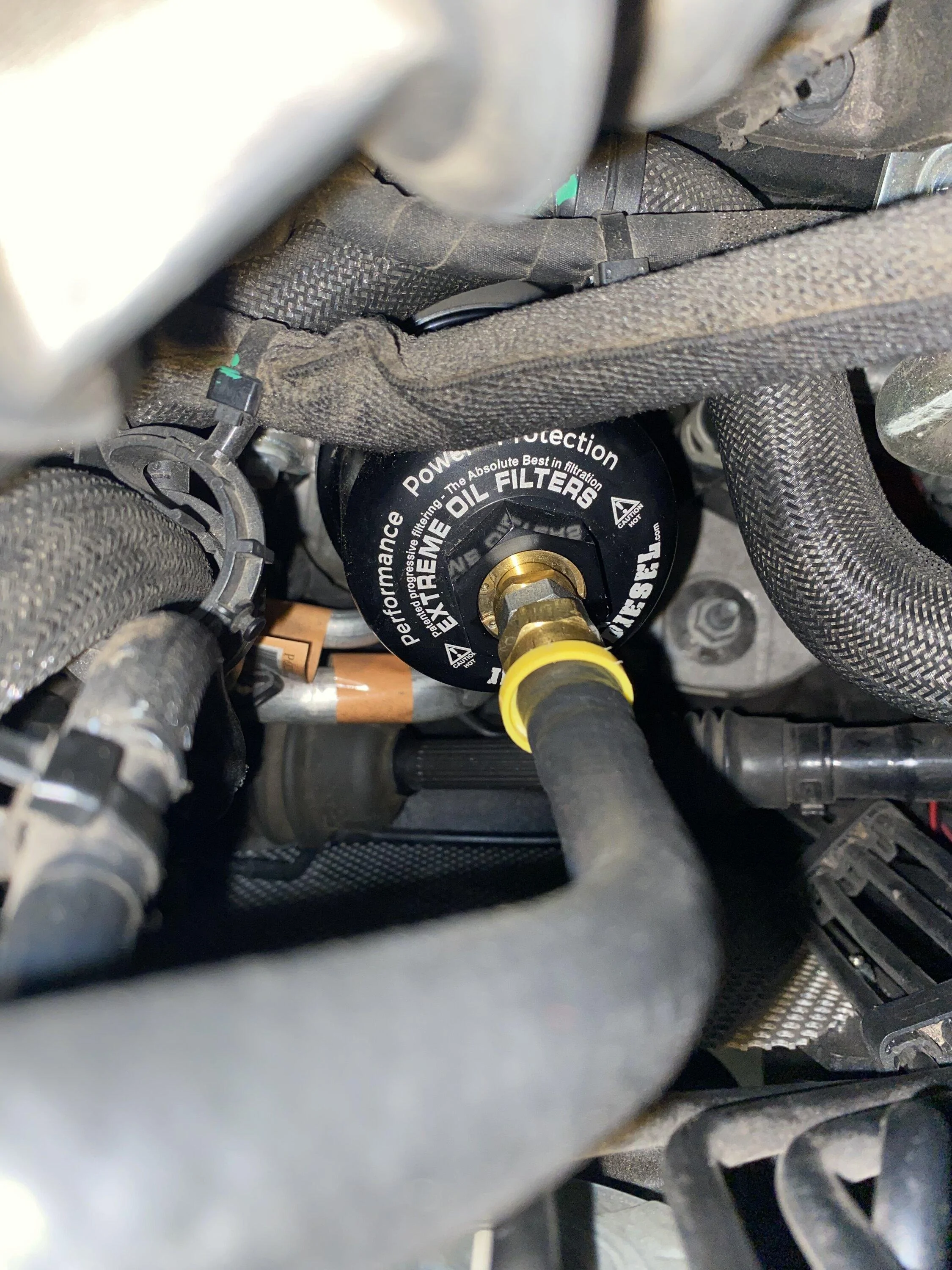

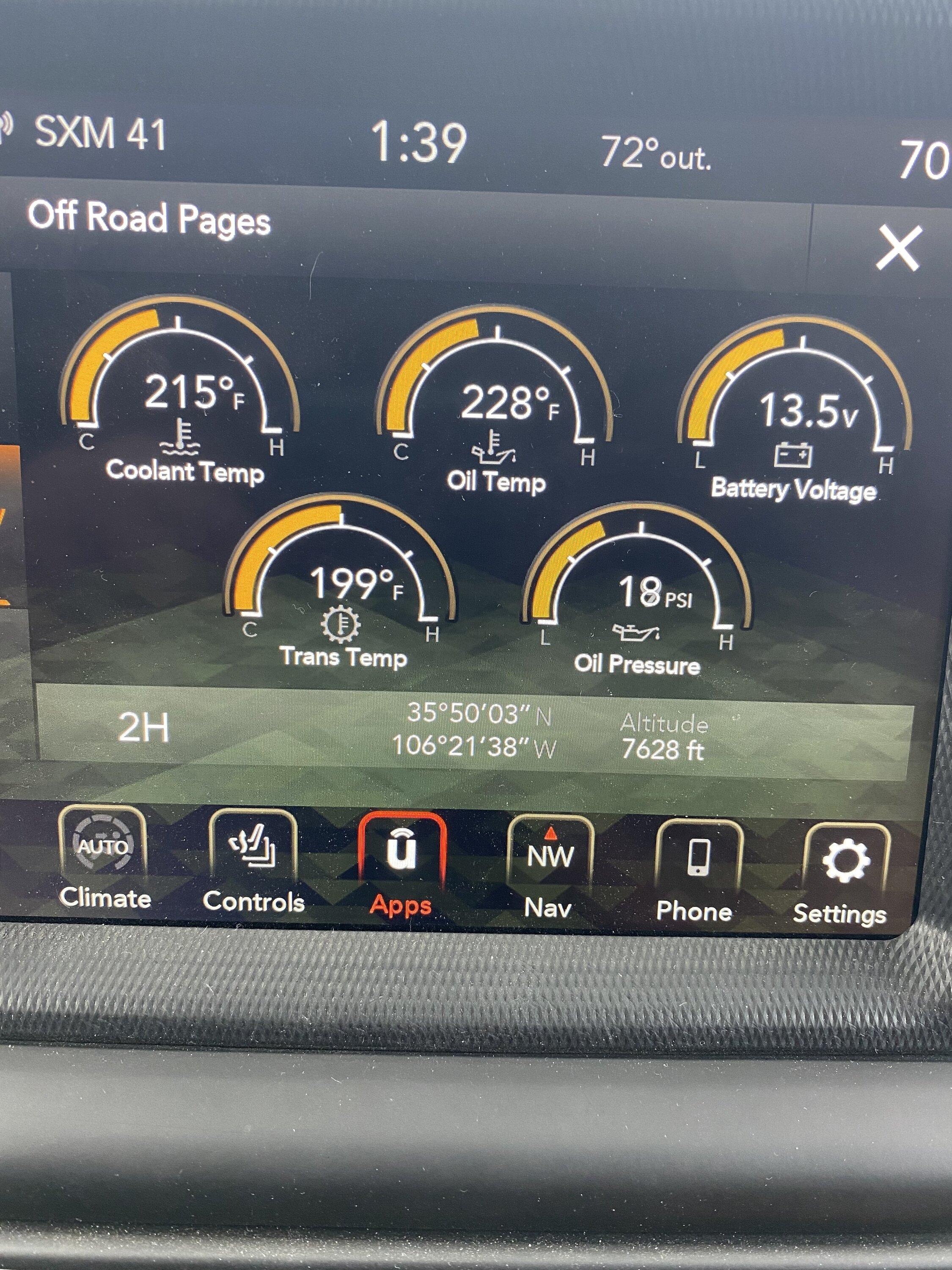

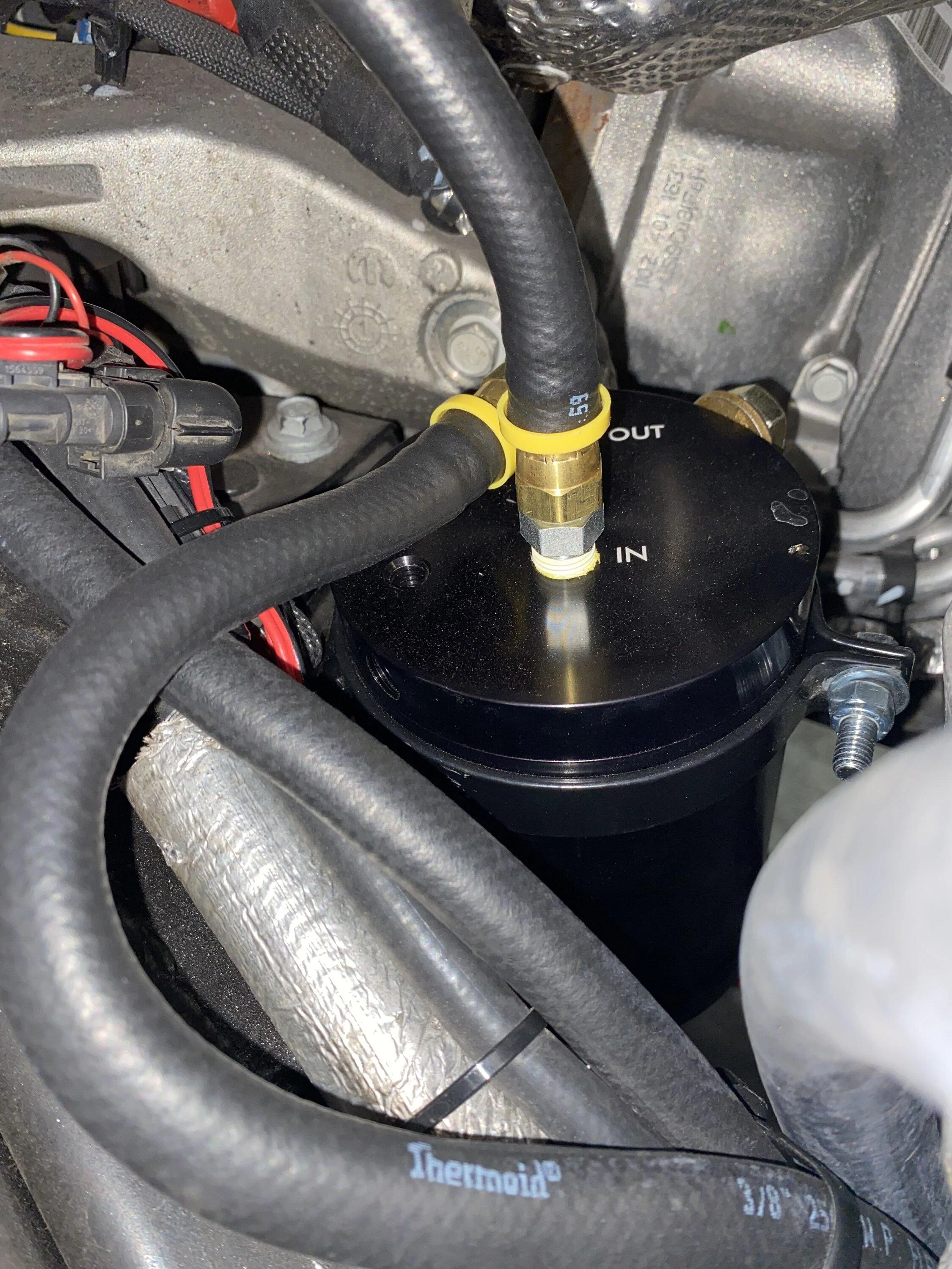

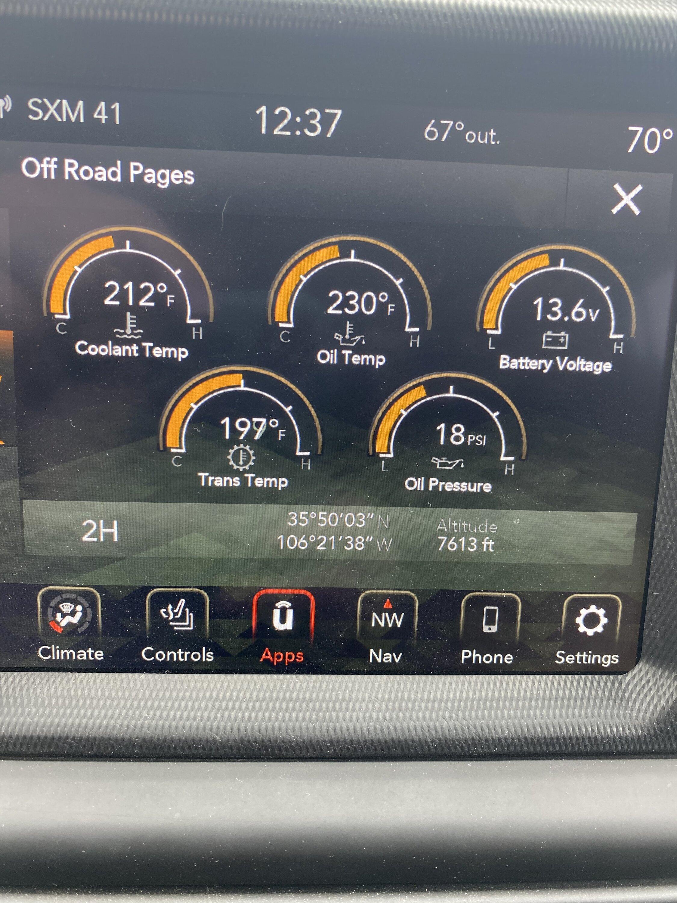

Got the bypass filter and cooler installed with a few hundred miles of comparison complete.

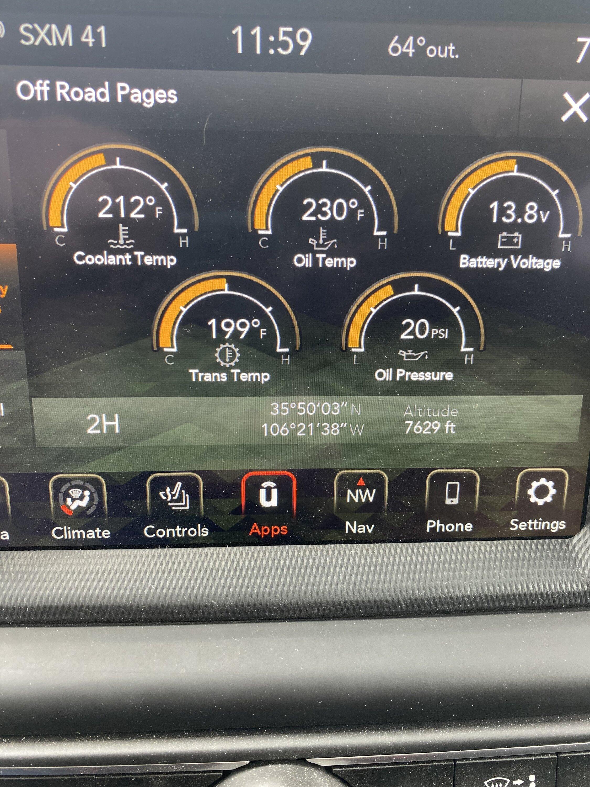

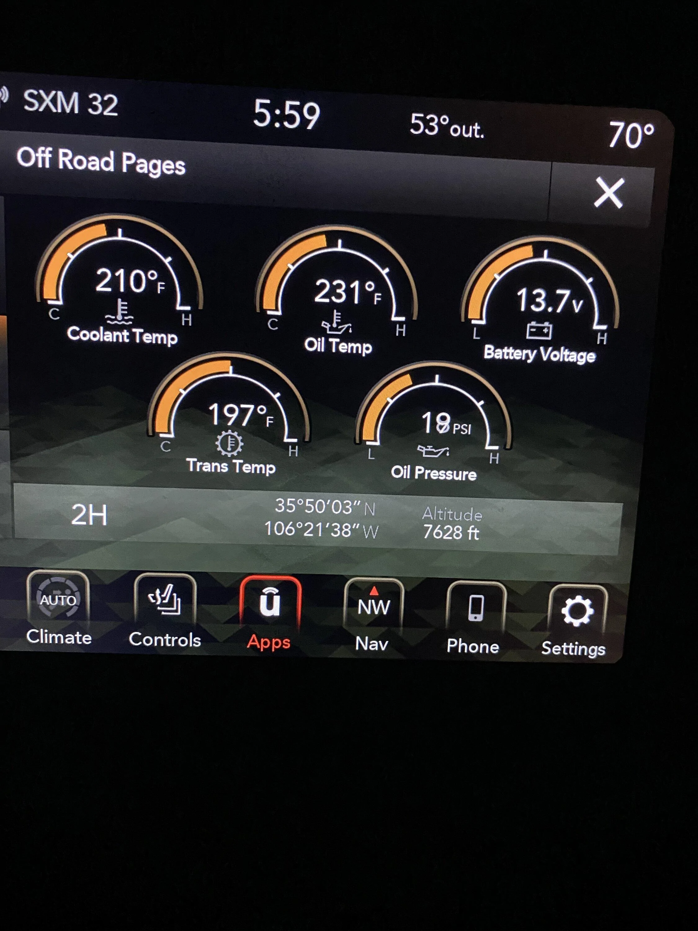

The first 4 pics were done after the exact same drive. Only difference is time of day. On this drive with factory set up I would see peek oil temp at 240*. The pics were taken after coming to stop. The drive is a gradual climb with lots of corners. Average speed is about 45mph
Factory
Bypass filter and cooler. No fan.
Edit. This pics is the last pic in post.
Bypass filter and cooler with Fan On.
Bypass filter and cooler with Fan On plus Water Wetter added to the coolant.
As you can see not much difference. The difference I saw while driving was the peek oil temps. The first pic was 240*, second pic was 237*, third pic was 235* and fourth pic 231*. The biggest difference was adding the Water Wetter to the coolant. Maybe the factory uses a not so “cool” coolant for the EcoDiesel.
Today we also did the drive that caused my first experience derating (National Forest). I derated due to hi temps causing many false sensor readings. Not specifically oil temp. When the derate happened I immediately started looking at oil temp for the rest of the trip home. Had to stop many times to cool off to get home that day. On this day the oil temps peeked at 248* and consistently showed above 240*. I traced this to wire harnesses directly above the power steering pump.
Today I never had a Peek oil temp above 235*.
The Bypass filter and cooler system has added 3 quarts of oil to the system. At 25 PSI oil pressure the flow rate is .75 quarts per minute.
The cooler is cooling the oil by 75* plus. I’m only estimating this by the fact that I cannot touch the oil pressure line leaving the engine, however I can touch and hold in my hand the return line and fill cap without issue when the engine oil is at 205*.
What cooler and fans are you using? Also how was this mounted?
I see this as a simple kit. .75 quart a minute sounds like pretty good flow. Hard to believe you are not seeing lower oil temps?
Derale cooler with fan mounted to underside of truck bed in spare tire area. Cut out tire carrier metal plates. Pics are included a few pages back.
The .75 is at 25 PSI. Cruising RPM flow would be a little more. Maybe a quart plus.
I was also surprised by the temp. However I’m very happy to see peek oil temps at 235*. Any more and I may get into a whole other set of problems.

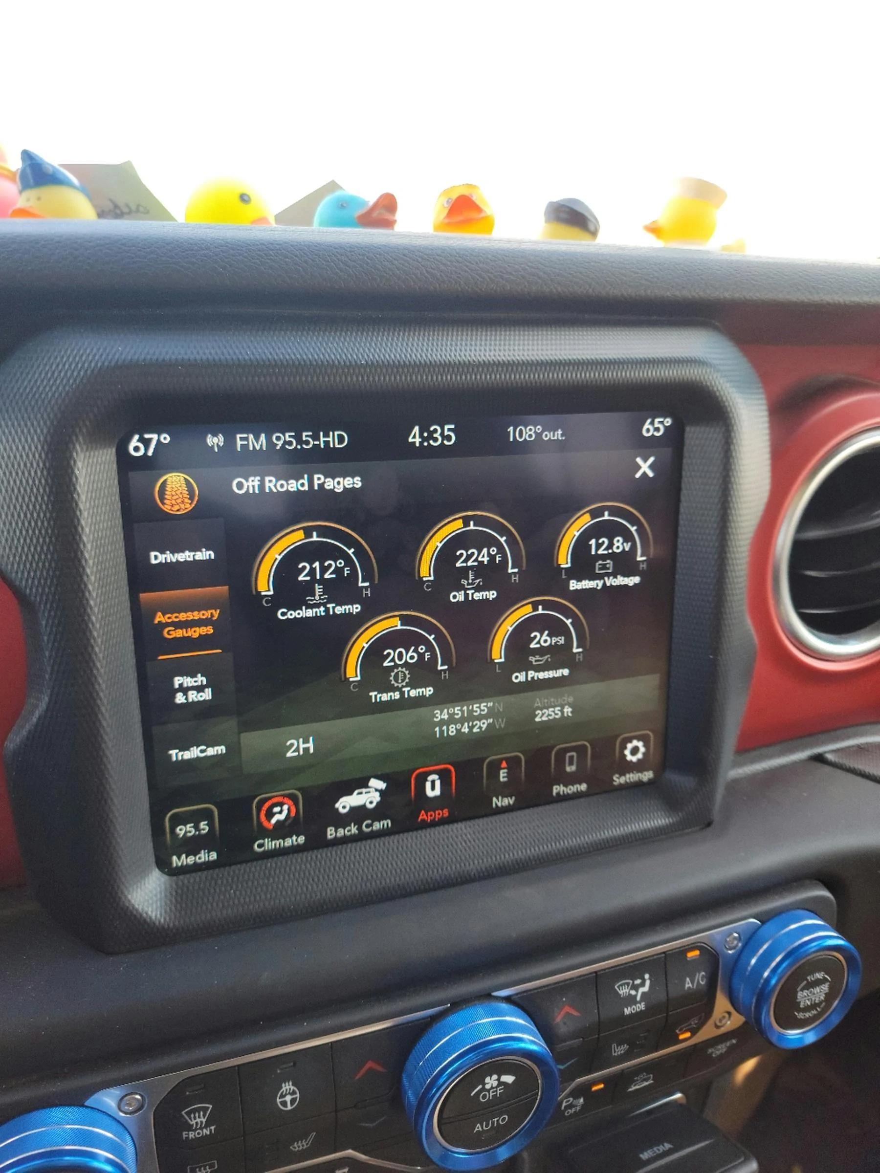

Bum

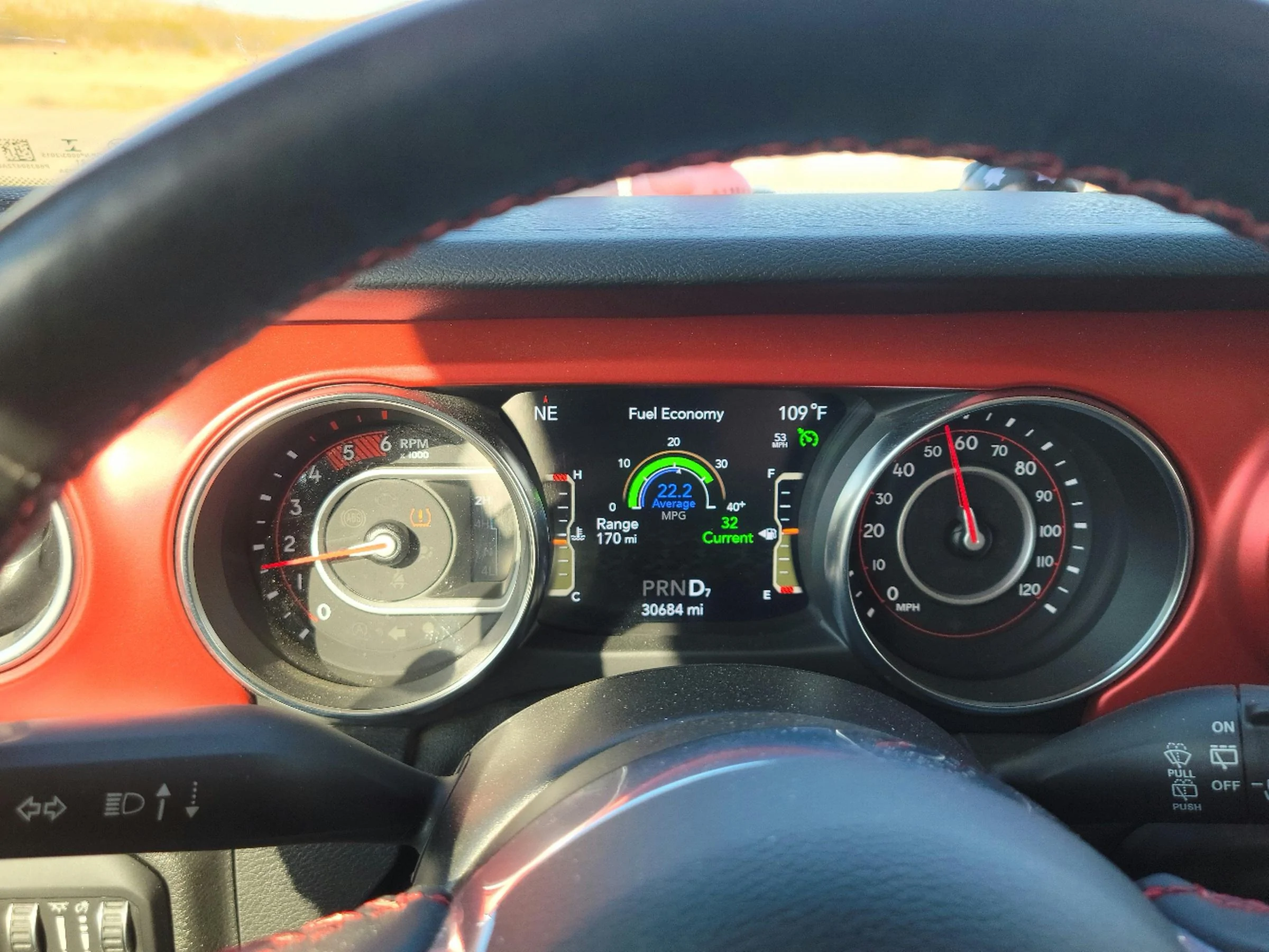

Took wife's JLURD to LAX from the high desert, on the way back, across the Edwards lakebed, it was 109⁰ outside and i couldn't do over 50mph.... lasted about 15 mins then returned to normal...
Noticed batt was not the normal over 13, until the power returned then it went over 13
There's nothing wrong with those temps on. Hot day tho. Wonder why it derated.
No clue.... the dash pic was after the power returned....
22EcoDs
Oct 14, 2021
1,513
1,684
NY
Air inlet temps?
I would think hot iat correlates to hotter oil because of the egr heating up too but I suppose it would cut boost and fuel due to lower air density at the hotter temps ? Making a true cold air intake would test this.
