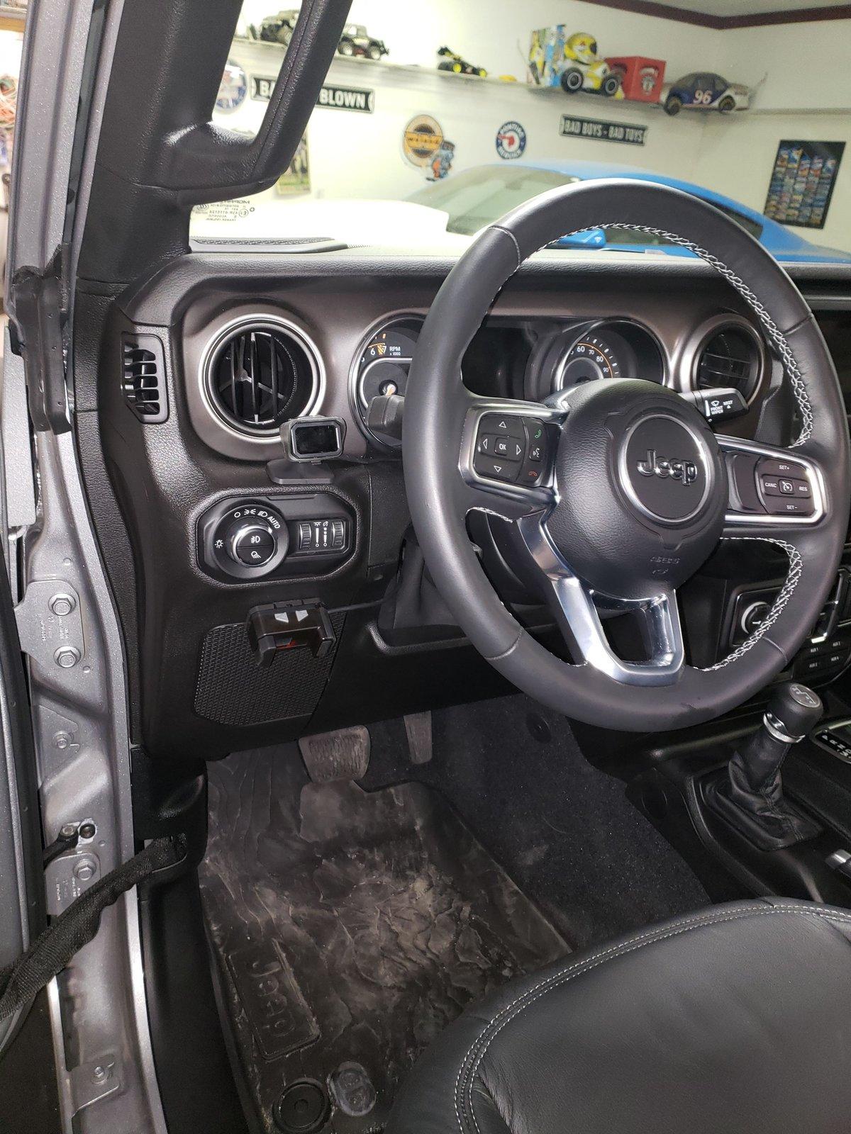

I have towed about 15 times with my Hopkins insight controllers, have not even missed my ram 1500 built in controller

Little display for the brake controller that you use to set your gain ND application rates and then it shows you the brake power being applied as you brake.

I'd like to know more about that one....... still sort of on the fence, would prefer to wait for the Jeep version but if there's something that's at least as good and fully integrates into the Jeep's system, I'm willing to look and listen.

I need to get pictures, but the install was pretty straight forward. Hopkins had a Wrangler JL harness that plugged right into the 4 pin under the dash. I used two super duty zip ties to secure it to the aluminum substructure in the kick panel, then used 3M double sided tape to mount the display and slider. It has 10 brake profiles and you can adjust the gain for each one. I have Dexter 12 inch brakes on all 4 wheels of my trailer and profile 3 with 80 percent gain stops it like it is part of the jeep, even if I have to slam the brakes.

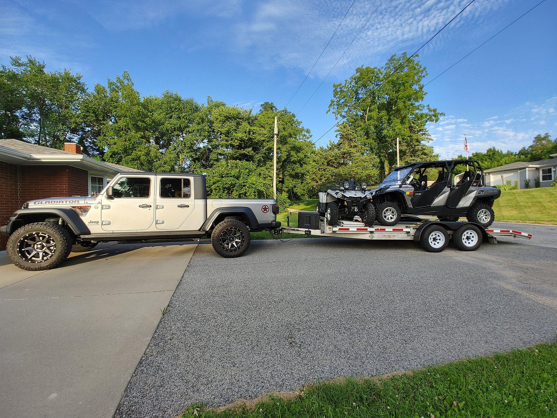

Aluminum trailer? Looks similar to my Aluma trailer but then also resembles another made here in Iowa.
That is a controller that may be worth considering if you have that good a luck with it and I like the idea of the display.
DAVECS1
David
Jan 24, 2020
56
1,861
2,516
Peoria, IL
Trailer is an H&H, I think they are made in Iowa. It is not a bad trailer. I would say Aluma is a step above. The super structure is solid but the metallurgy and welds for the add on stuff is not as good as I would like it. I have been slowly replacing things with grade 8 bolts and stainless. I made new fenders cause the aluminum one cracked up. Need to be supported with less flex. Sorry to get off track everybody lol!
