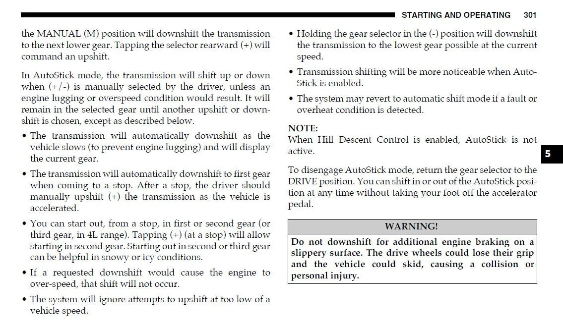

As far as manual shift mode goes, my understanding is that this simply allows the user to have more control over which gear the truck is in. The computers onboard can and sometimes will still over-ride your decision to protect the drivetrain, but it gives you more control. What it does not do is affect the way the torque converter operates.
A person can do more damage while towing using the manual shift mode than they can do using normal "drive" mode.

Brake Controller? Correct me if I am wrong, according to the Owners Manual while towing you are to use the manual shift mode this will also be the same as the Locking In your transmissions torque Converter, Otherwise you risk transmission slippage or possible damage.
So why would the owner's manual say otherwise?

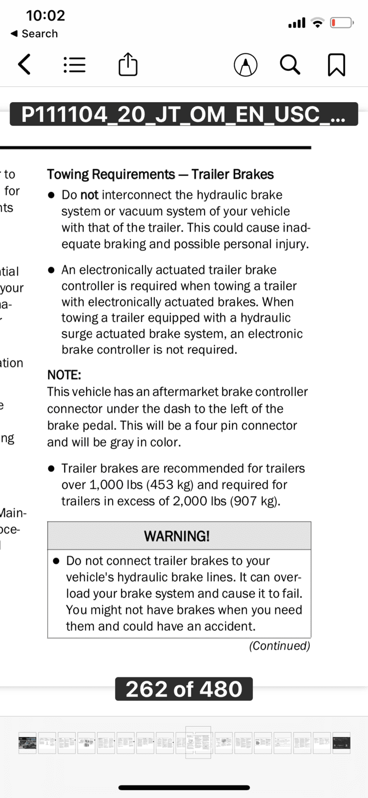

Here is what the owners manual says about trailer brakes /trailer brake controller.
I don't know which version of the owner's manual you've got, but I'm looking at version 2 and the manual shift mode is described exactly how I described it in post #80. It gives you more (not complete) control over which gear you are in, but it does not provide manual control of the torque converter. Also as noted, it's possible to lug the engine if using manual mode (which the software will attempt to prevent per page 301 in the manual) and so it's more easily possible to damage the engine in manual mode. In normal "drive" mode, the vehicle computers will never even let you approach the point of lugging the engine.

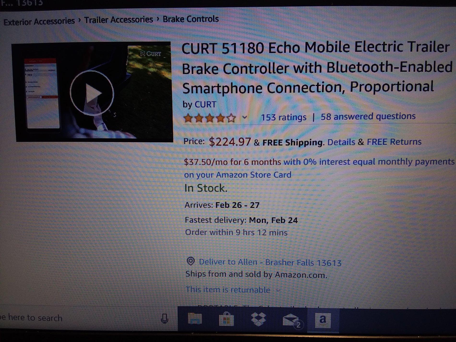

Thank you for the clarification.. Do you think this controller will work? Only name and part number here, the video explains its Bluetooth setup.

I watched and liked your video to install in your cab the brake controller.
I have the Curt 51180 controller in route through etrailer right now. I like the plug-and-play aspect. Then when Jeep comes out with their promised brake controller I would see if I would prefer that better.
Nice installation I'm happy that it's working for you.
