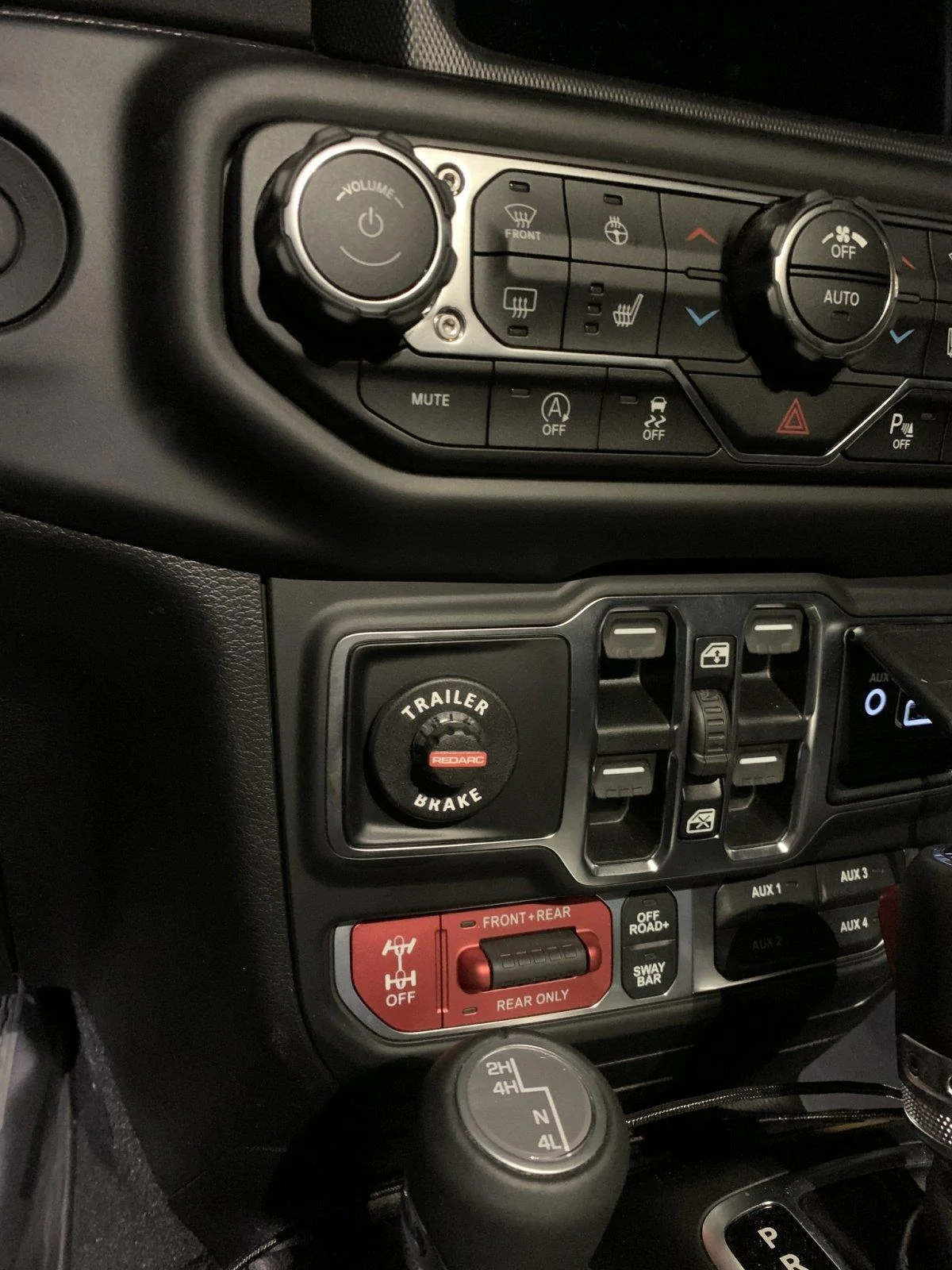

Couldn’t wait anymore in Canada:
Ordered a Tekonsha connector - 3024-P
Swapped the black and blue wires and connected to factory plug under dash.
Connected to Primus IQ
Works perfect and I’ll wait out the storm for the factory install in lighter socket.

I use the lighter socket for a plug that runs to my Valentine and has two USB ports to charge cell phones. I would not want to give up all that. Glad I got Curt controller and harness [for a Ram, swapped black and blue] a couple months ago. Still can't figure why FCA changed the pin positions for power and brakes (black and blue) on the JT, but use the same connector as the Ram.

@WXman did a good video on the install of the controller and wiring, but he mounted his control knob in a different location. There are some write ups with info on putting the control knob in place of the 12V outlet. I did myself and really pleased with it.
