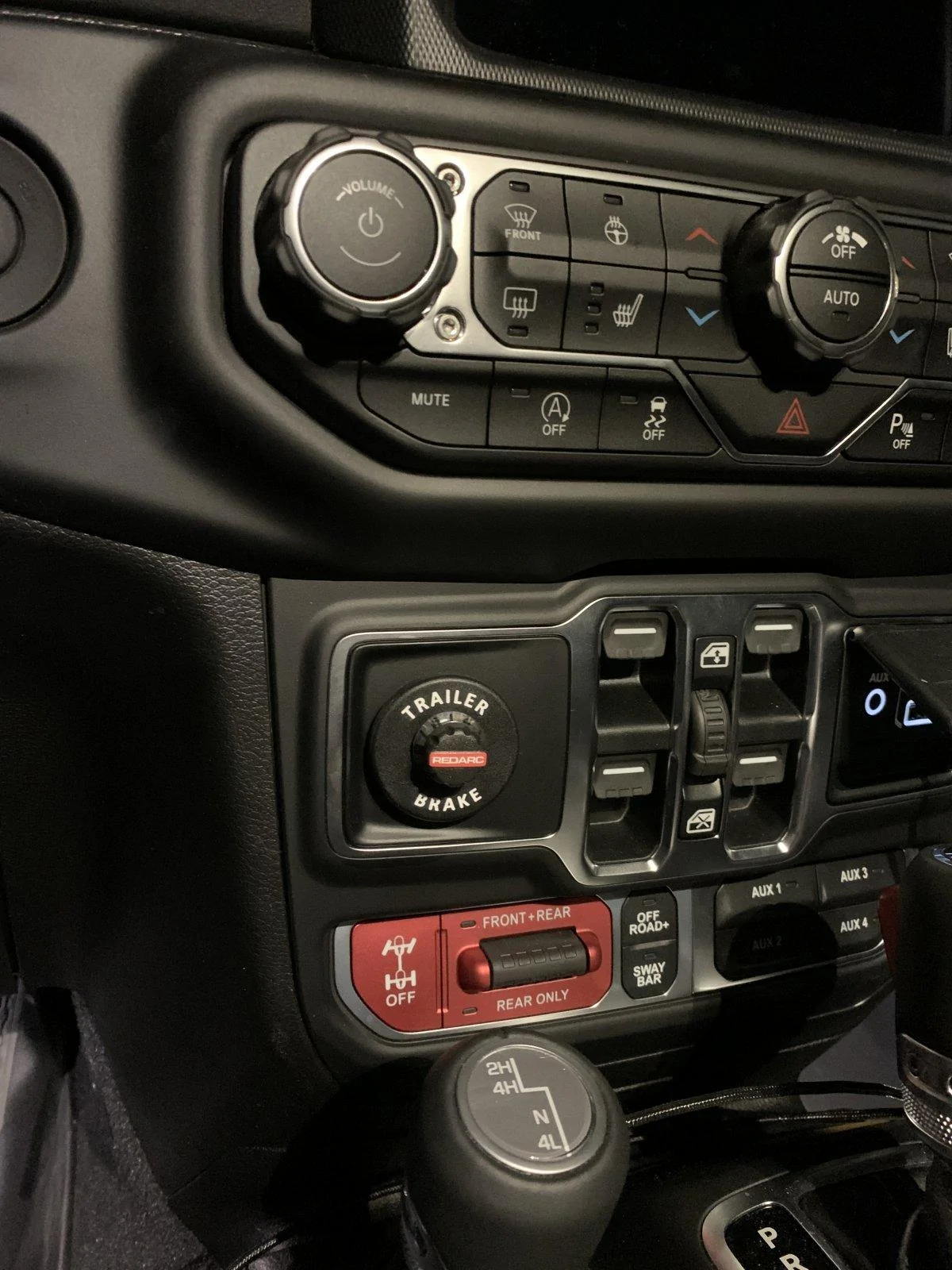

Where is the best place to put the dial control? I was thinking about the center console but that doesn't look to easy. Where did you place yours. My parts arrived today and i just finished the blue black swap.
I replced the 12V outlet myself because I wanted it in the factory spot and never really used it.

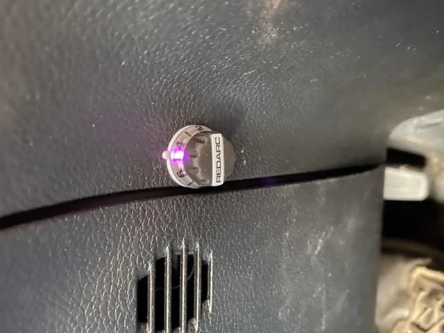

Jeep Gladiator Finally available! > 2020 Jeep Gladiator Accessories - Trailer Brake Controller - 82215652 2CE46933-26C5-48F6-9D12-C66A37403C7E
Here’s where I put mine it’s right above my right knee! I like you thought about the center console but didn’t want to mess with it that much!

I used the 12V power port location as many have. If you get the removal tool from amazon (doorman) it will remove the port without taking the dash apart. I removed the outlet, slid the wire back and snapped my knob in. Took longer to swap the Blue and Black wire than getting the controller installed.

Interesting how @sarguy1941 just removed the socket and put the Redarc lead right in the hole.
If you use the snap in adapter in the post above there is no reason to get behind the dash. I just used a fish to pull the wire under my steering wheel and mounted the controller to the cross base as others have. If you use the snap in you do need to make a new "slot" in the dash. I just used a small file. The controller mounts to the snap in plate and you snap it in just like the power port snapped in. One of the other threads also shows a Oring you can install after that "fills" in the gap from the dash to the snap in.
