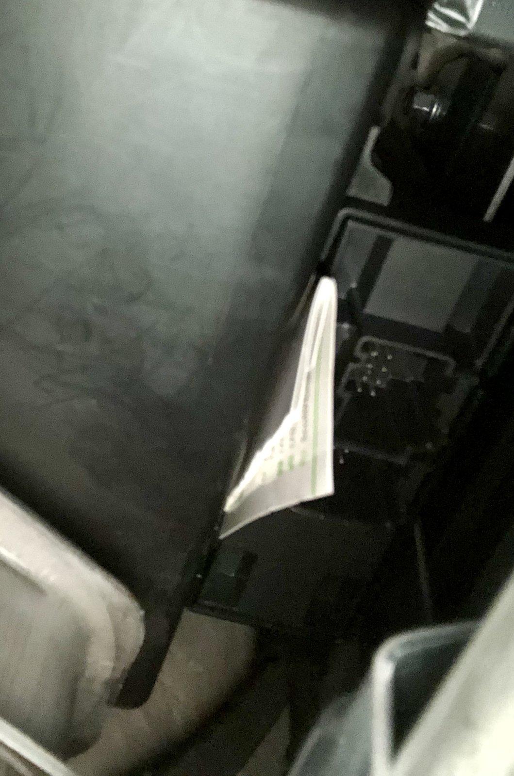

Another Minor update, turns out after a bit of digging this has nothing to really do with the audio system, it's a flaw known on JL and JTs, the security box thing behind the speaker under the dash causes a vibration, the fix is to make it stop moving it by taping, shimming or gluing it into place.
Replacing parts and speakers won't fix the problem, it's a design flaw with the JL and by extension JT interior. The JL guys have been dealing with it for years now, however the dealership is unlikely to want to fix this because one of those STARS article things exists about it.
the dealer solution is to pretty much pull the dash apart and pull stuff out to insulate it against vibration, however included image is a known working fix for this problem, yes that is a business card folded a couple times and jammed into a gap to snug up the box....that legitimately is a fix to this.
My feeling on jeep engineering is slowly nose diving.
(Photo Credit: Saddle Tramp on the JL Wrangler forum)

Probably why some of us feel some deep bass sounds in the steering column at higher volumes. Didn't notice it until the roof was off and I had the sound cranked over 20 just to hear it. Was listening to a McCartney tune and he hit some nice bass and I felt it in the steering column.
They are cramming a whole lot of stuff in these tiny dashes.
Look at the HUGE dash in some vehicles and how far back from the glass you sit to get the hardware and electronics all crammed in there - not nearly that much space in a JT dash, so they have to put things really close together. Worse in some models than others - same reason some of us have trouble getting the security cables out of that firewall to make changes.
Come on guys - seriously? None of you had an 8 track in your second car and had to use a match book cover or business card to make the cartridge play properly? This is nothing, no big deal.
I assume it's only a problem to a younger person.
I grew up doing things like that.
Me, I'd pull out the old tape backed foam and stick a chunk in there -

So the dealer was right............it was not the speaker vibrating.
