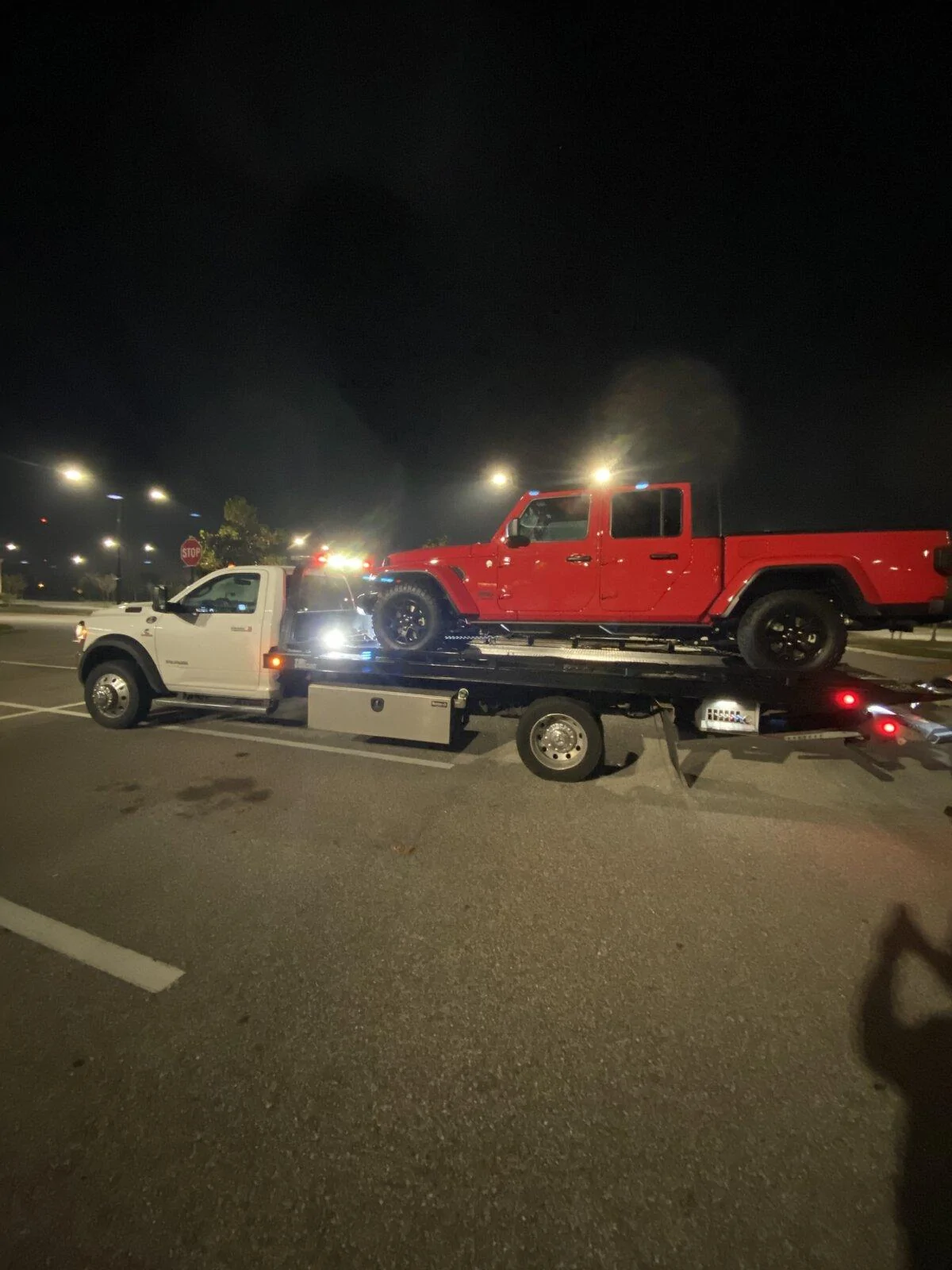

I was heading to work in my brand new 2021 jeep gladiator with 3000 miles on it check engine light came on flashing and motor started to vibrate and run rough had to get a tow and was late to work on the day I have an interview for a promotion @JeepCares

What engine do you have?
What's the weather like?
Did you recently add fuel?

A flashing MIL is normally a severe misfire that can cause converter damage. It's good that you had it towed. Something that severe should be fairly easy to find.
