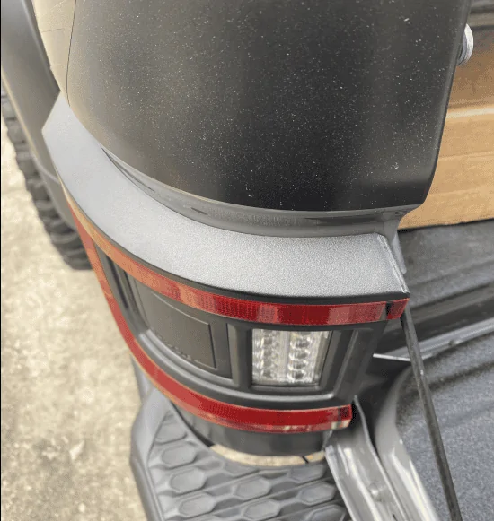

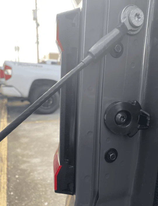

I haven't read through all the post, I installed mine and ran to the hardware store for double stick tape. when I got home the resisters were really hot, not sure if that is normal.

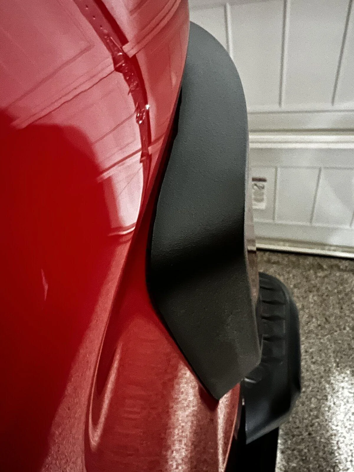

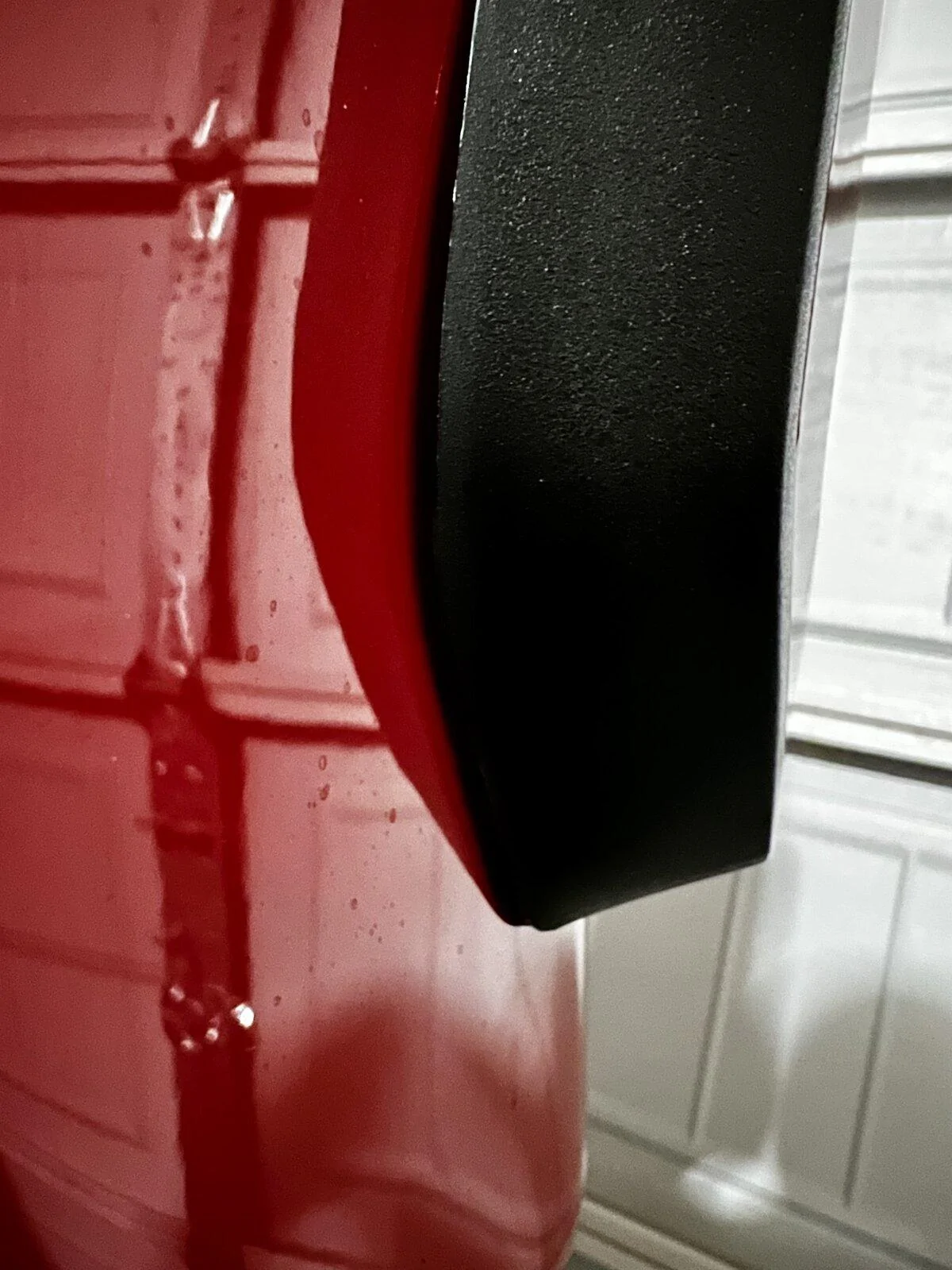

Just to re-iterate other feedback about fitment, The passenger side light fits great but there is definitely something up with the drivers side. I tried bending the interference point with the screw out of the way and just cannot get the drivers side to fit as great as the passenger side does. I don't know if this is a mold issue with the drivers side lamp or not. It's hard to convey this is pictures and doesn't stand out as much as it actually does to the eye. If you look close enough, you can actually see how poorly trimmed the drivers side top edge looks compared to the passenger side.
I'm mainly posting this (as some others have as well) for Oracle's benefit as they might want to check some QA on the drivers side light from the manufacturer.
Drivers Side. The darker area right up against the body is the shadow of the gap. No amount of maneuvering seems to be able to take this out. It's not huge, but it is noticeable and compared with how great the passenger side fits I can't help but think there is some mold issue.
Looking down from the top of the drivers side light:
Jeep Gladiator Flush Mount Tail Lights IMG_6353
Looking up from the bottom of the drivers side light:

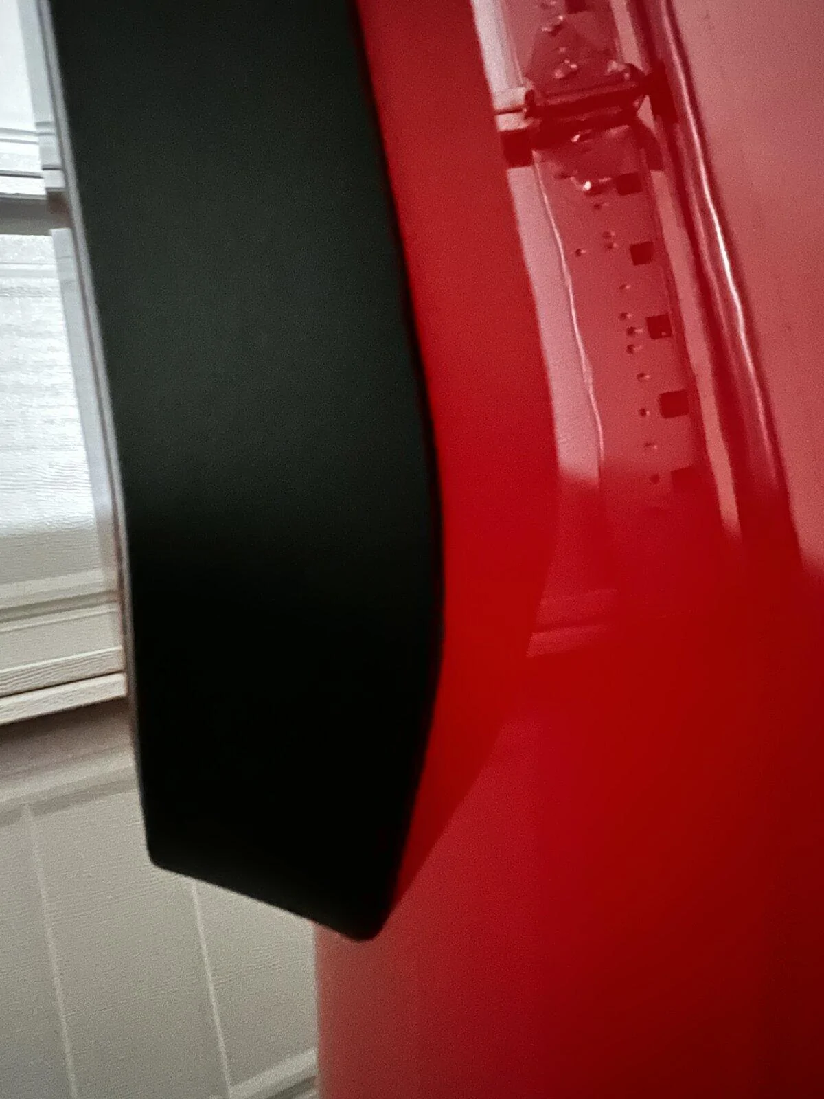

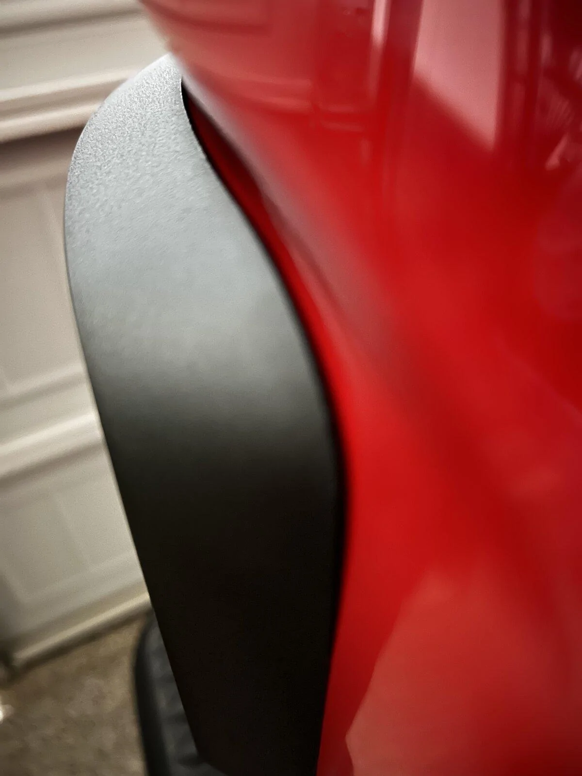

Passenger side. Notice how there is nearly zero darker area right next to the body. There is zero gap between the lights and the body on the passenger side.
Looking down from the top of the passenger side light:
Jeep Gladiator Flush Mount Tail Lights IMG_6356
Looking up from the bottom of the passenger side light:
Jeep Gladiator Flush Mount Tail Lights IMG_6354

JP from Oracle had gave the heads up that they are expected to get hot.
Hey guys,
Those resistors get really hot when the turn signal is in use, so you definitely want to avoid keeping that around any wires or plastic. This is why we mount it inside of the cavity.
Same story on mine. Driver side fitment is definitely worse than the passenger side.

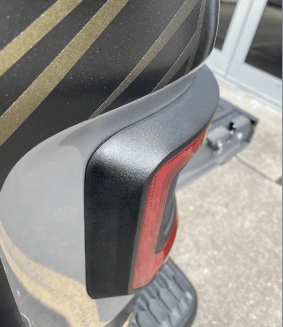

You just need to resettle the tail here. Loosen the top bolt, press the tail into place where you need, then tighten the bolt while held in place. Repeat on the bottom.
Here's some pics of the LH on ours showing a clear difference when this is done:
