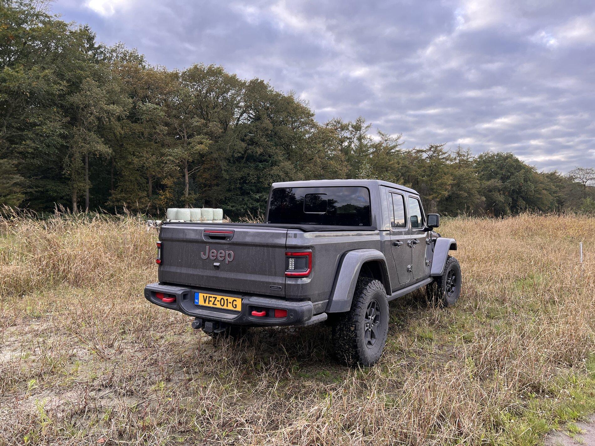

Hi, I am Hans Tadema from the Netherlands. I received my Oracle Flush Mount Tail Lights yesterday and installed them immediately. My Gladiator is a 2020 Rubicon with full LED. Installation was a piece of cake. However: when I start the engine (and also sometimes during the ride), I get the warning that my turn signal is not working. The blinker on the dash is flashing rapidly. It still looks like the actual turn signal is operating properly … But for somebody who’s a little bit autistic, dashboard warning lights and error codes are horror …
Jeep Gladiator Flush Mount Tail Lights A598F198-CB49-4339-BF27-73FD847C9FE5

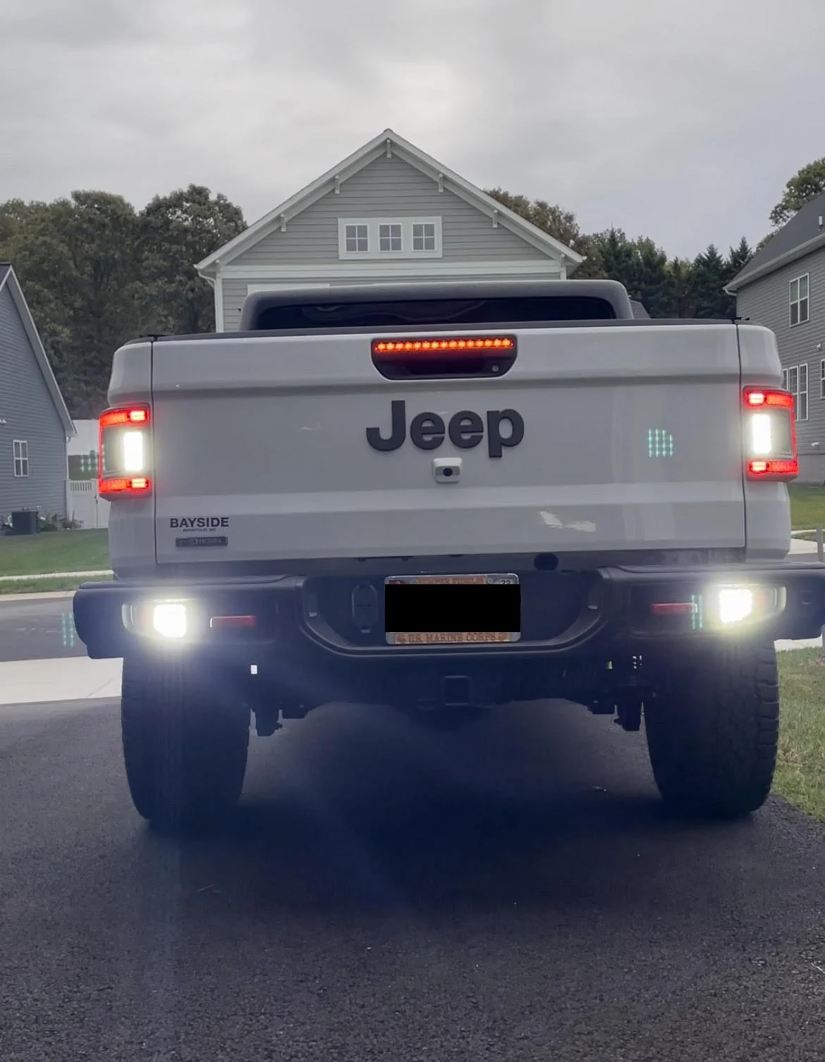

Installed last night. Honestly, the worst part was disconnecting the original tail light harness. Blinkers sound faster in the cabin, but appear to blink the same speed on on outside.
Jeep Gladiator Flush Mount Tail Lights oraclejtbackend

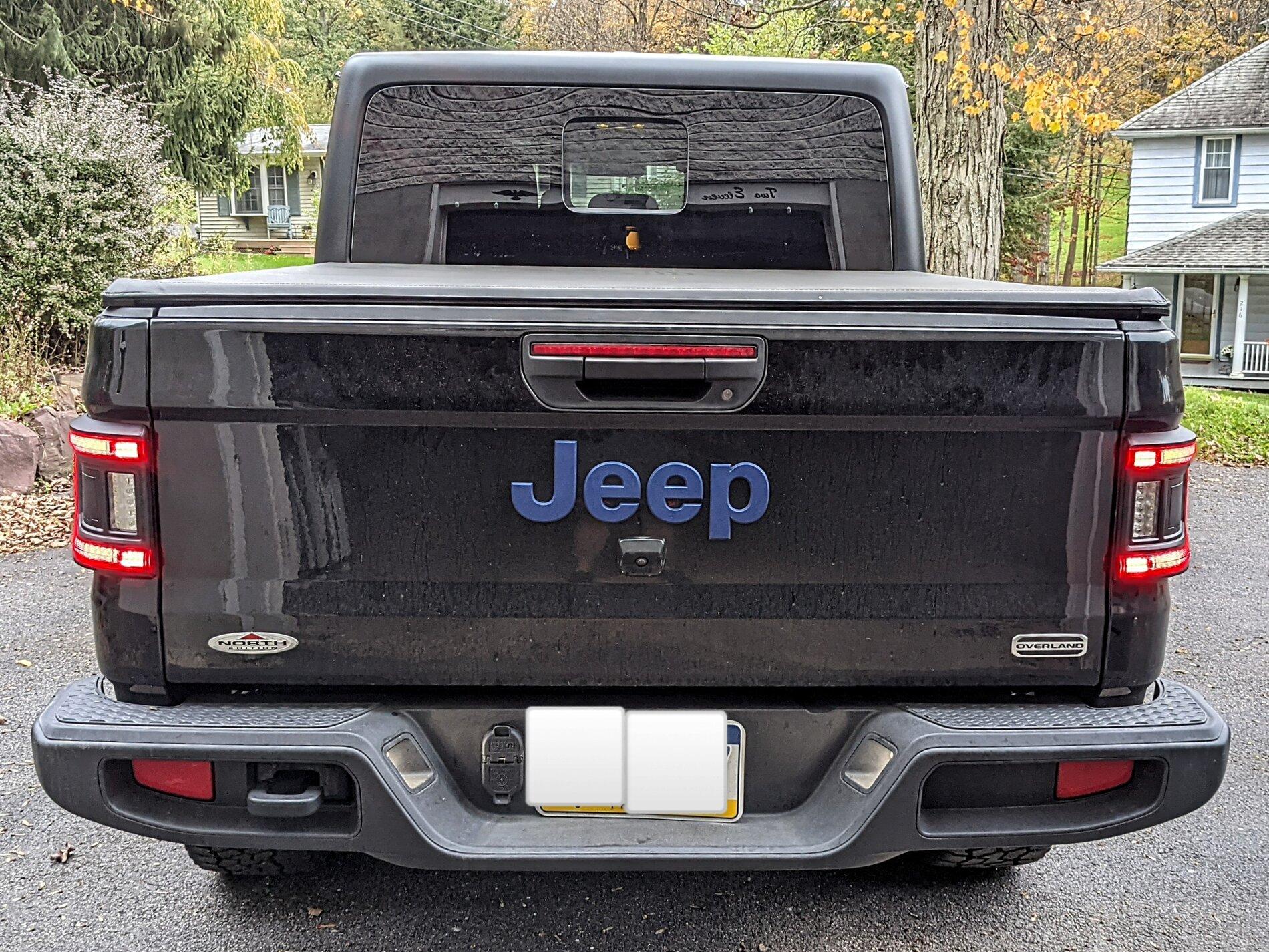

Installed today, non led, no warning lights or dash problems. However reverse lights turn off and on. And idea how to address this?
Jeep Gladiator Flush Mount Tail Lights PXL_20211024_193534853~2
