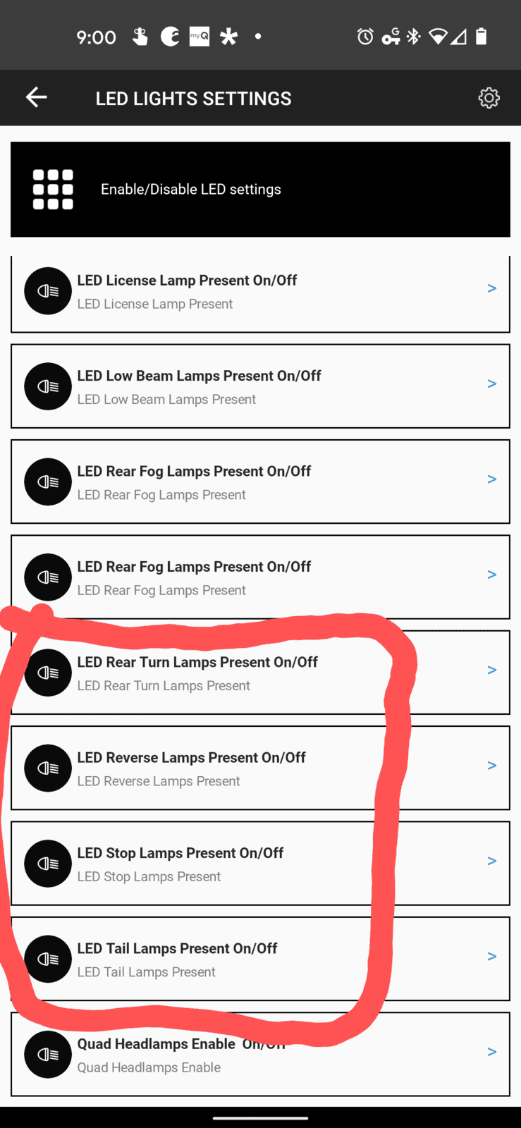

You shouldn't be having issues if you have a JSCAN and changed the right settings. Make sure yours matches this posted by another member:
Jeep Gladiator Flush Mount Tail Lights 1634854626836

You shouldn't be having any issues if you have a JSCAN and changed the right settings. Make sure your matches this posted by another member:
Yeah, I used the exact same JScan setting. I wrote that in my message to @ORACLElights last night.
