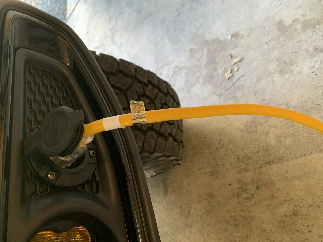

Ended up adding an outlet to mine. A few hours and $35 later and haven’t had any issues so far, this will be it’s first winter but we’ve already gotten down to the teens.
I picked up a smart adapter from Amazon that ties in-line which allows me to set a schedule and supports inching which allows me to tap the app once and it will auto shutoff after X amount of time (an hour is what I have it on now). Was an additional $20 but well worth it. No big brother external connection either, local network only.
