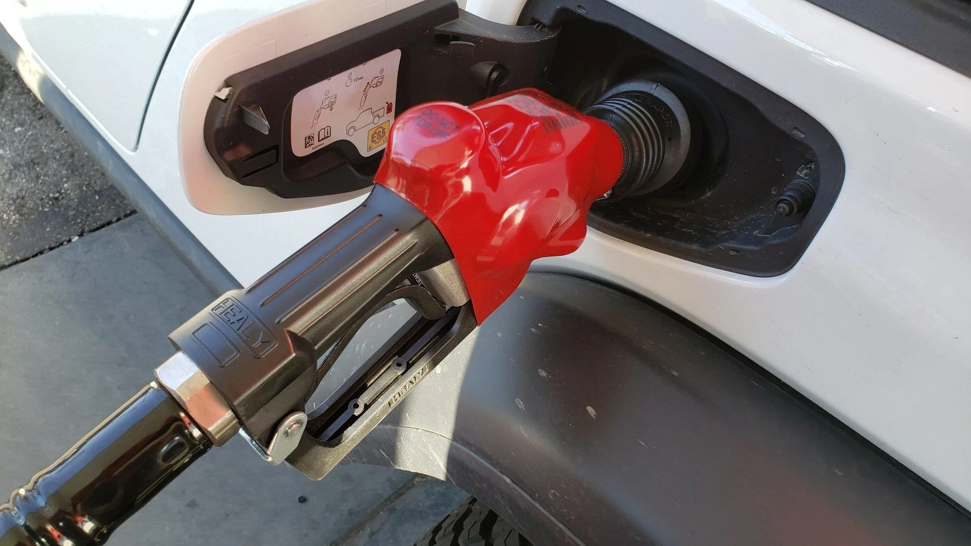

This is my pumps here haven't had it happen yet, not looking forward to it though.
Jeep Gladiator Gladiator fuel overflowing. 20200118_151122
Gatorized
Sep 13, 2019
1,897
1,779
ME/NH
Pictures of the nozzle are a must! Looks like this one has the compression collar for an air tight seal. I can’t remember the last time I saw one of those around Maine and New Hampshire. Mostly see the nozzle with the rubber shield that sits just above the filler neck.

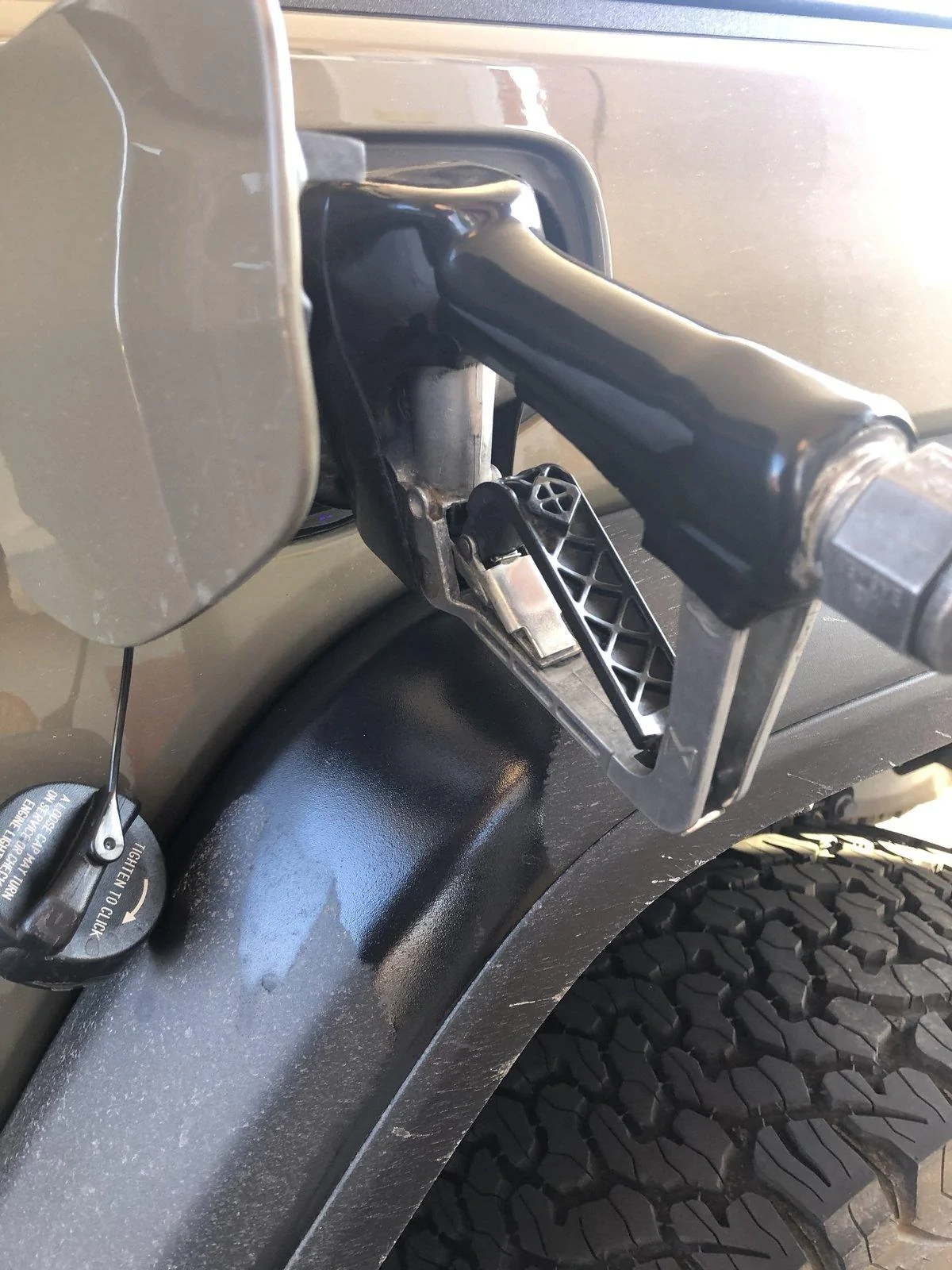

Here is my last spill, I'll take it from a better angle next time but in CO we have old school little rubber collars, not the big spring-loaded vapor catchers like CA. Which also means I put the pump handle on lock and I am doing other things until it is done. This day was windy so I sat in the Jeep to stay warm during the empty tank fill. I'm going to start refilling at 3/4 tank just to get more data points.
Jeep Gladiator Gladiator fuel overflowing. 41852D06-4990-48EA-9D95-0CC910D97BE6
Blade1668
Darrell
Jan 7, 2020
3,296
3,194
N. AL.
My LJ does it, I never did the "hack" fix my fix is if at 1/2 tank or less is to fill 7or so gal stop let tank burp then continue with fill. Start listening for burp "dong" sound stop then slow fill until clicks off. Stations seem to have gas pumps turned way up to fill faster, to much pressure builds up. I see it in my work car too. I think it's due to EPA devices on vehicles. I noticed on the inside of fuel fill door sticker has directions to let set for few seconds (10) before removing pump nozzle.
