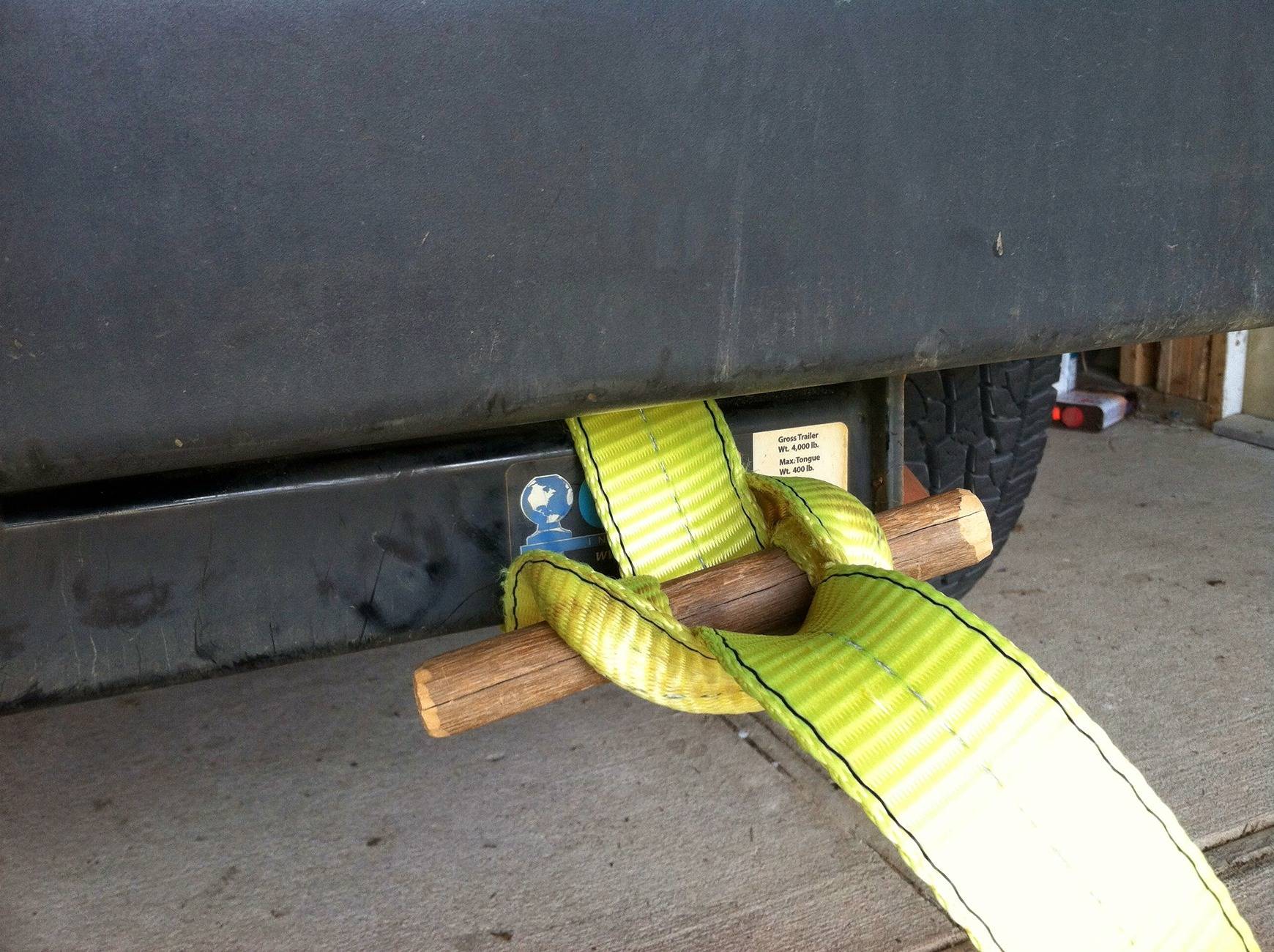

Here an inexpensive tow strap is used to connect to a hitch receiver.
Avoid the temptation to use the hitch ball.
They can snap off. A few people have been killed that way.
Likewise, do not use tow straps with hooks on the ends.
Jeep Gladiator Gladiator Recovery Assist Pictures:  The Hall of Shame doweltowstra
A dowel makes it easy to free connections
that would otherwise be impossible to loosen.
This pine dowel did not last long and shattered.

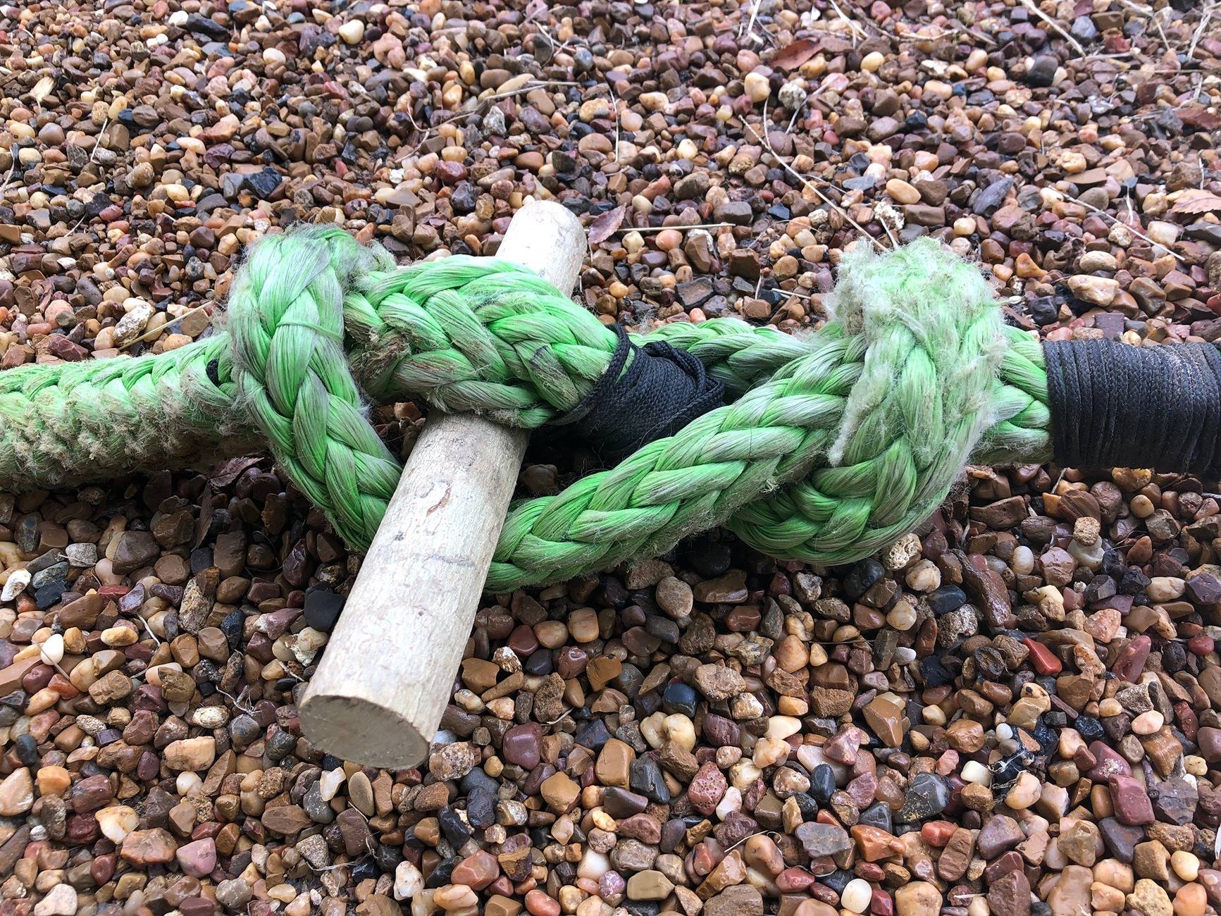

Here is another example of how to use a dowel
to connect two tow ropes.
Dense hardwoods like elm, persimmon or crepe myrtle
make tougher dowels and can be had for free.
