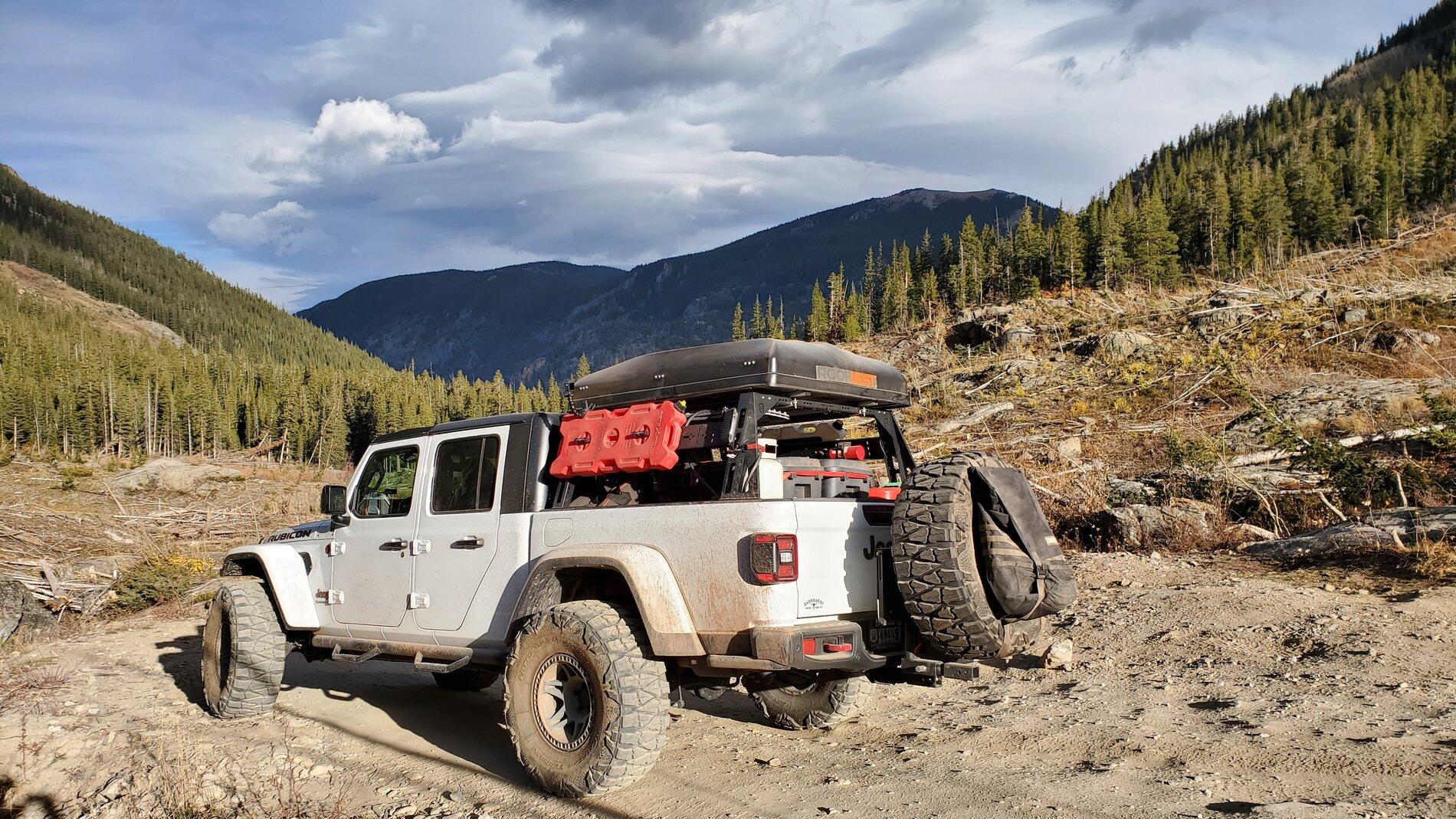

New to all this stuff.... Do you have a spare? If so, where the heck to you fit it?
No worries, I was new about 9 months ago as well.... The full size spare actually will fit underneath in the factory spare location. I keep it there for my day to day needs. When I go on trips and need that additional clearance I use the Rigd Swingout, https://www.rigdsupply.com/

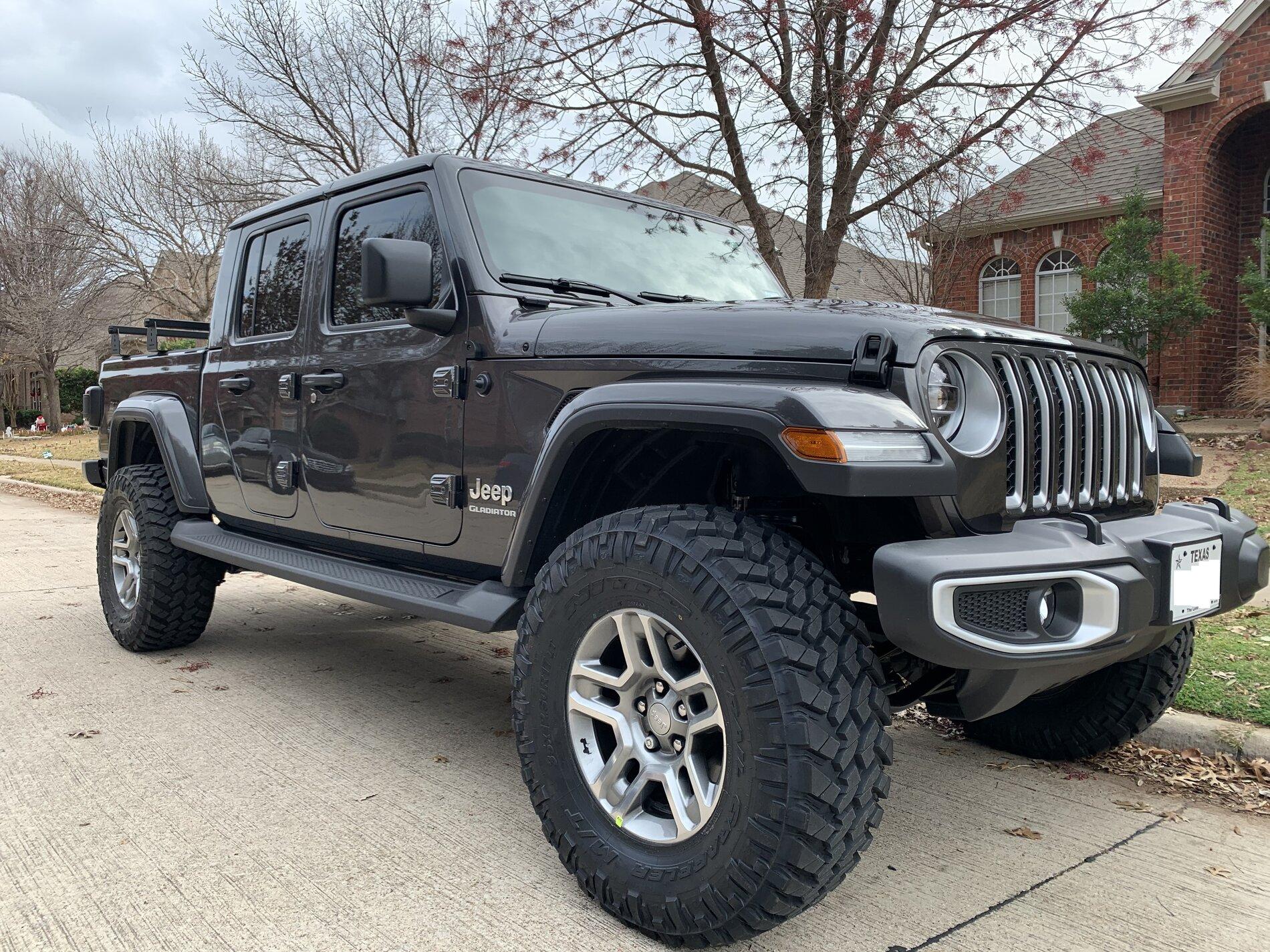

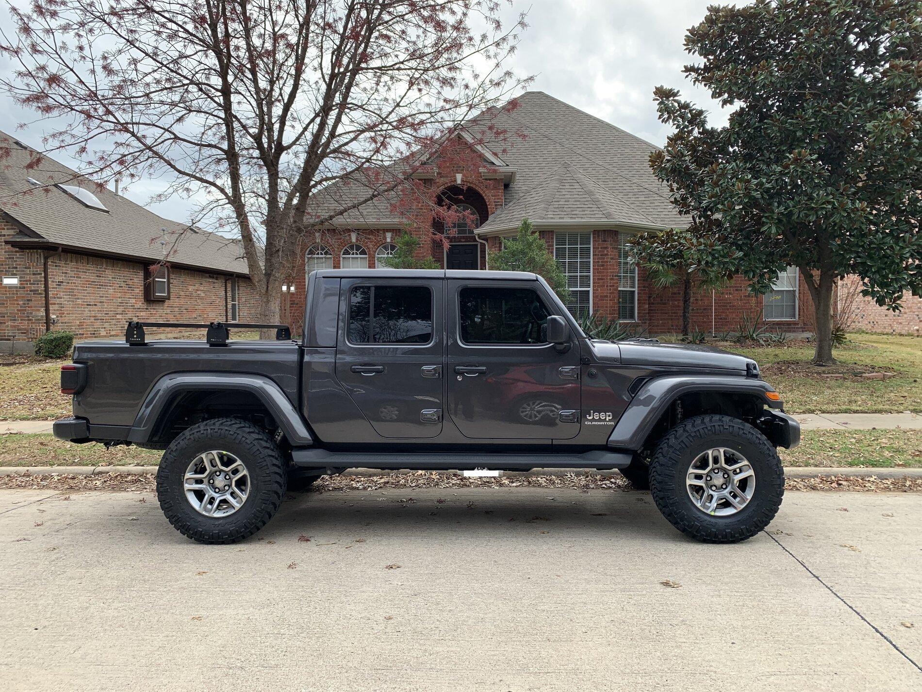

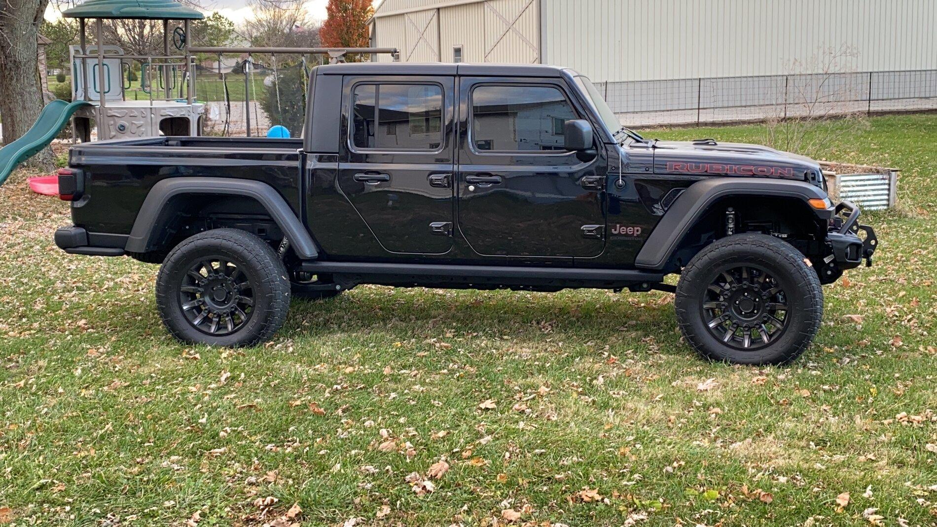

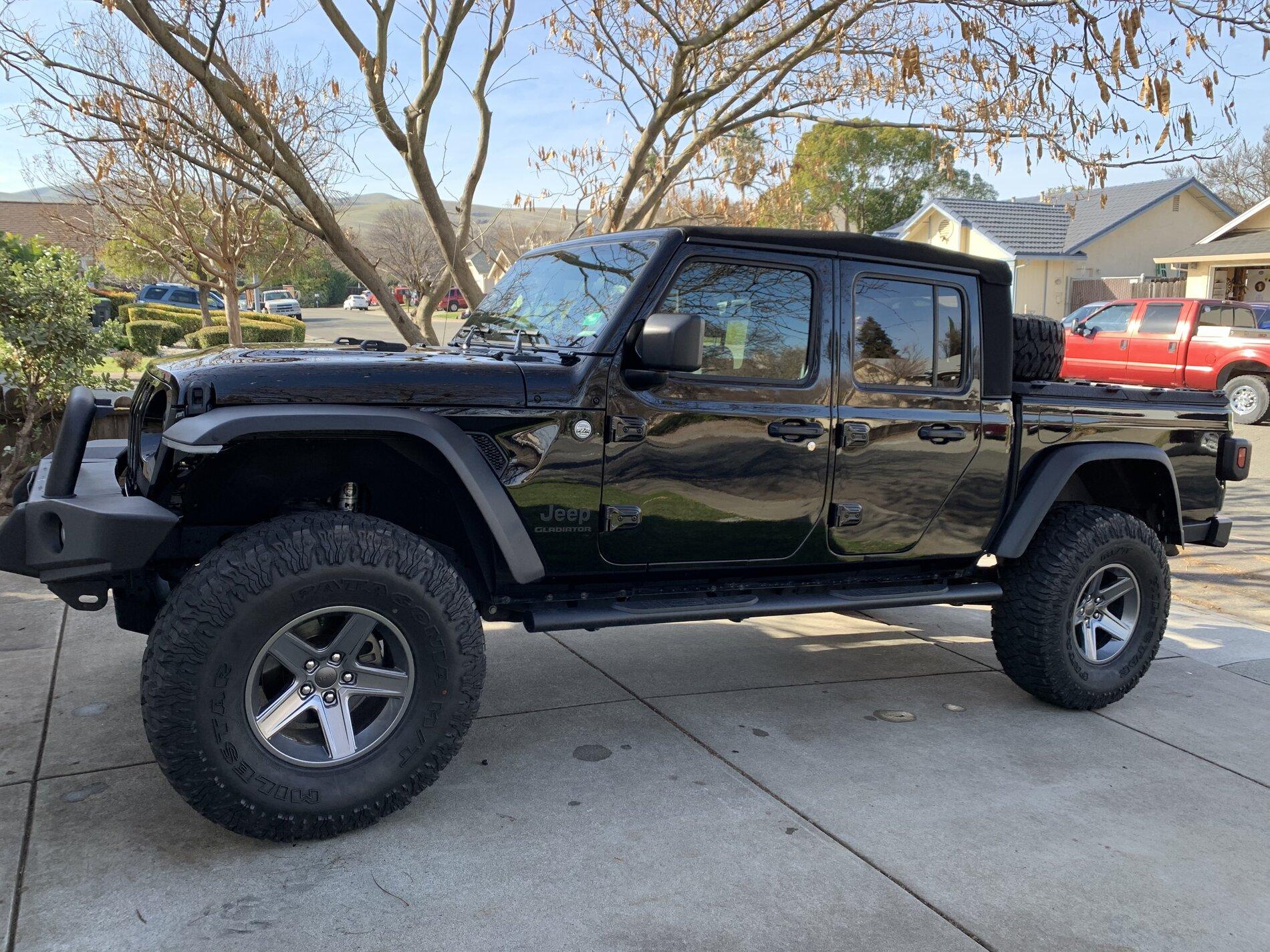

Just got my Mopar lift done. 2021 Overland, 2" Mopar lift with fox shocks, adjustable track bar in the front, fox steering stablizer, synergy sector shaft brace, mopar performance wheels with 35x12.5x17 Nitto Trail Grappler MTs. Regearing to 4:56 next week.

Did you use the Rancho geometry correction brackets with the factory control arms or the slightly longer Mopar lift LCAs? What was your rational for either? Thanks in advance.
i used the Ranco GEO-RELO brackets with the provided LCA's in the Mopar kit. They are only 1/8" longer eye to eye than stock. I honestly dont know whey they even bother including them in the kit. Especially for the matter that the nomenclature states for the caster to be 4.5deg (+/-) 1deg after install... Ideal caster angle range for JT/JL platform is 5-7deg... My current configuration has me at 6.5deg caster.. its like driving a cloud on a set of rails. I absolutely love it.

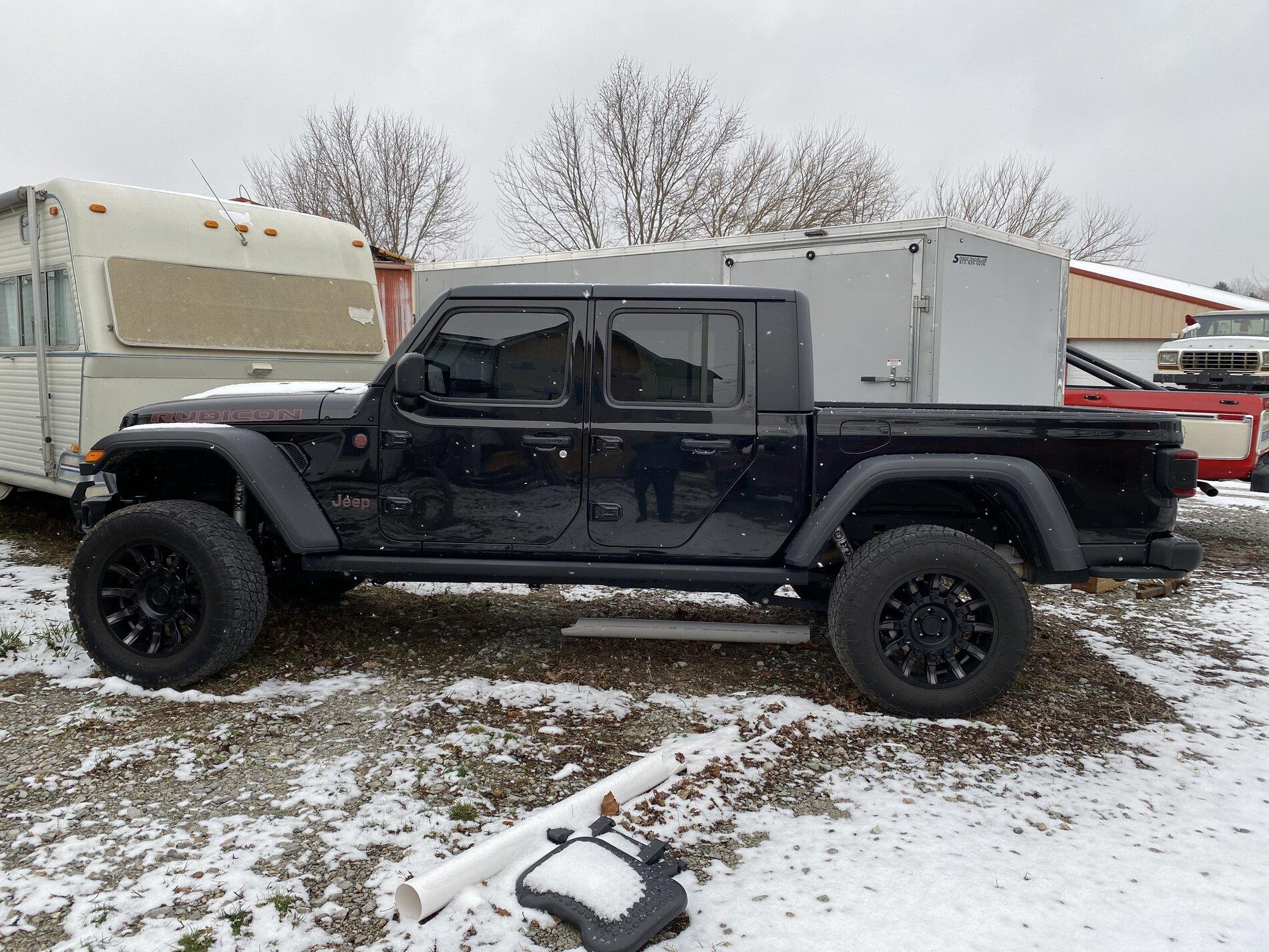

thats nice. The 4.56 will make that a perfect set up. đź‘Ś
