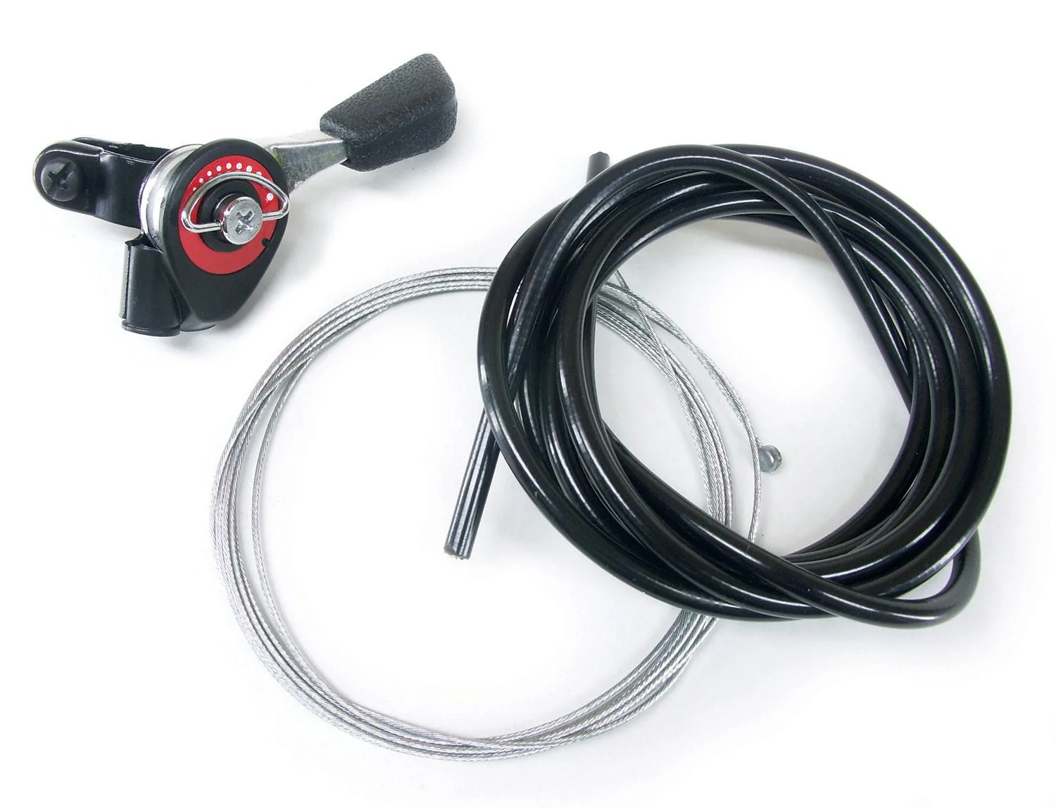

I've had several Mts but I've never went off the pavement with them and have no clue how it will be . I love shifting gears but not knowing how to respond off-road or backing a boat in ect scares me. Any takers want to give me some advice? I's it something that Id have to trial and error out and figure it out on my own or with some mt experience is it pretty simple?
Old thread but thought I would throw this out there. Use a hand throttle. This is what i have on my XJ MT and it makes life a lot easier when you are in those challenging situations in the rocks, etc.. Just mount it on the shifter below the knob and free up your right foot for just the brakes.
Jeep Gladiator How hard is it offroading in a manual transmission? handthrtl
https://teraflex.com/shop_items/528ffa7fead962f416e72f87
