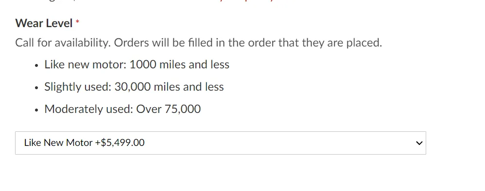

They were going to put in a 72K mile engine assembly for that kind of money?
Wait WTF?
8k for a 72k mile engine?? Buy one from Rubitrux.
Jeep Gladiator I will never buy a Gladiator again ? 1699397110154
These motors were pulled for HEMI conversions. We have sold hundreds of engines with no issues and now are doing the HEMI conversions for the JL & JT and getting these motors in close to new and perfect working condition.

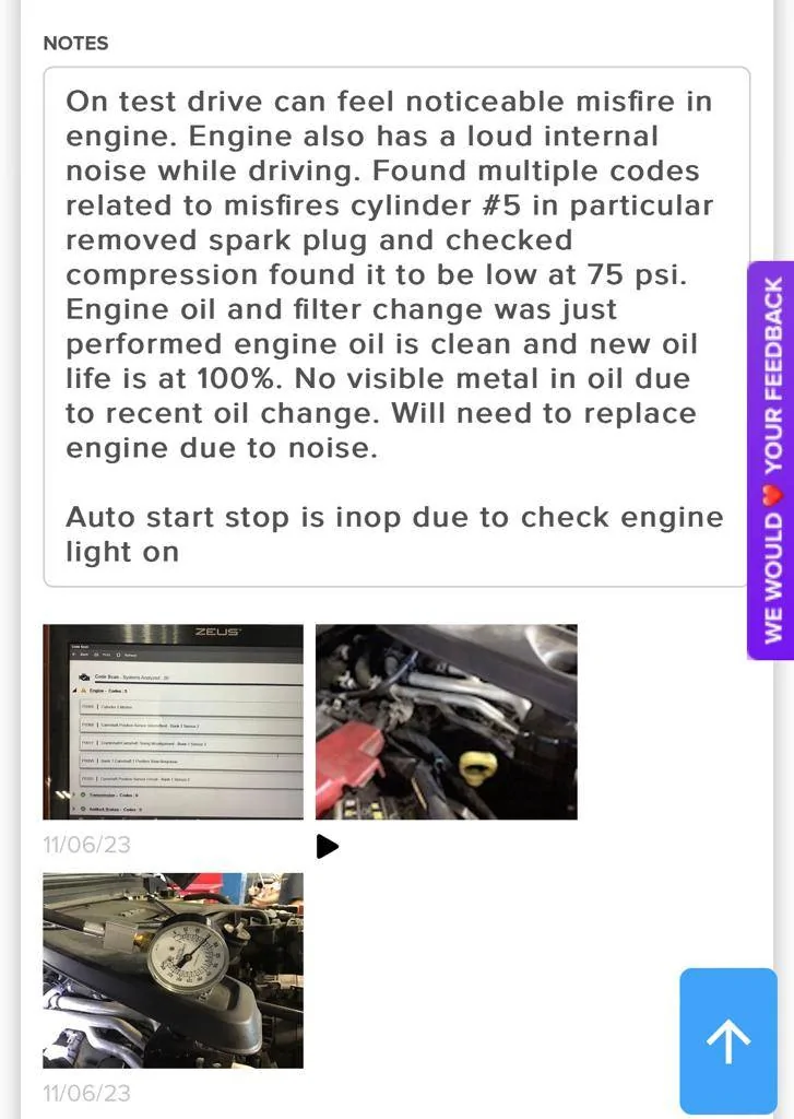

and this is my lemon gladiator...I bought it three years ago, I WOULD NOT BUY IT AGAIN TODAY, two years walking from dealer to dealer and spending money and they never solved anything for me. This is my latest diagnosis...has anyone had something similar happen to them? totally lost

Check valve lash for bent valve.
How are you going to bend a valve on these unless the piston hits a valve. If that happens, you have big troubles. There's no lash to these, lash adjusters and followers.
Sometime piston and rings can still be good after lightly hits the valve, depending on compression ratio of course.
depends on a lot of factors - interference design, and so on.
But if a piston smacked a valve - it's got serious issues to even allow that to happen.
Something would have to stick that valve open farther than normal, and then it has to be an interference type design for the valve to hit.
many engines can lose a timing chain and not bend a valve because there are built-in clearances or due to other design considerations.
If a valve hit a piston - it's got problems beyond a bent valve - like the problem that could allow that to begin with. I'd never just fix the valve and move on. Find the cause.
