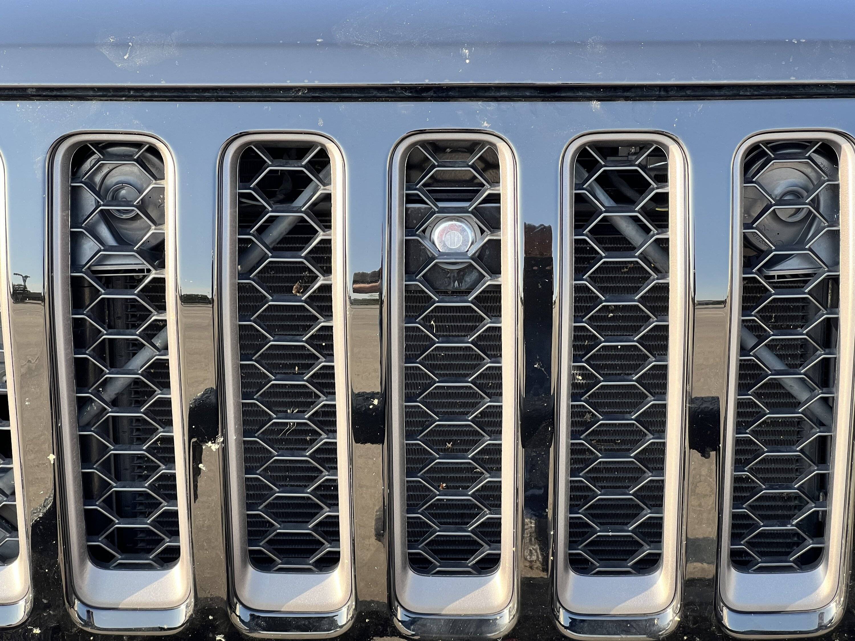

I wanted to share an install I just did. I have wanted to add a bolt lock to my JT but did not want to cut my grill. I had considered plastic welding the JL lock trim into the cut out of my JT grill but I found a way to install it without cutting at all.
There are several videos on YouTube and TikTok on how to install the Bolt Lock. You basically remove the 6 push tabs to remove your grill. Pop the grill out and then slide the bolt lock assembly into place and use a rivet gun to pop 4 1/4” rivets into place.
Next you are instructed to cut out a section of your grill to allow clearance for the key. This is where I went a different route. I used a razor to remove the rubber cover that would normally cover the lock and installed the grill over the lock without cutting.

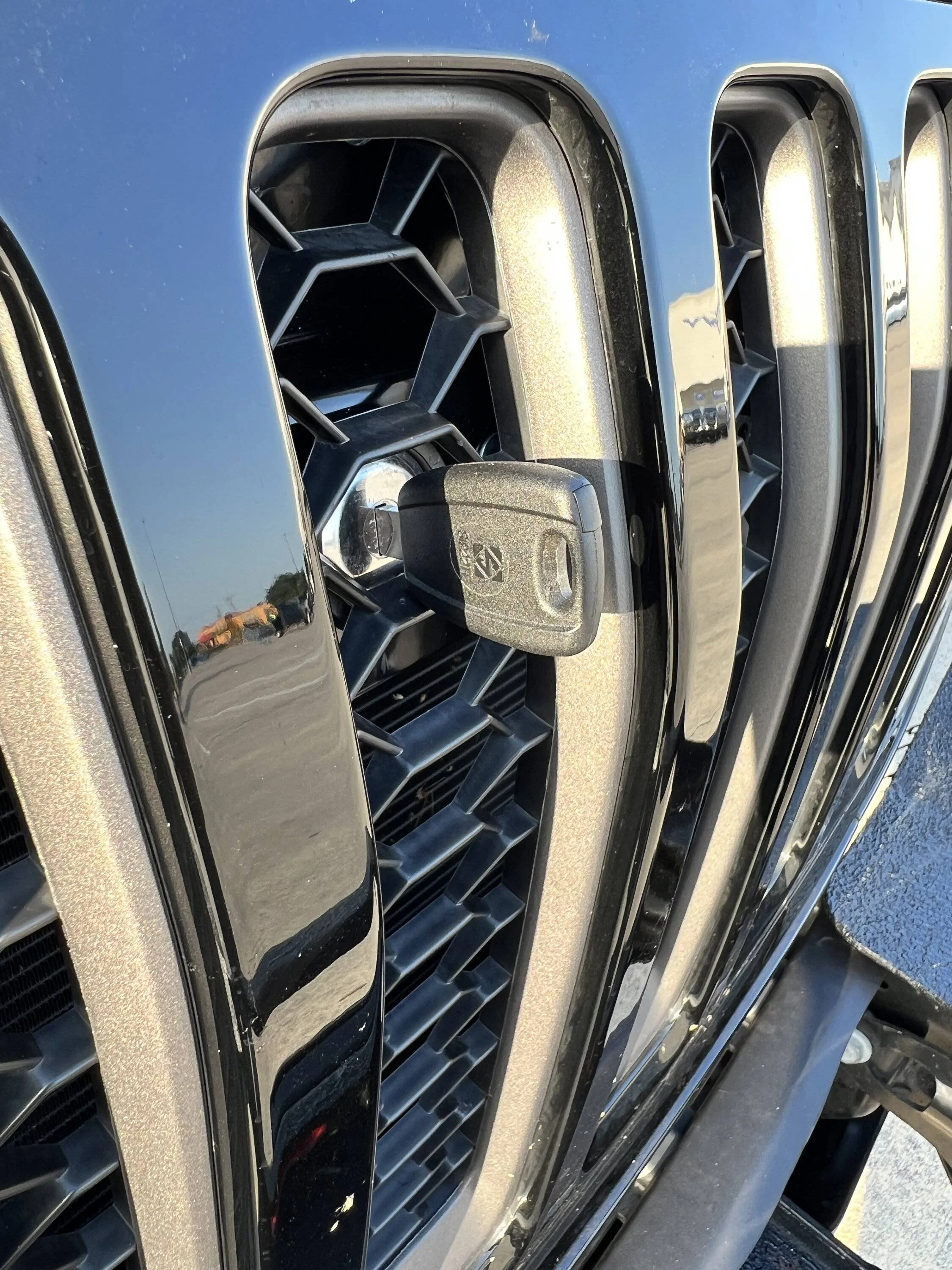

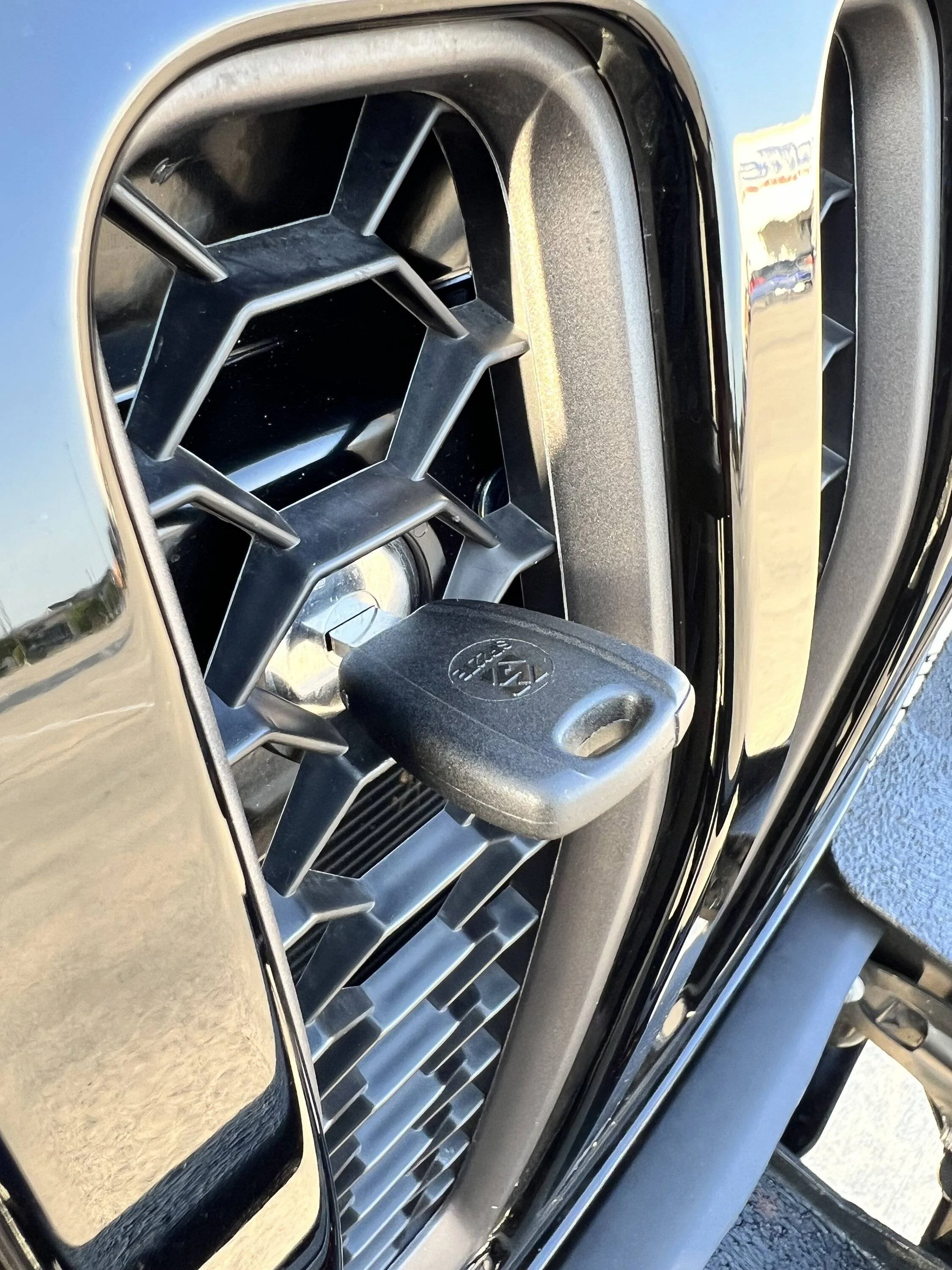

My local locksmith had several SIP22 and SIP22TE nonchip Dodge/Chrysler keys. These keys cost $5 and he charged me $8 to cut them to match my factory key. This key fits perfectly between the holes in the grill and opens and locks my hood without having to cut anything. I already have to lock my wheel lock key in the glovebox so it doesn’t hurt me to keep this one locked in my glovebox along with my wheel lock. I also like that it allows me a cheap alternative if I go surfing, swimming , or tubing in the river. I can take the $5 key (or $13 I guess) and wear it on a necklace or bracelet and not worry about it getting wet. It locks and unlocks your glovebox and center console so you can lock up your valuable and not worry about an expensive fob.
I think this info would help anyone who doesn’t want to cut their JT grill or anyone who wants a simple door/glovebox key and doesn’t want to pay $200. A few shops I called wanted $30-$50 to cut the key I found a local locksmith / Hardware shop to be extremely reasonable.

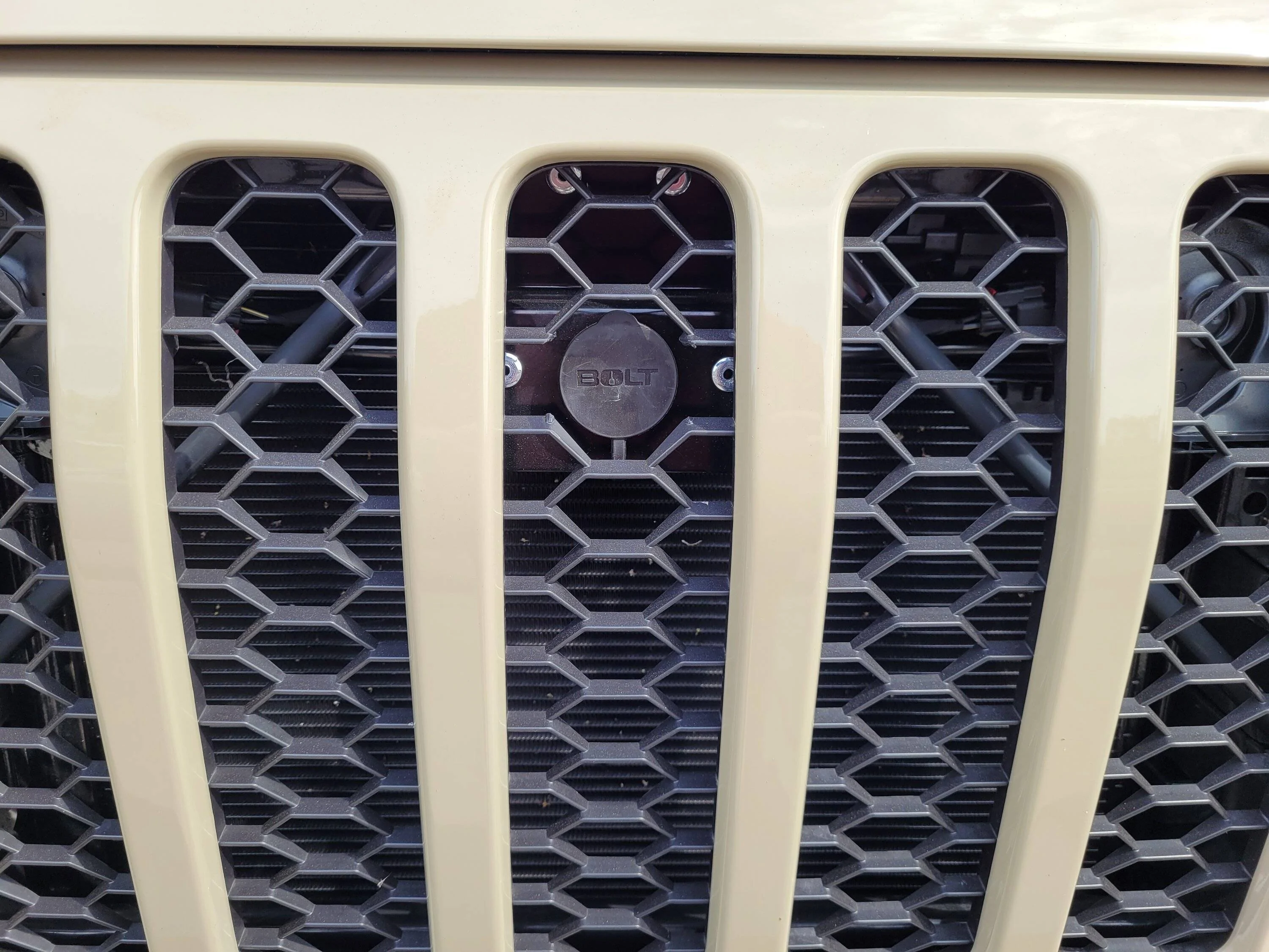

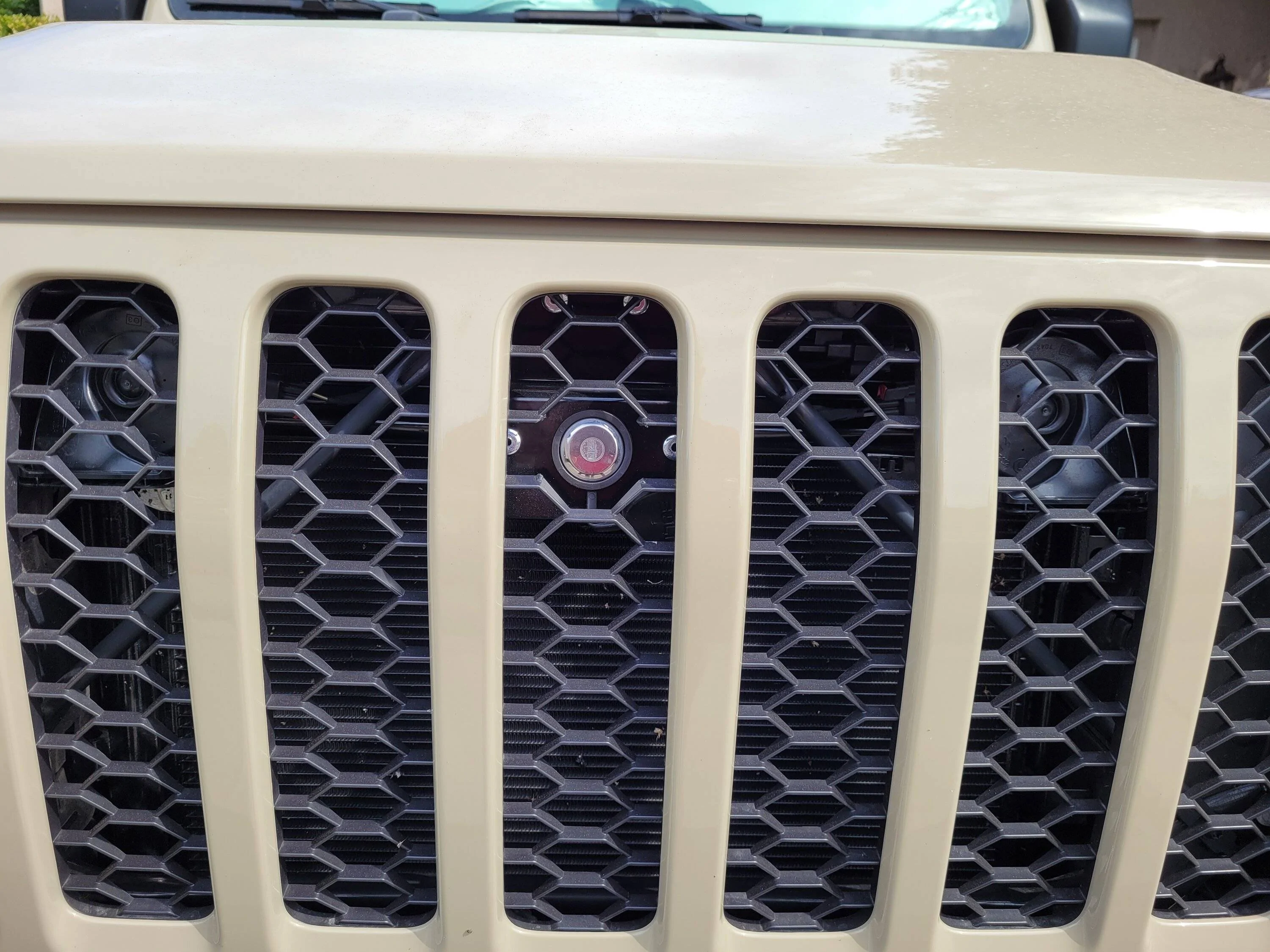

Hardly noticeable from a short distance. Almost have to be right up on it to see if you don't know to look for it.
