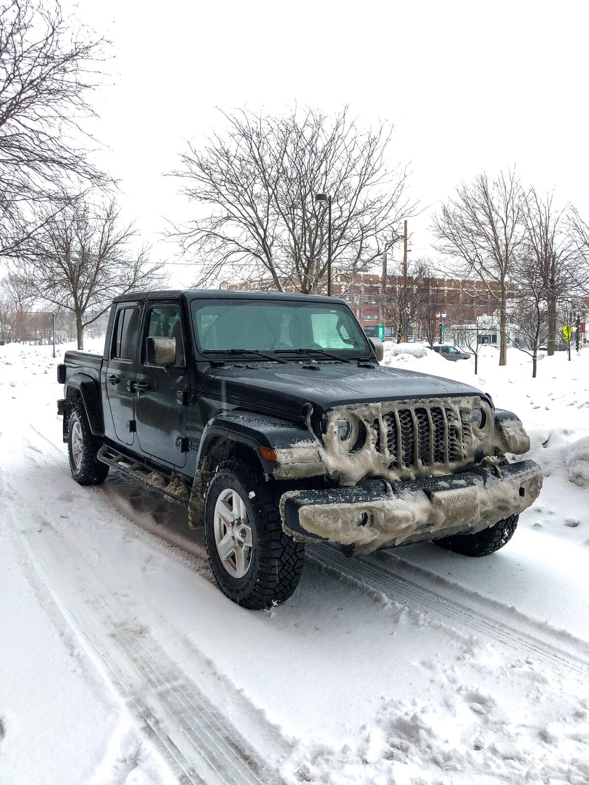

Here’s my take: if you live somewhere it snows, don’t get the LED headlights. LED headlights don’t generate enough heat to burn off the snow, the snow will pack into the headlight recesses and in the dark, you will quickly run out of light to drive with.
That said, you can do what I did and Buy halogen auxiliary driving lights, and I use those when I’m in snow conditions.
Halogens in photo, for what it's worth. I've since done a full LED conversion from Oracle and the light output is incredible.

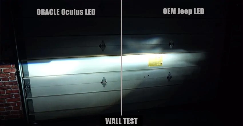

Here is a wall test comparison against the OEM. As you may see, the Oculus offers a sharper cutoff, better fill, and no artifacts (glare) above the line. All around, they provide enhanced driver visibility with increased and focused LED light output.

Is this an LED bulb in the OEM halogen housing or the OEM LED housing? I have latter and it looks nothing like what you're showing here.
Hi, the right side is the OEM LED housing. You can see this exact test live in this video from CJ Pony - wall test starts at 13:53.
