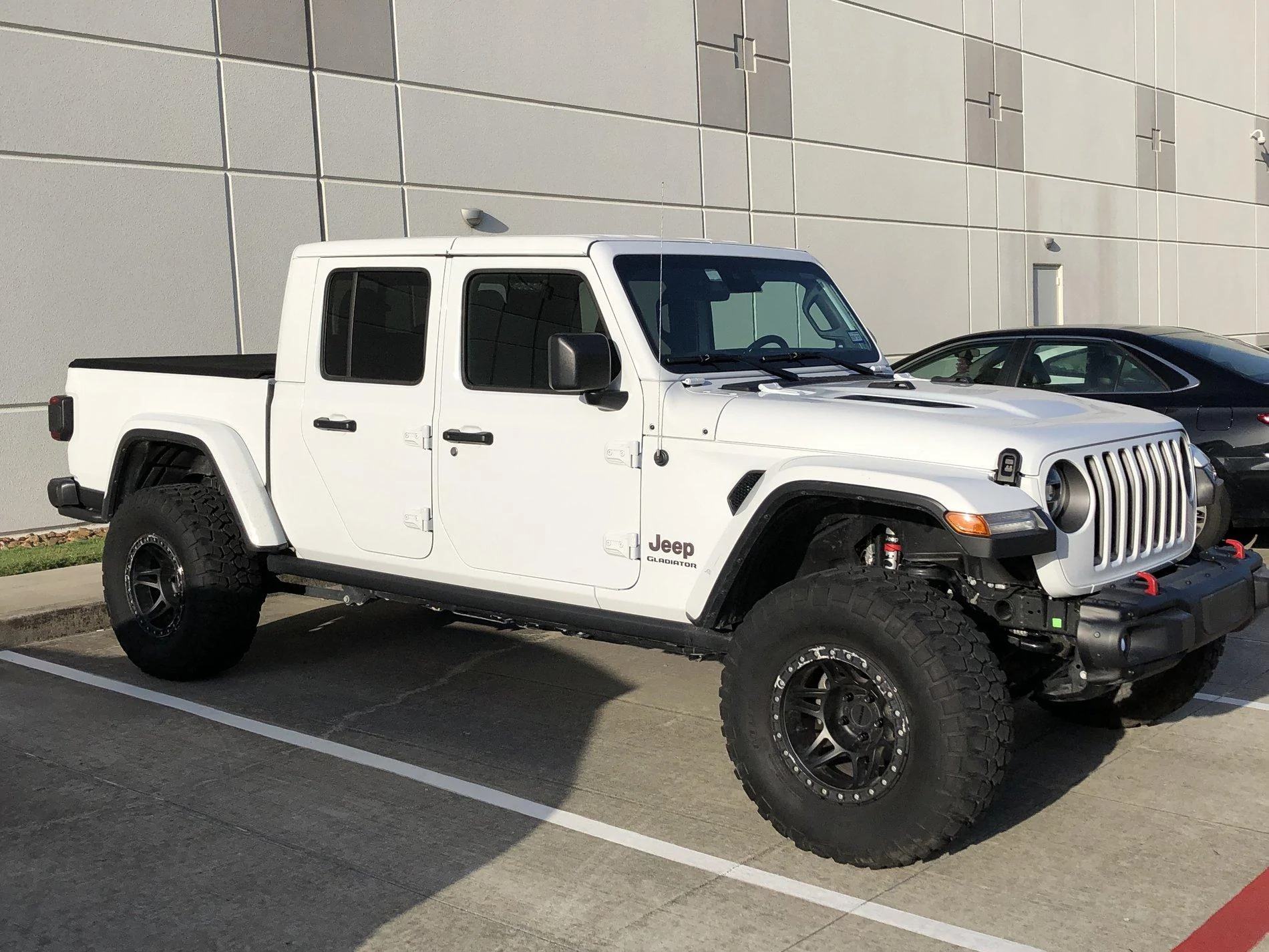

Yeah there's just something about the front of a truck sitting higher than the rear that bugs me. I guess my OCD kicks in. Lol. And anything more than 1.5" is going to make the front higher than the rear. Seems like that's the magic number that Jeep designed into these trucks to allow for payload.
My truck is not higher in the front ha. That's the angle of the photo. The rough country lift lifts it 2.5 inches in the front but lifted only slightly in the rear to make it level. The factory rake has the Gladiator much higher in the rear for payload capacity towing etc. Nothing like the Wrangler. My JT Sport S is the exact same height front and back. It's definitely not higher in the front.

So you put a tape measure on it and checked from center of hub to lip of fender front and rear and it's the same? Because in those photos it's clearly higher in the front. And, I have a Sport S also and mine has the Max Tow package, so the heaviest and tallest springs, and even then it was only 1.5" taller in the rear from the factory. I'm currently running a 2.0" front spacer and it's higher in the front, so I'm going to put a 0.75" spacer in the rear to fix it next week. A 2.5" front spacer would definitely make the truck nose-high.
I really like your truck. Very nice. I'm just sayin', there's no way it's level.

Daystar 2" lift with 35" tires. Control arms that come with the kit are about 1/2 longer than stock. Wanted to keep the stock shocks more than anything.
How much is the rear lifted? Is it also 2"?
