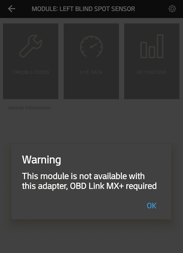

That's definitely not true because the JScan can with the Vgate can absolutely activate rear view camera and blind spot modules. Not sure where they are getting there info from.
Nope - both right and left blind spot sensors, radio and amp generate this error message
Jeep Gladiator JScan app Screenshot_20201001-102343
Jdyowa
Jeff
Dec 23, 2019
311
589
Lakeland, Florida
Gladiator overland
Manager
I bought the ODB MX+ the other day because my Vepek one wouldn't access the radio. There's nothing in the radio to really do, so it's going back. The blind spot sensors are already accessed on mine so there is nothing to do. I guess I don't need the more expensive unit. More mods somewhere else!
