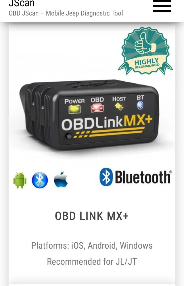

What obd ii do you guys recommend? So all I need is obd ii , cable, and license fee? Looking into it just for changing tire size and psi. What are other great features
Jeeperjamie
Jamie
Feb 12, 2020
135
4,752
5,410
Kannapolis nc
2020 jeep gladiator
Weyerhaeuser
LoJac963
Apr 17, 2020
292
258
Arizona
I have the Vgate iCar Pro. They have a list of adapters which work with the app on their website if you want to cross check it.
Under-Pressure
May 7, 2020
96
125
Space Coast Florida
2020 Jeep Gladiator
I’m using this one:
I purchased the above adapter recently and could not get it to work with J scan. Sent it back & purchased the Vgate I car Pro. Zero issues with the adapter & J scan. Much easier to use than Tazer & a fraction of the cost.
