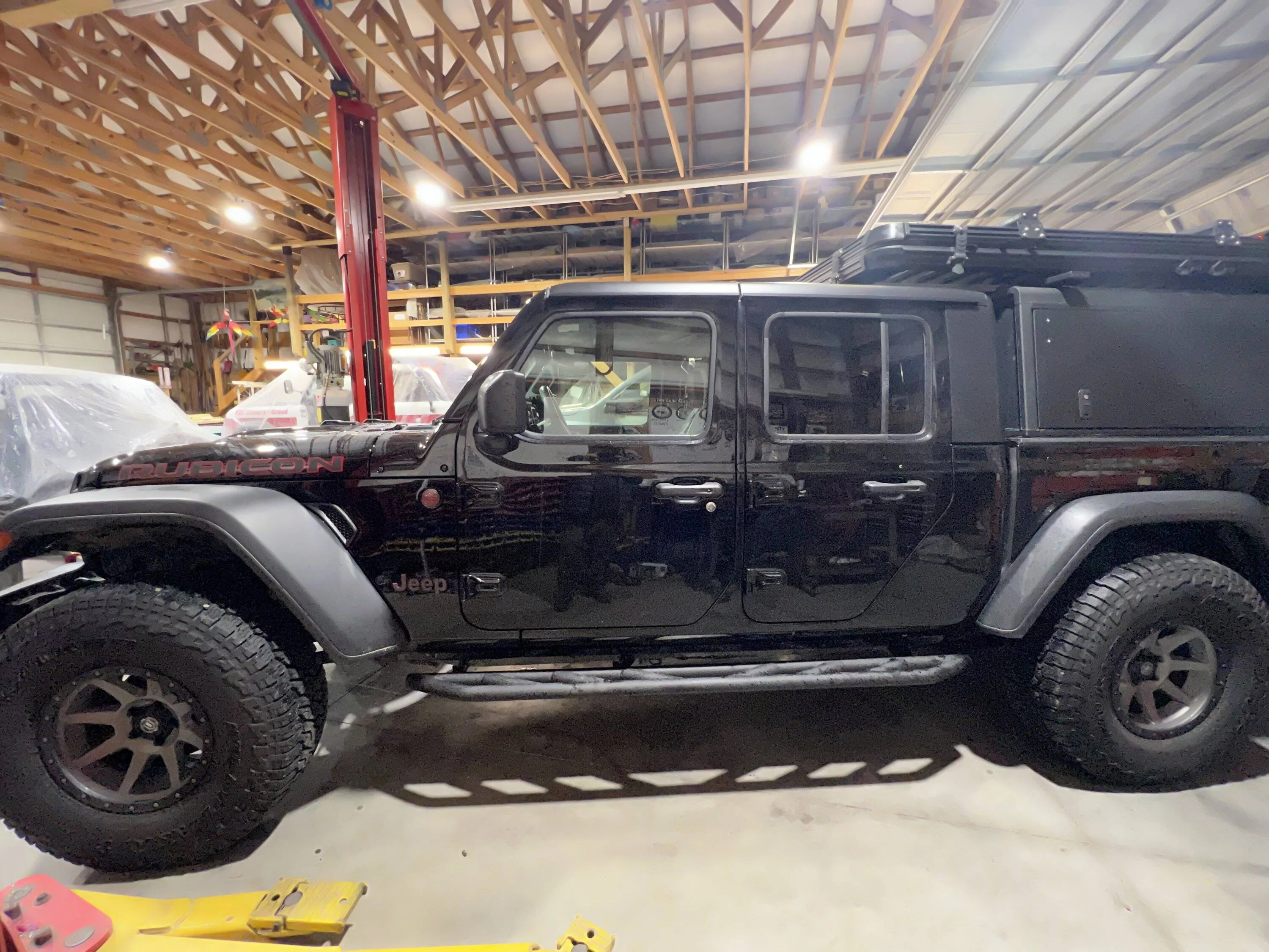

Would be interesting to see what that looks like with a side shot and all that stuff removed on level terrain.

BEfore installing the lift. Bed was empty in this picture.
