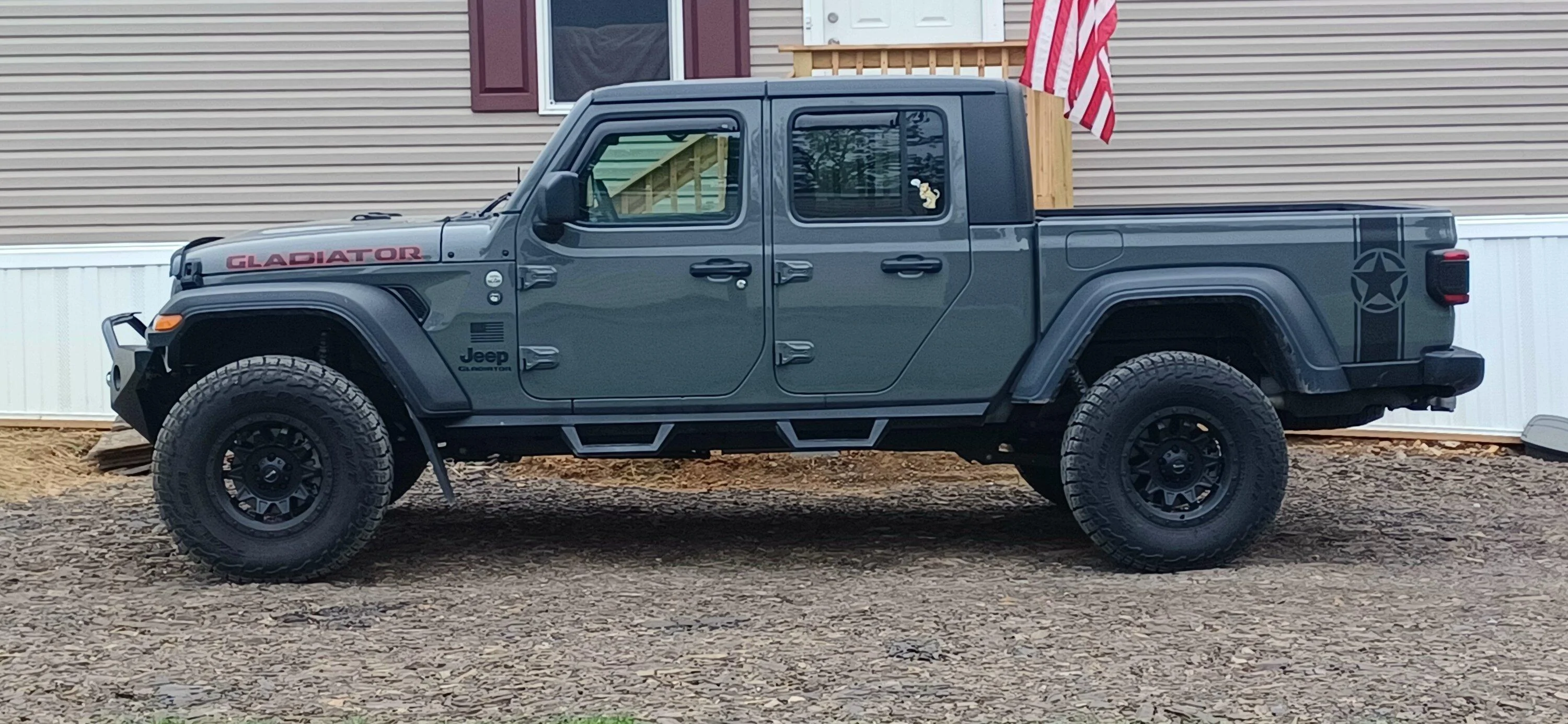

MOPAR 2" lift (2.5" in reality). Very happy. Rides better than stock. Tracks straight, feels substantial. I added a beefed up front track bar. Have Wildpeak 35" tires. Truck has the max tow package so the extra heavy tires don't feel as heavy. I see 8th gear pretty frequently. The lift retains the factory rake for hauling.

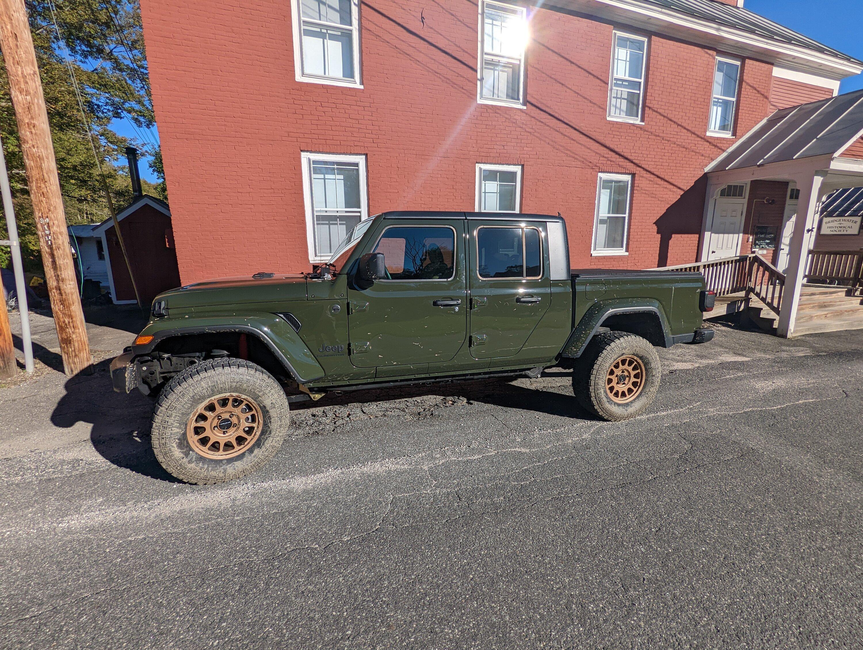

22EcoDs
Oct 14, 2021
1,515
1,684
NY

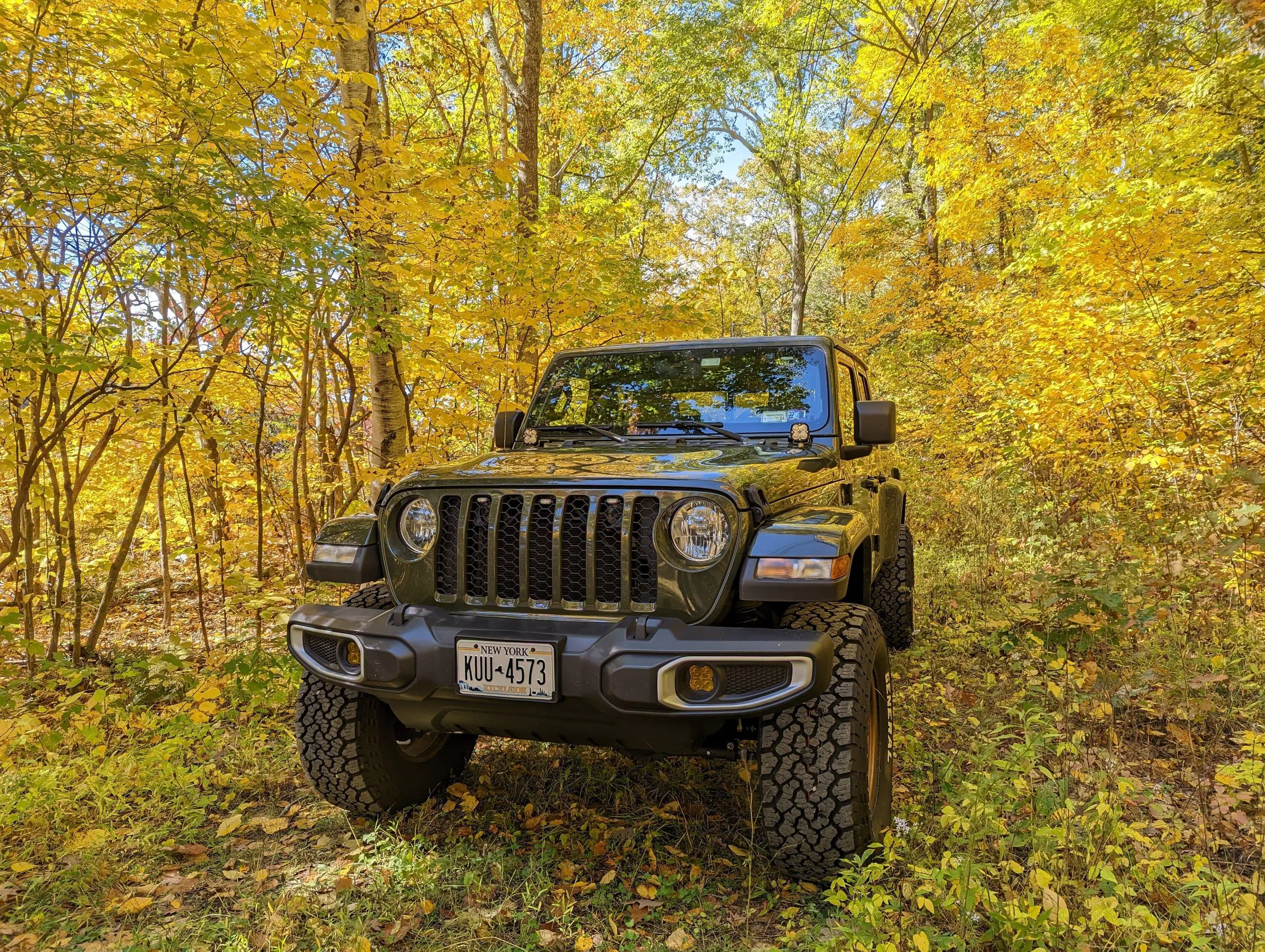

Clayton diesel 2.5 with rancho rs9000 adjustables, Metal cloak front arm brackets. American made and rides well.

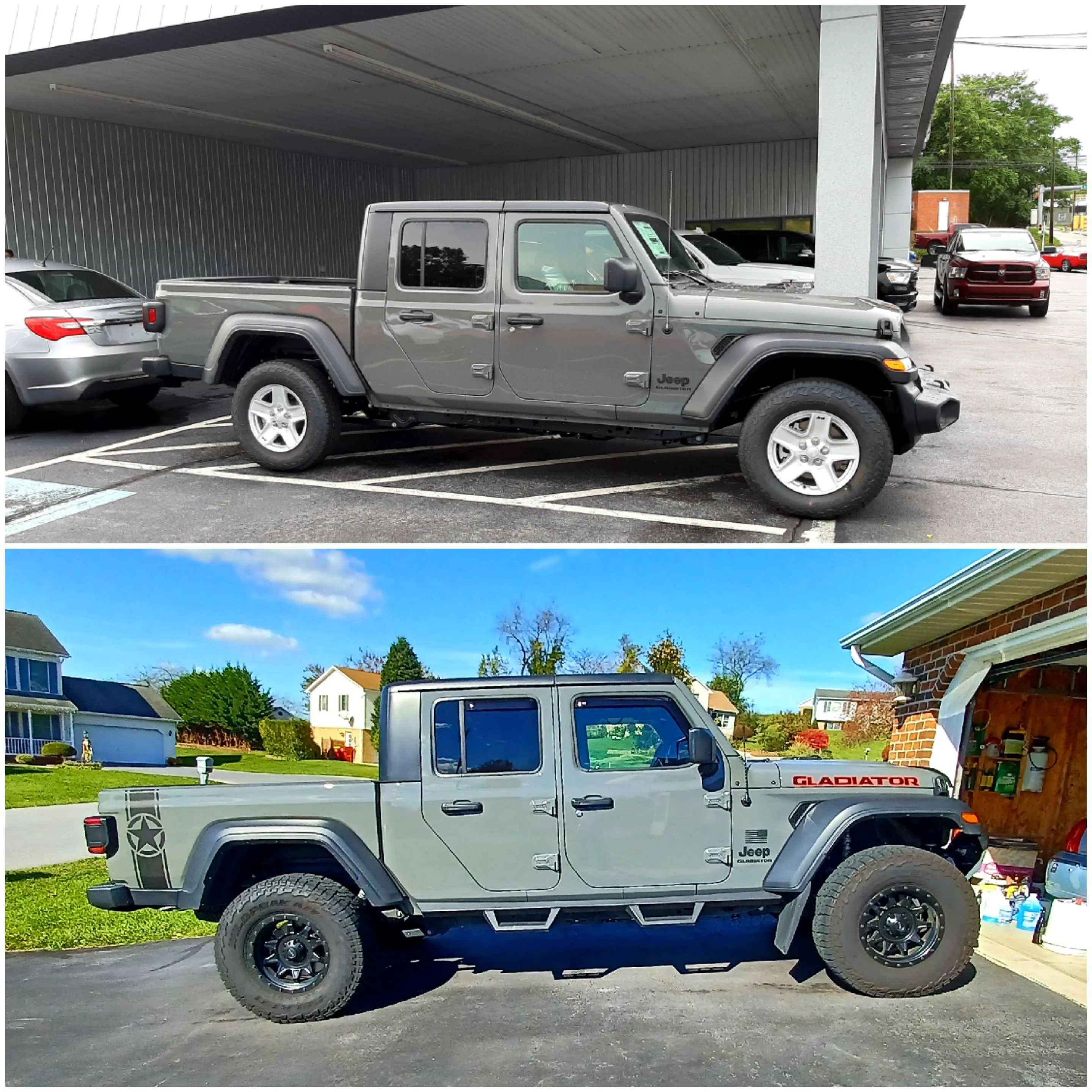

No spacer in the rear. I just used a leveling kit. Regarding the JL of my Wifes, it's a Sport and rides rough. I finally took my out off roading this weekend as it sits with just the spacer. It did pretty good but another 2-3" is in order for sure.

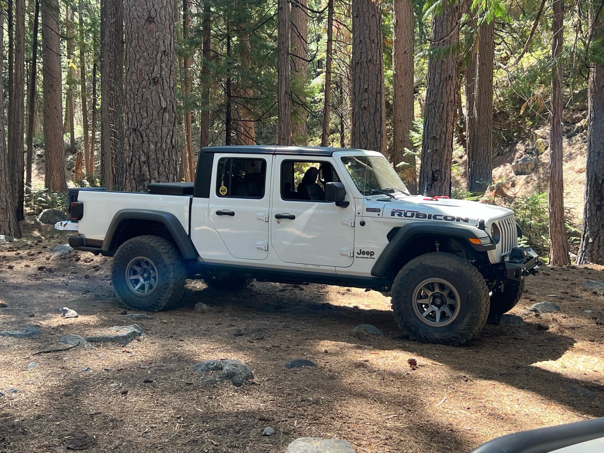

rubicon4wheeler
Geoff
Jan 1, 2022
228
373
Sierra Nevada, California
2022 Gladiator Rubicon Diesel
Safety Supervisor

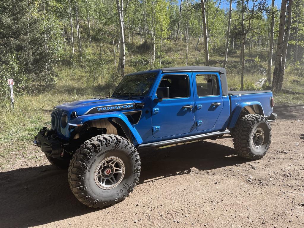

To fit 37's I started out with the AEV 2.0 spacer lift and upgraded it from there. First things first, since I sometimes drive empty and sometimes have a big load plus a travel trailer, I added a set of Airlift airbags in back. Those continue to work perfectly. Up front, I found that I was crashing off the bumpstops a lot. Upgrading to MetalCloak's bumpstops helped, but the fact remained that the front springs were too soft and the shocks all around were underdamped.
I had to be extremely careful with ride height, however, since my garage header only gave me about 3/4 inch of clearance. I decided to go with RockKrawler's 2.5" diesel springs up front. I now have 1/8" of clearance at the highest point of the hardtop (the back edge) as long as I make sure my airbags aren't inflated. The additional front bumpstop clearance and height made a huge improvement in keeping it off the bumpstops, but the OEM shocks were still too soft.
I have always had great performance from the adjustable Rancho RS9000s on all my 4x4s, but the built-in bump zone of the adjustable Icon reservoir shocks would be even better, so I bit the bullet and bought the fancy shocks. WOW this was a fantastic upgrade. They're as awesome as they're designed to be off-road, but they're also terrific on-road and when towing my travel trailer.
The other upgrade that made a world of difference in ride and handling was the MetalCloak lower control arm brackets. These are way heavier duty than the AEV brackets I put under my JK so I'm not worried about dragging them on the rocks. Without a doubt my Jeep rides and handles way better than stock.
