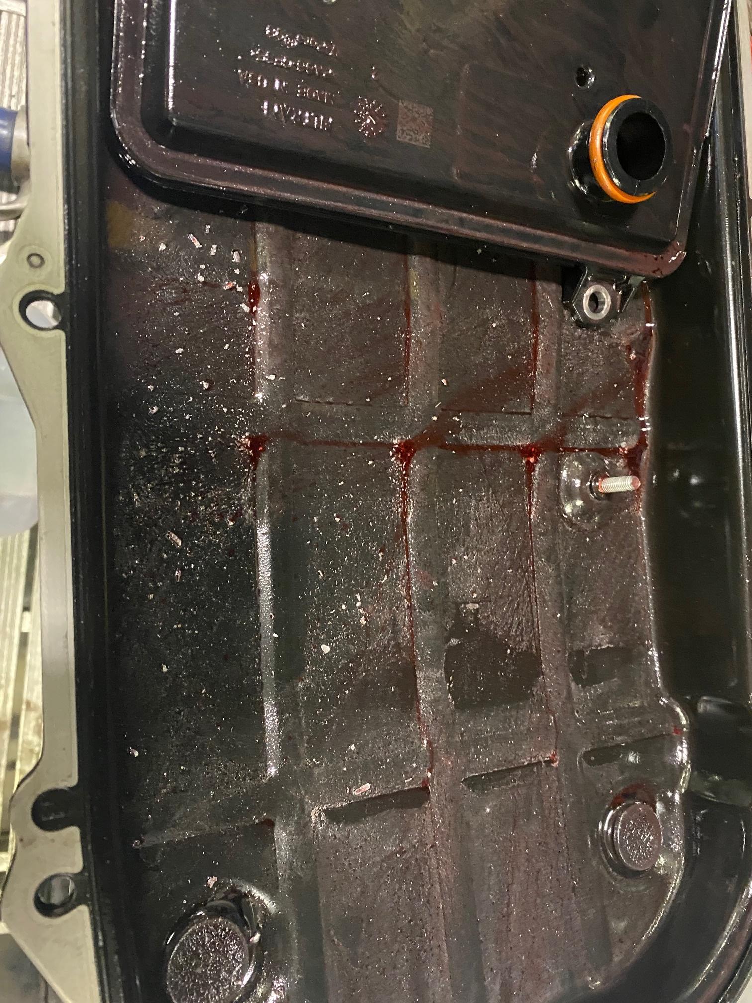

I could only wish that all of us who are experiencing early transmission failure would get an oil analysis done BEFORE anything is done.
I did 2 reports. First at 24k kms and second at 32k kms where it died.
-1. First shows glycol from the factory assembly and extreme abnormal numbers for copper, iron and sodium. Lab comment ALERT: change oil and filter.
-2. Complete flush done, Chrysler code compliant for 850RE transmission Amsoil Signature Series Fuel Efficient ATF installed.
-3. Second analysis report 8k later at first transmission ESS code P1B14-00 (PARK BY WIRE, UNINTENDED PARK POSITION) won’t come out of park mode, - report shows NO glycol present but again, extreme abnormal copper and iron. Sodium not highlighted. Lab comment ALERT: change oil and filter.

UPDATE: 32800 kms, transmission is dead.
For 3 weeks the truck sat in the garage because tranny wouldn’t come out of PARK, then a member here showed me a video how to use the manual PARK release strap and wouldn’t you know it, I could drive again! What a wonderful experience… until today I’m off to work when all of a sudden RPM’s shot up and I had no forward push. I coasted to a perfect spot and the truck was towed to the dealership.
Safe guess on the ATF oil analysis plus 800 more kms puts the numbers like this: 1000ppm copper and 1100ppm iron. Those are the death numbers if anyone is looking at their own and want to compare.
Proper numbers should be at about 40 ppm or less. The video on page 4 show great numbers of 150 ish at 50k miles!!
