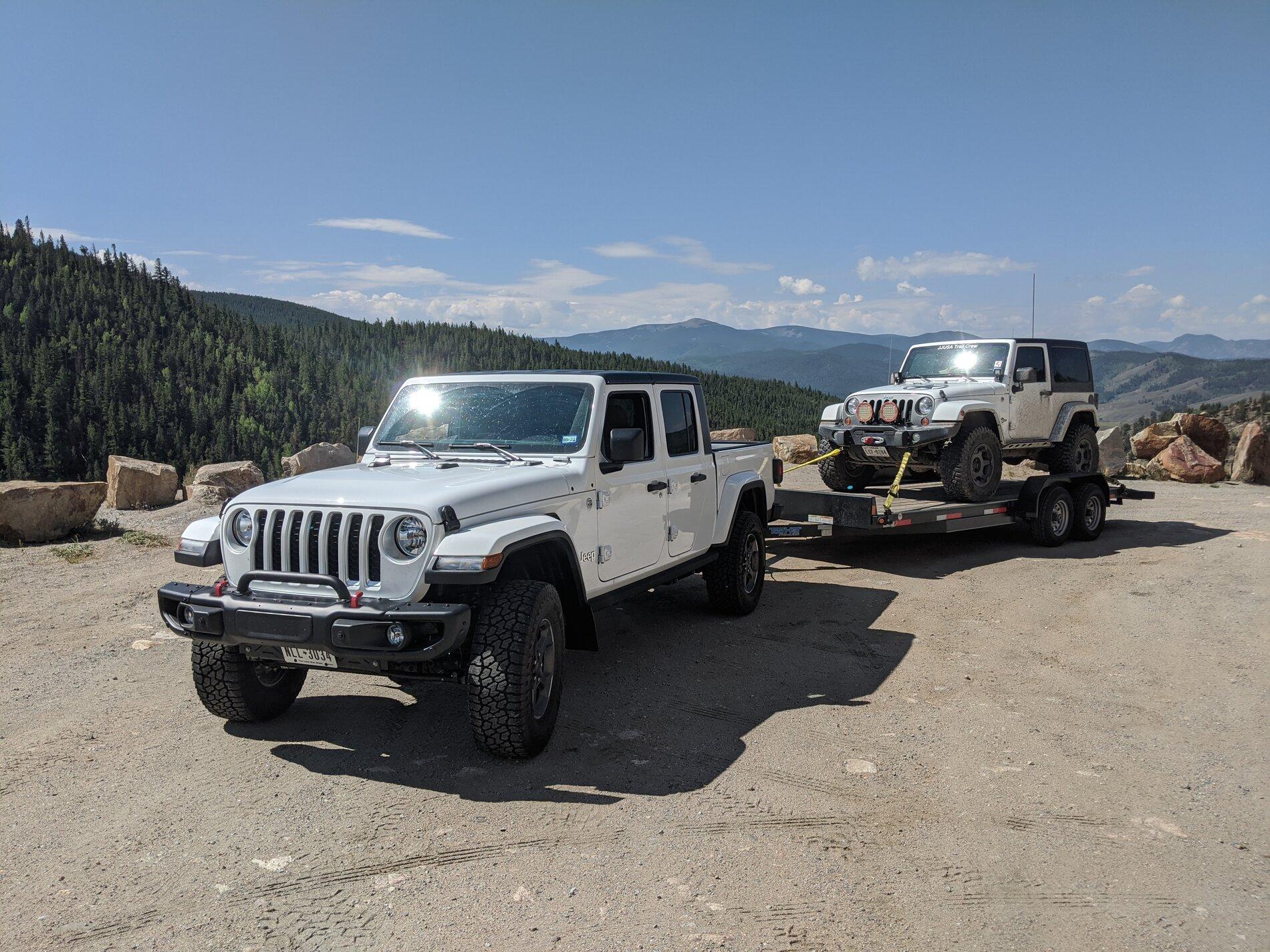

Its all about setup and preparation!!! Towed like a dream for 3500 miles in 10 days. From DFW to the Black Hills in SD to Yellowstone and Back to DFW. Could use a little more power on the big hills!!!
My Set Up:
1) Correct height adjust hitch to make sure trailer is level.
2) Redarc break controller dialed in.
3) Firestone air bags set to 45llbs to keep Gladiator level.
4) 4.10 axle ratio.
5) Correct hitch weight 10% of total, mine was about 650lbs.
6) Brakes on both trailer axles.
7) Sweet spot speed. Around 74 seemed to be the perfect speed.
8) Did not need tow mirrors... Could see fine with car hauler being low....
Smart/wise towing works every time for me!!!!
