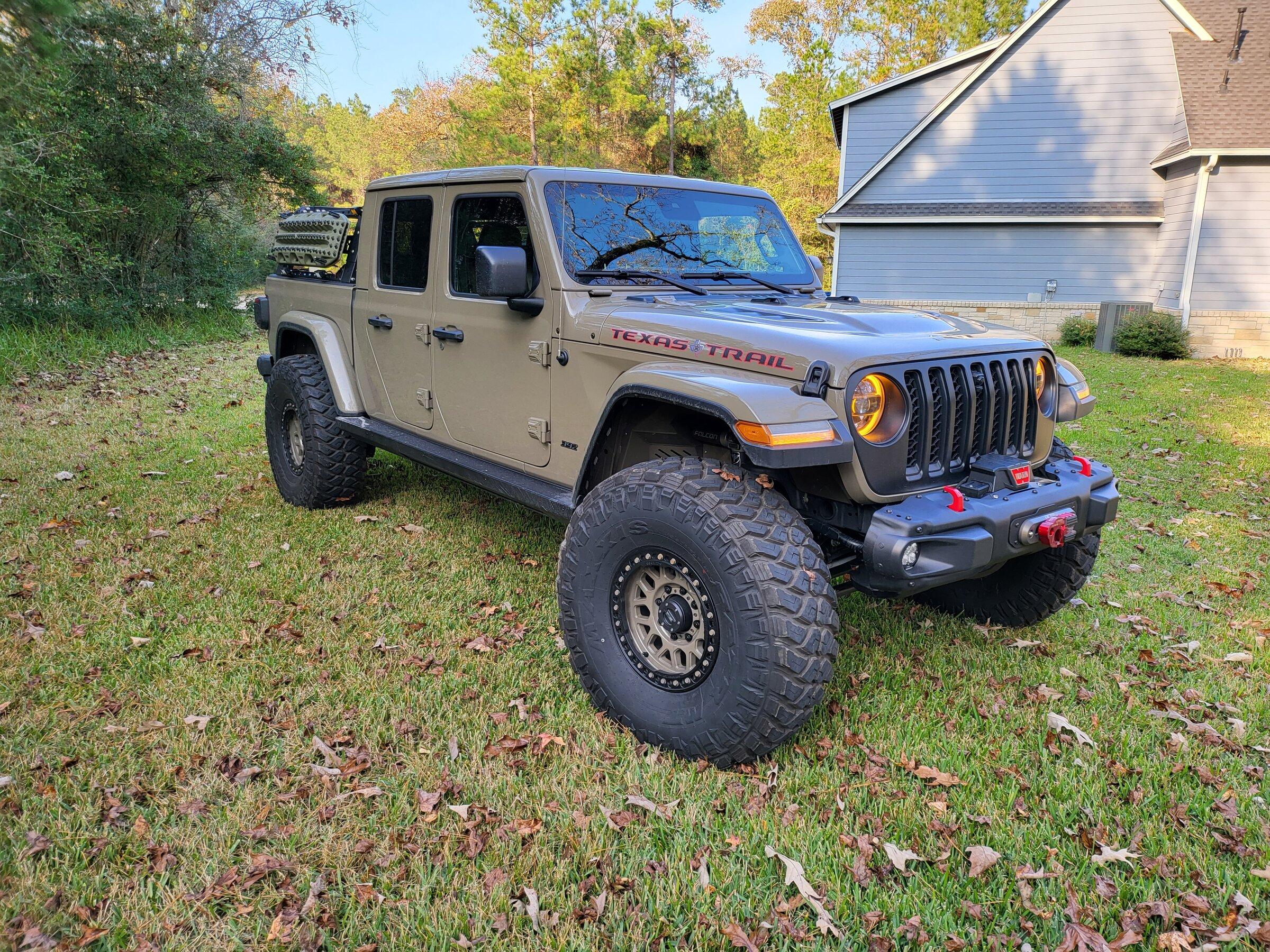

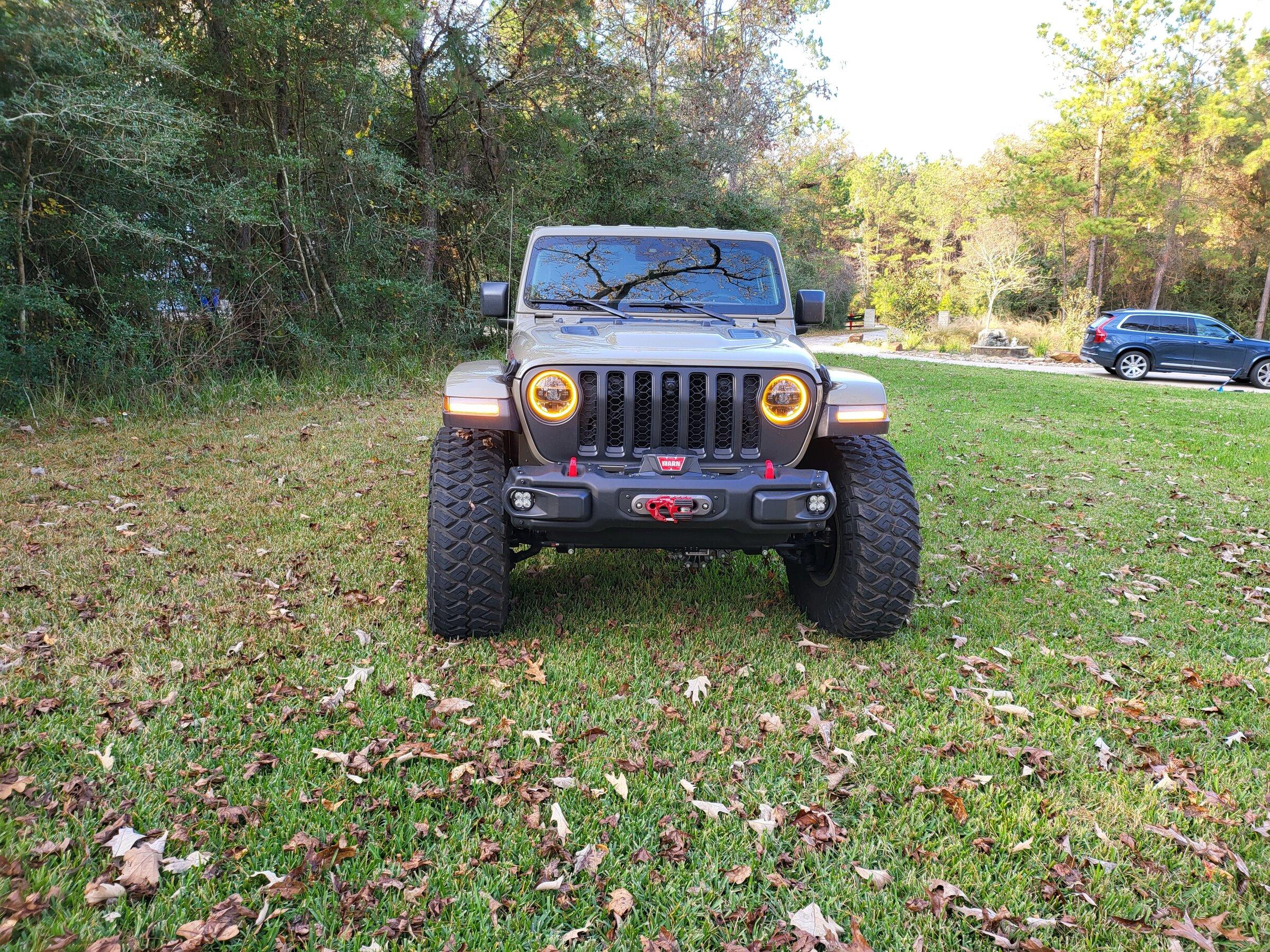

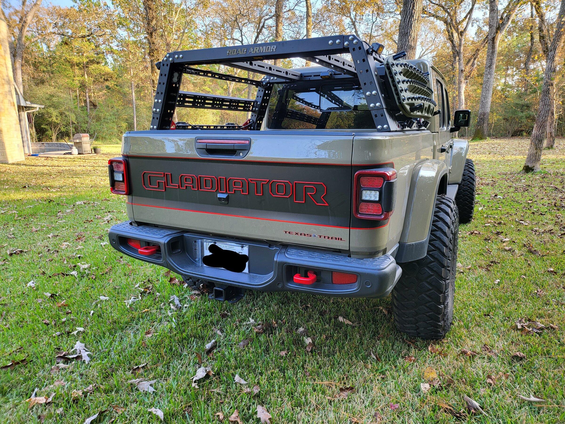

Recently took delivery of my 2020 Gator Gladiator that I had AMW4X4 build for me. If you are planning one of these swaps I can't say enough good things about this company. I've been burned really bad before but the owner Jared is a stand up guy and really set me at ease. My only disappointment was that I couldn't fly up to hang out with the guys and pick it up in person. Call and ask for Ethan this guy works his ass off loves what he does and works with you every step of the way.
