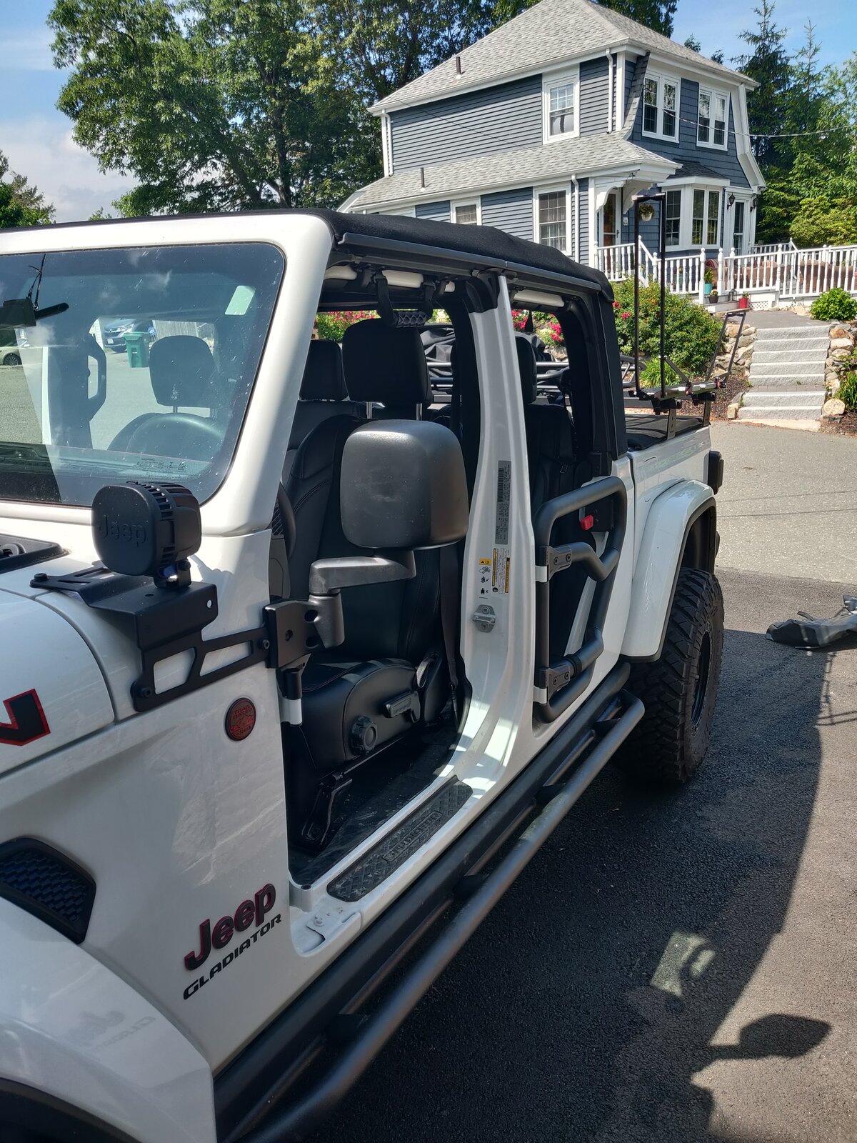

Doors are off!!! figured out my favorite summer setup to be soft top on with quarter panels and rear window and front doors out plus tube doors for the rear. The HEMI really shines with the open air setup and this is really fun for cruising! I just wish someone made a rain cover that works with top on but doors off. Beyond me why this does not exist
Thats how I usually run from spring to fall here. I'm way too Irish to not stay shaded the majority of the time. Will need half doors once second car seat goes in, debating on just getting the Bestop cloth doors though so I can store the uppers to close things up when needed.

RainGear and Bestop cab covers both advertise to work with Soft-top on, about to order the RainGear myself. https://www.raingearcovers.com/product-page/4-door-gladiator-cab-cover , they go in and out of stock pretty regularly
