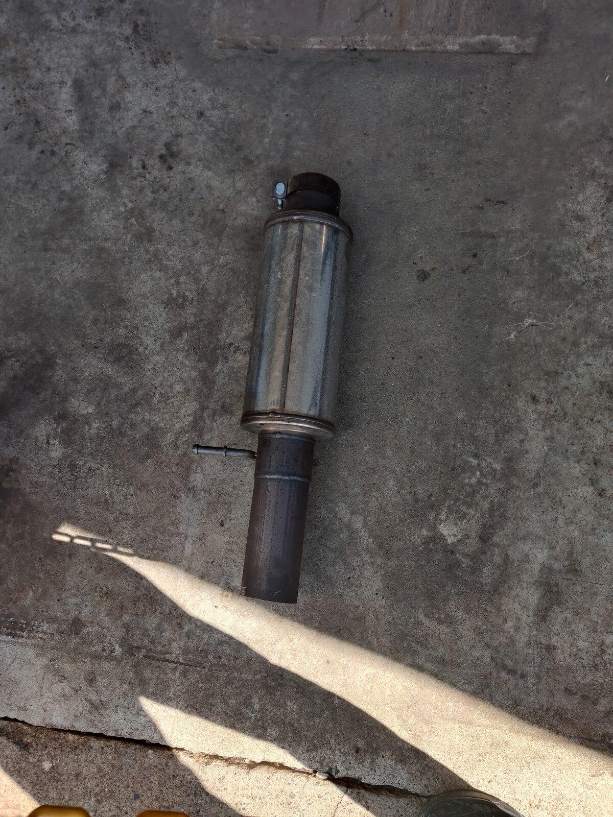

Yeah Rubi recommended the muffler I am getting. And they also offered to cover it if I don't like it. Drone issue usually is a frequency thing where engine and muffler vibrate together I thought and the resonator should take care of it but the guys at ruby say the muffler will do it. Obviously not too psyched to cut into the new exhaust but I need to be able to take work calls so will do it
Jeep Gladiator My 6.4L HEMI Gladiator conversion IMG_20210307_170539_01

so pretty disappointing with the muffler swap. it muted the sound but not the drone. so I have now same level of drone as before which makes sense since it's usually the resonator and not the muffler that filters out drone. sound wise the new muffler takes away many of the deep notes so I can see how it's better for someone who wants a quieter exhaust but I am not a fan.
I am probably the only person on the planet who is disappointed with his HEMI. the drone at highway cruising really gets on my nerves and my kids say they get headaches so I am not using 8th anymore on the highway to stay above 2K RPM. On top of that the sound is now worse with the new muffler. annoying exhaust was the least of my concerns when doing the hemi swap but now I am thinking to just sell the truck

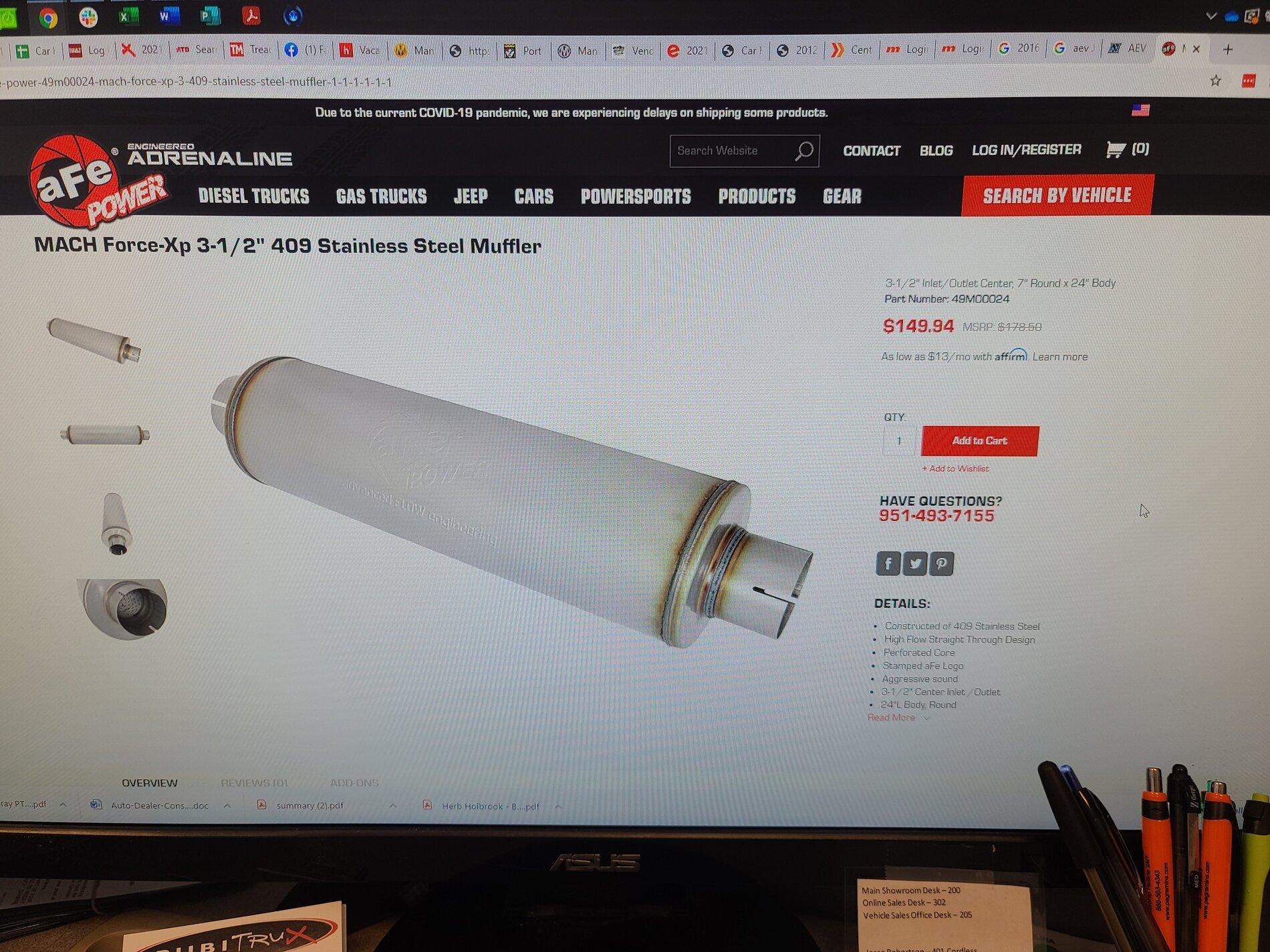

Woa! Well like Instated earlier, I would really consider that BBII 70 flow. Ot really makes some nice mellow notes with lots of flow
I am not sure i could just throw any aftermarket exhaust on?

Slow down there partner. Like DAVECS1 stated, try the muffler he suggested or maybe any of the oval style magnaflow mufflers, maybe one will help with drone.
Right now I can not think of the part number I used but on my 6.0 LS swap I did, I used a 21" (?) magnaflow oval muffler and I had really nice tone with no drone, in fact I used another model design to lessen the noise level down and still had no drone. I will look and see if I can find the part numbers that I used and get back with them.
I am kind of thinking of trying one on mine as it has a bit of drone, not bad but it is there. I am running 2250 rpm's at 75 so not in the same area as you.
