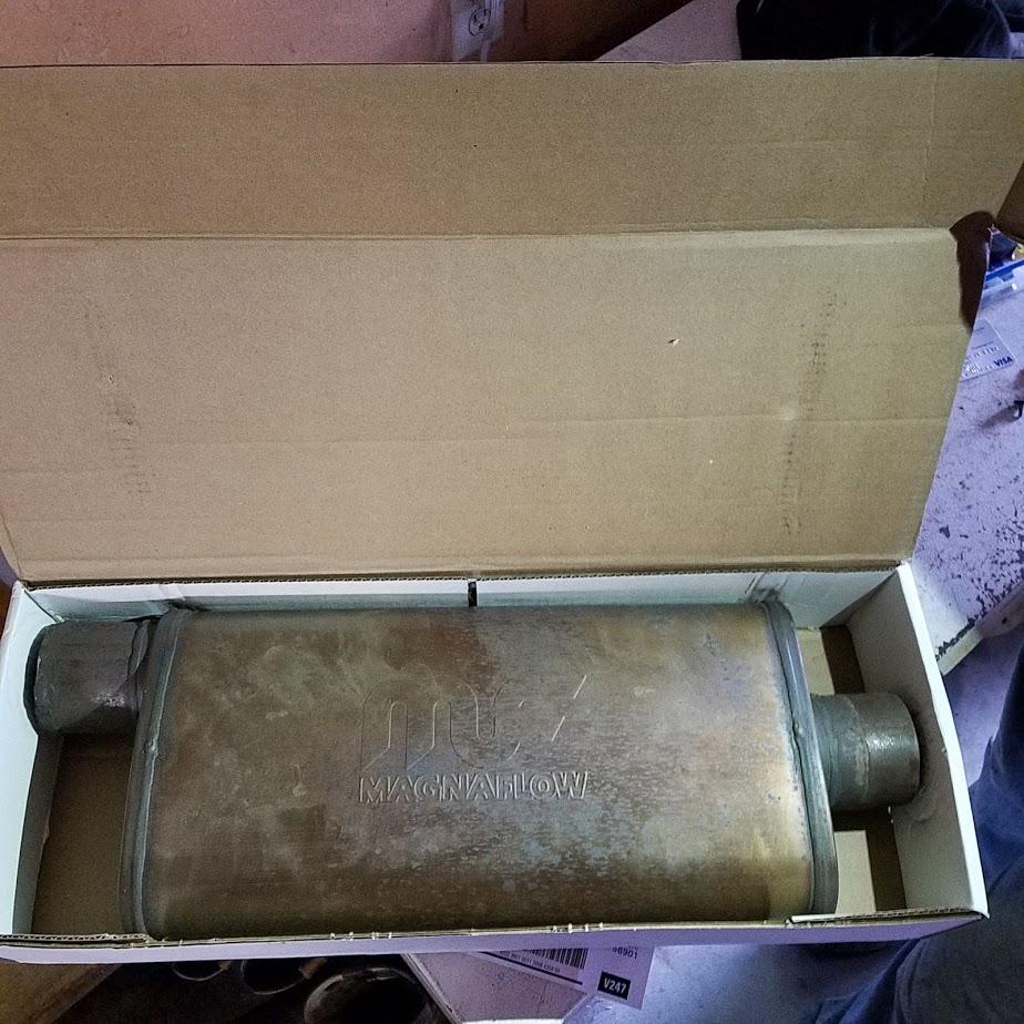

Slow down there partner. Like DAVECS1 stated, try the muffler he suggested or maybe any of the oval style magnaflow mufflers, maybe one will help with drone.
Right now I can not think of the part number I used but on my 6.0 LS swap I did, I used a 21" (?) magnaflow oval muffler and I had really nice tone with no drone, in fact I used another model design to lessen the noise level down and still had no drone. I will look and see if I can find the part numbers that I used and get back with them.
I am kind of thinking of trying one on mine as it has a bit of drone, not bad but it is there. I am running 2250 rpm's at 75 so not in the same area as you.
Yeah I know. I am just super disappointed that the muffler swap made it actually worse for the acoustic experience since it only took away the good stuff and didn't help with the drone. I also texted Jared for ideas.

Oh I understand how frustrating it can be. Sorry can not find part numbers but this is what I had on the JKU with 6.0 LS and I liked it. Thought it was a bit loud so I put one on there that was a bit quieter but then missed it.

Update: stock muffler back in so the truck sounds great again but still have the drone issue at cruising speed but it's so much better than the alternative muffler I had on for a day which was drone without the roar. So happier again ? the guys at Lous Custom Exhaust suggested duals that split after the muffler to get rid of drone. They would fab the pipes and it would be 2x2.5 inch pipes. I'll check with Jared and RubiTrux on their thoughts to see if it's worth a shot. The guys at Lous are pure gold btw

If you cannot wrap your mind around using a Flow master. Corsa Model 80 works well, as well as the Hooker Aero chamber, both work well with 3.5 to 3 inch pipe. A decent tail pipe is critical to. Something longer than 12" (insert size joke here)
