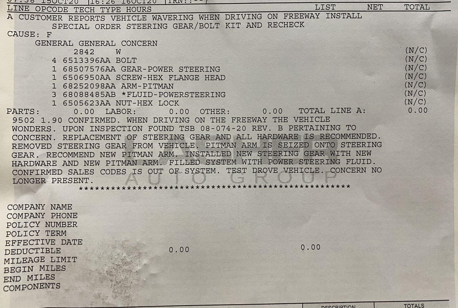

got a message from dealership that they are unable to remove pitman arm to replace steering gear so they ordered a new pitman arm to go with new steering gear. is this familiar with any of you? thanks
Somewhere in the past 100 pages, someone else also had an issue with a pitman arm. Not a big deal. Mostly a surprise that the mechanic can't remove it. Sometimes they take a heavy hand and a good puller.
Hi @Sgt. Pepper,
Please let us know via private message if you would like to work with a Jeep Wave Specialist while your Jeep is in service for this.
These are all new, or nearly new Gladiators, so I can't imagine how a mechanic could possibly damage the pitman arm, unless he used nothing but a hammer to try and remove it. Removing the part isn't difficult or rocket science, it just requires the right tools.
Was the vehicle up in "salt winter" country? What gives here?
